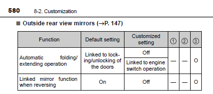

As I understand it, starting in 2018 there was a power folding mirror option that allowed you to choose if you wanted the mirrors to fold in every time you lock the doors. Prior to that, like in my 2016, it was a manual operation (not manual folding, just manually have to hit the switch every time you want them to fold in)
Has anyone retrofitted this function with options like the ones below? I'm not sure if the second one is a retrofit for auto-folding or just a replacement switch that is backlit. The third one occupies the OBD port which seems excessive if there's an easier option
Also in the owner's manual it says that you can have the dealership customize it to work with the remote- anyone done this? The o in the #3 column says that the dealership can program it

If the dealer can program it, a fully functioning techstream setup should be able to as well. Might be worth seeing if anyone in your area is willing to do a little digging with their system, or invest in one.
