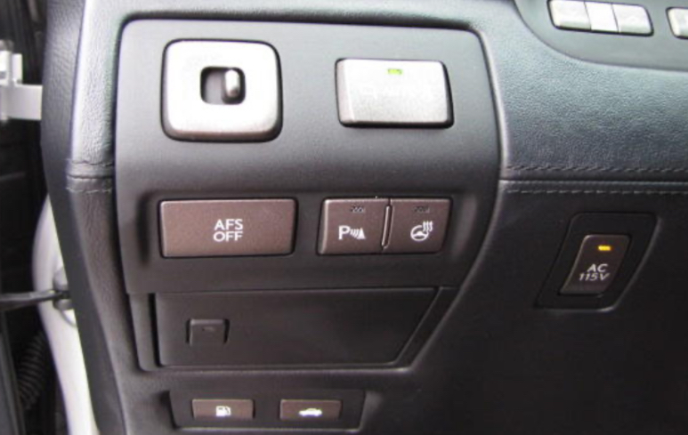

One other thing I'm curious about is the switch bank where the heated switch is located is one piece (i.e. each switch is not separate) with one wiring plug coming in. I'm not sure you'll be able to get the clock spring, switch bank, and wheel installed and have it all "just work". And if it did, what would happen to the 120v power switch?

Agreed, a better option might be to find another blank switch area and use an oem looking switch, there are many custom options out there for lights, etc. Some trucks don’t have the 115v switch so they might be able to adapt the factory switch. Alternately if you find the switch below (not a lx570) you could relocate the ac 115v button and rep in the harness to use the 13-15 multi-switch with the steering wheel heater button. Finally, if you don’t use the 115v outlet, I’d consider taking the hit and dropping it (resin the harness) for the steering wheel heater. If someone has a 13-15, where is your ac 120v button located?

13+ doesn't have a switch to shut off the inverter, it's on all the time with the ignition.
That’s even better then, I’d assume those wires for the outlet could be spliced to “ignition on” and the harness for the heated wheel could be re-pinned do the factory connector to use the 13-15 multi-switch.
