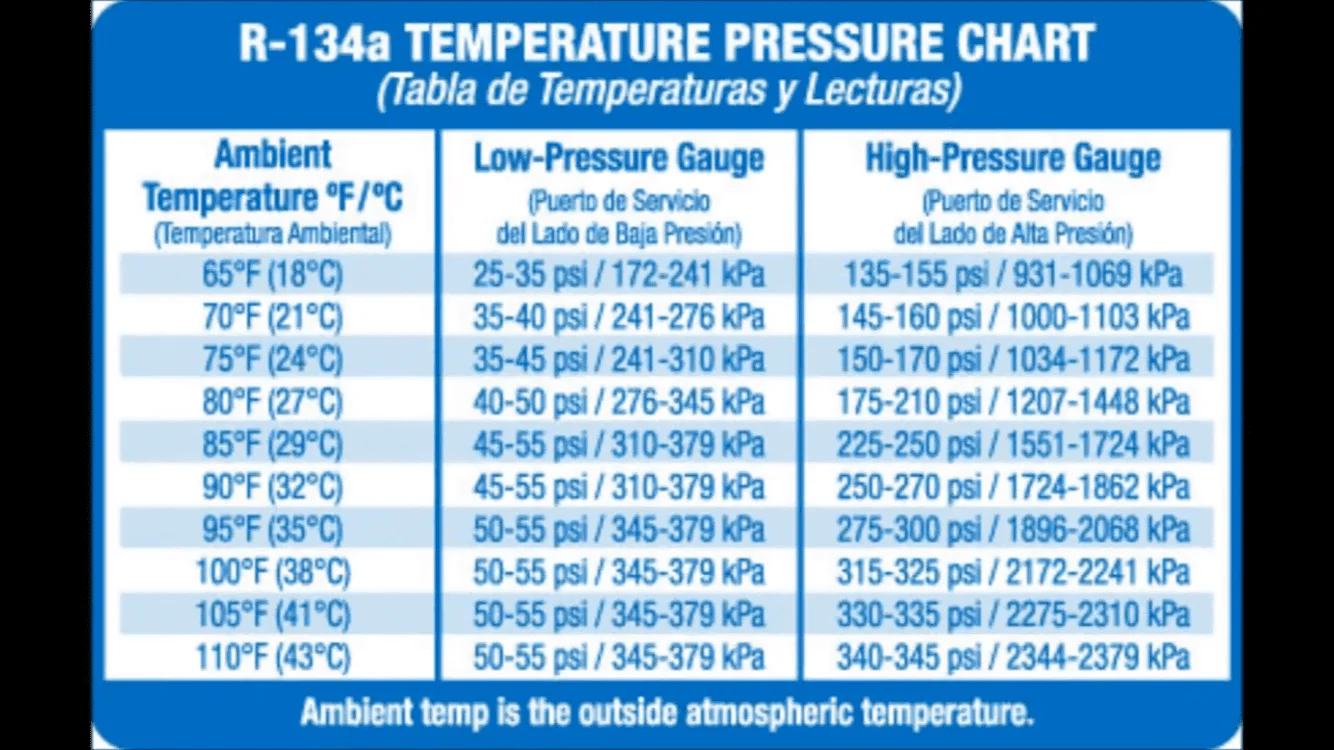

Yes, my charge was on the light side but I stopped adding refrigerant because my high pressure side was at 230-240 and I didn’t want to push it. I’ve used this chart.
I’m not familiar with discharging into high side first or what the purpose of that is. I do not have temp gauge but I can lick my finger
Pressure/Temperature charts (interrelated) are useful when topping off a charge or for the purposes of fine tuning (optimizing) vent temps and troubleshooting. But anytime you are starting from an complete evacuation...ALWAYS figure on going by 'weight' and watch your gauges only for signs of over-pressure (indicating a restriction/other).
We know the system is designed to take between 28-31.5 ozs of refrigerant. So unless pressures (for ambient temp) get way outside of the normal 'window', plan on putting in the entire weighted amount.
