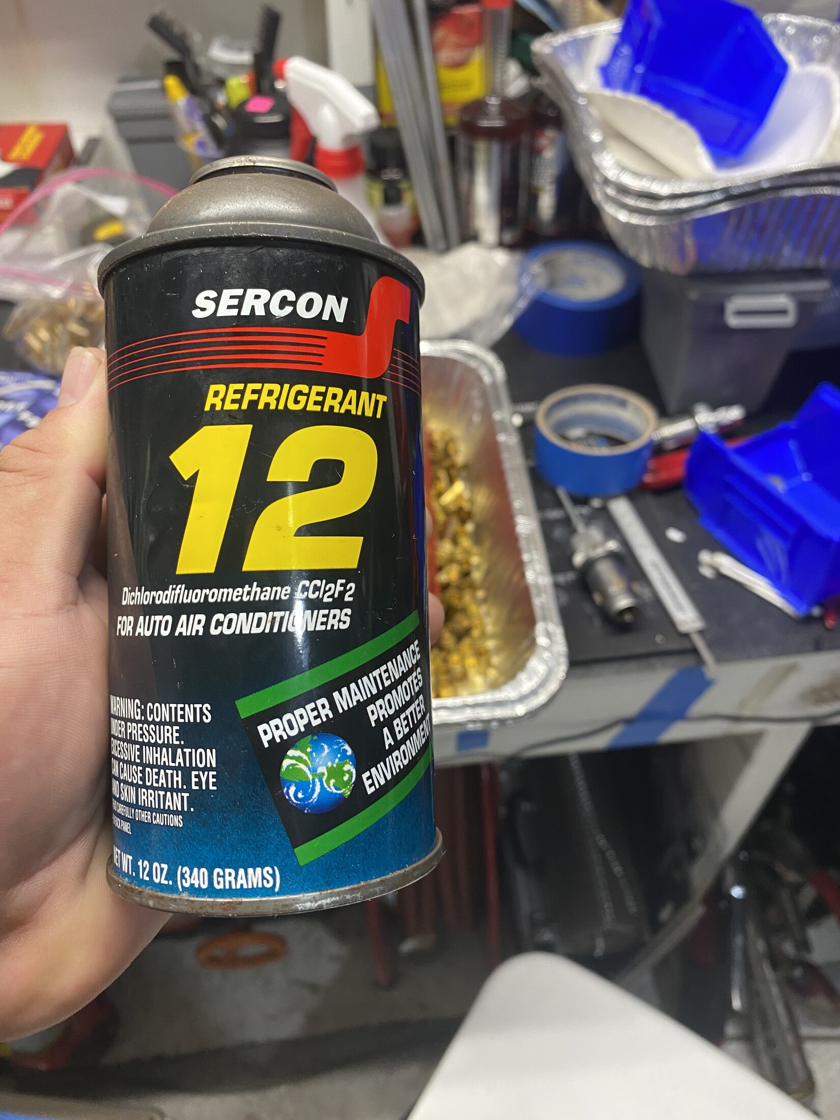

R12 is not hard to find. I still have bottles.
