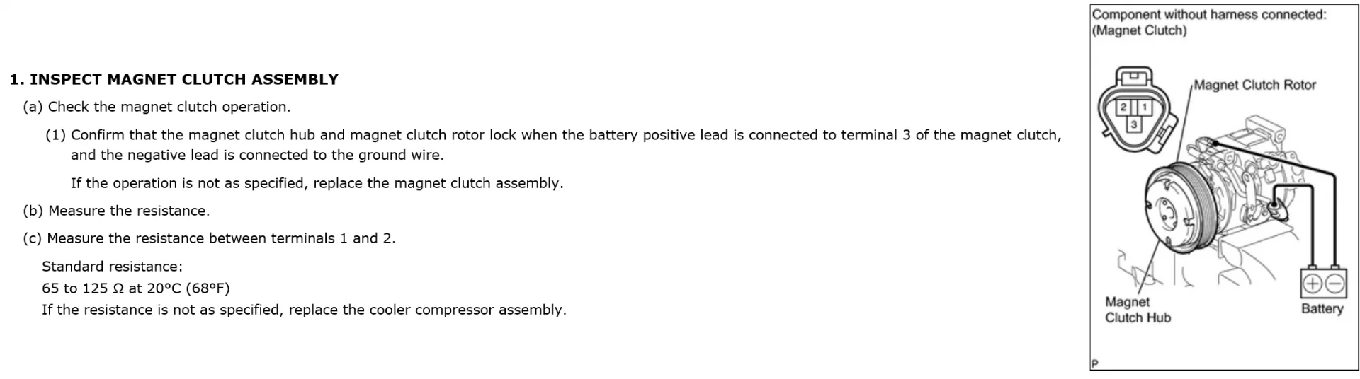

When I removed the AC compressor pulley, I paid attention to the spacer washer that I knew was in there (there were two in my case) and I know I put them back with the same washers in place. I have done the FSM trouble shooting of testing the clutch by jumpering power to it and it clicks and I can't move the clutch with my hand so it seems to be engaging and I also checked the resistance between the terminals as it says. SO it seems to be working.

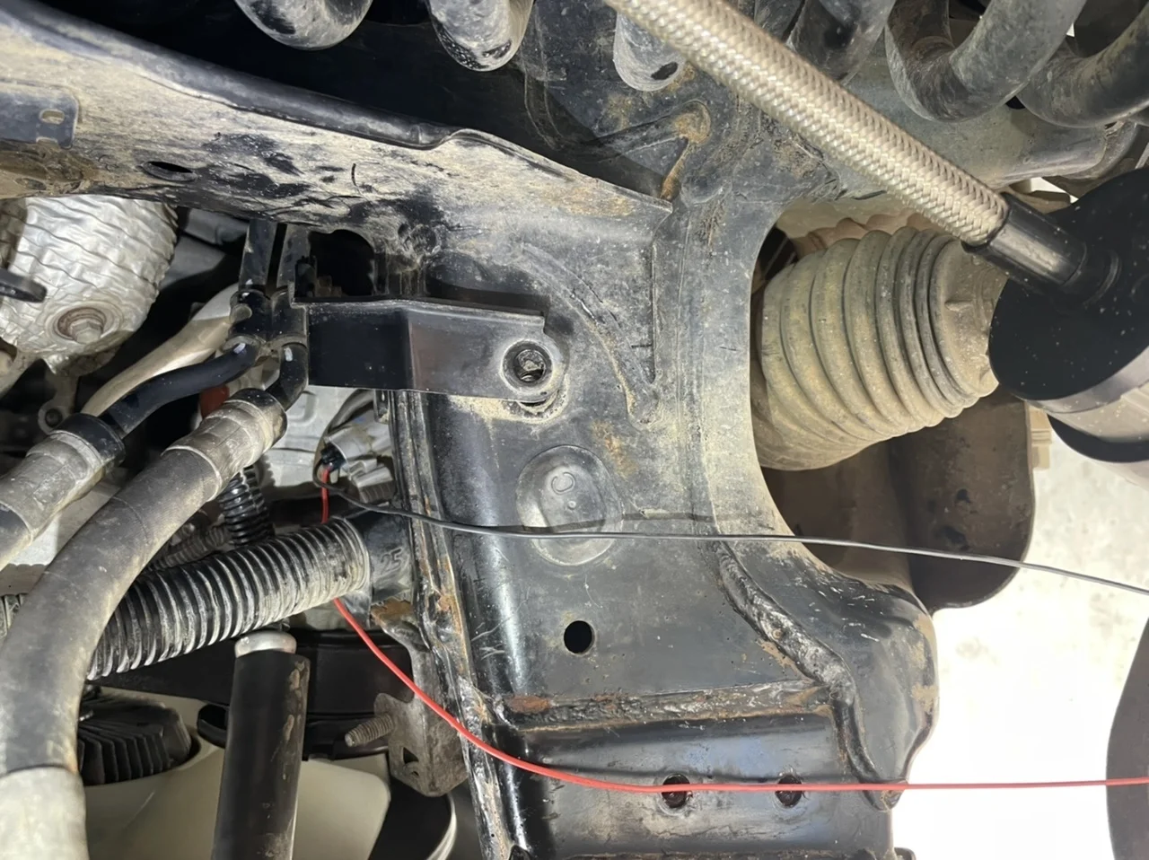

Pic of my jumper wires that I ran to multimeter. Its too hard to get the meter leads on the correct plug pins as you can't see what you are doing from the side and while you can see from the top, you cant reach. (Sorry its sideways)
