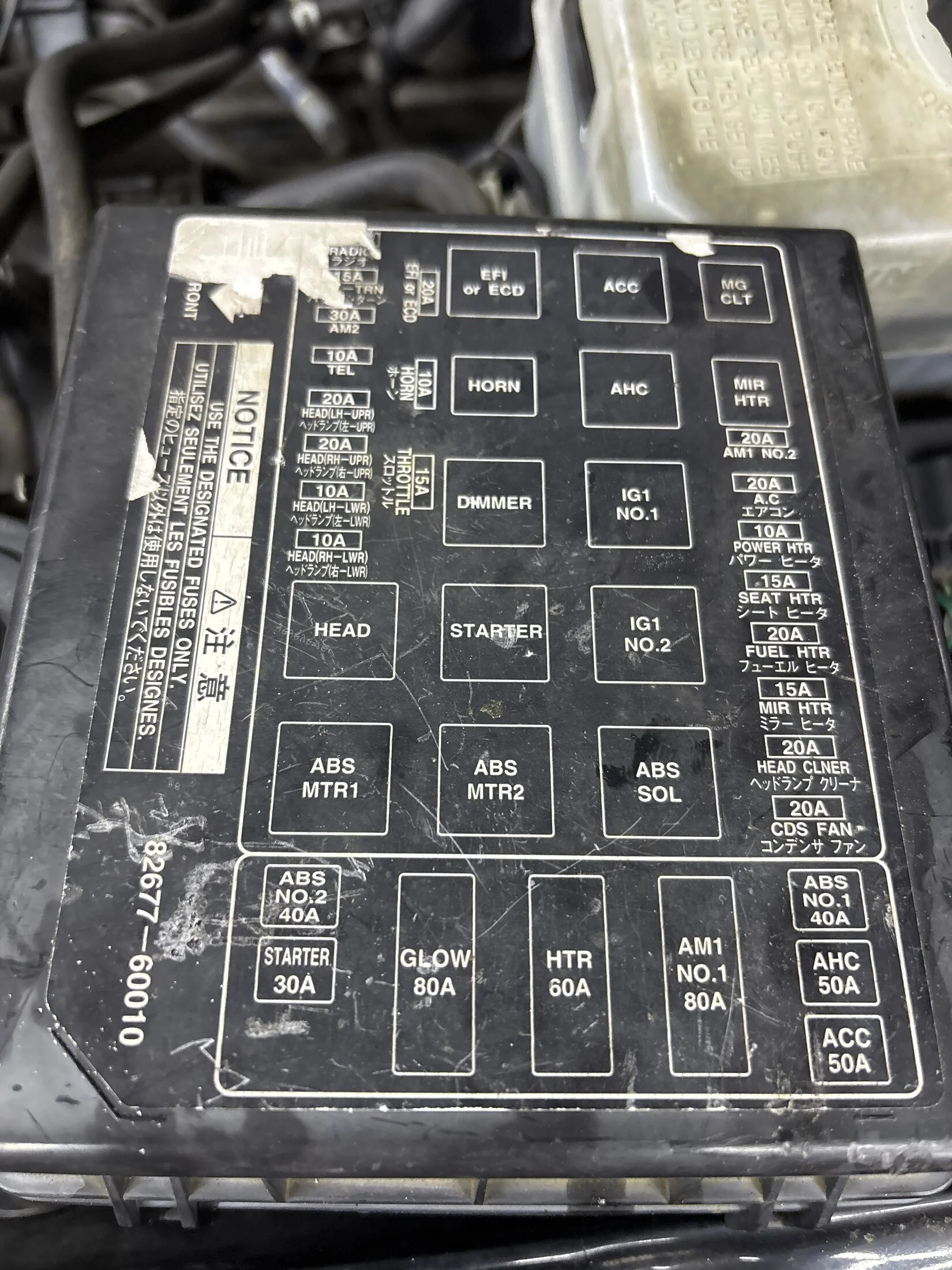

Since the car has 360k miles I'm willing to throw some cheap parts at the problem like a AC relay. Which one is the AC relay?

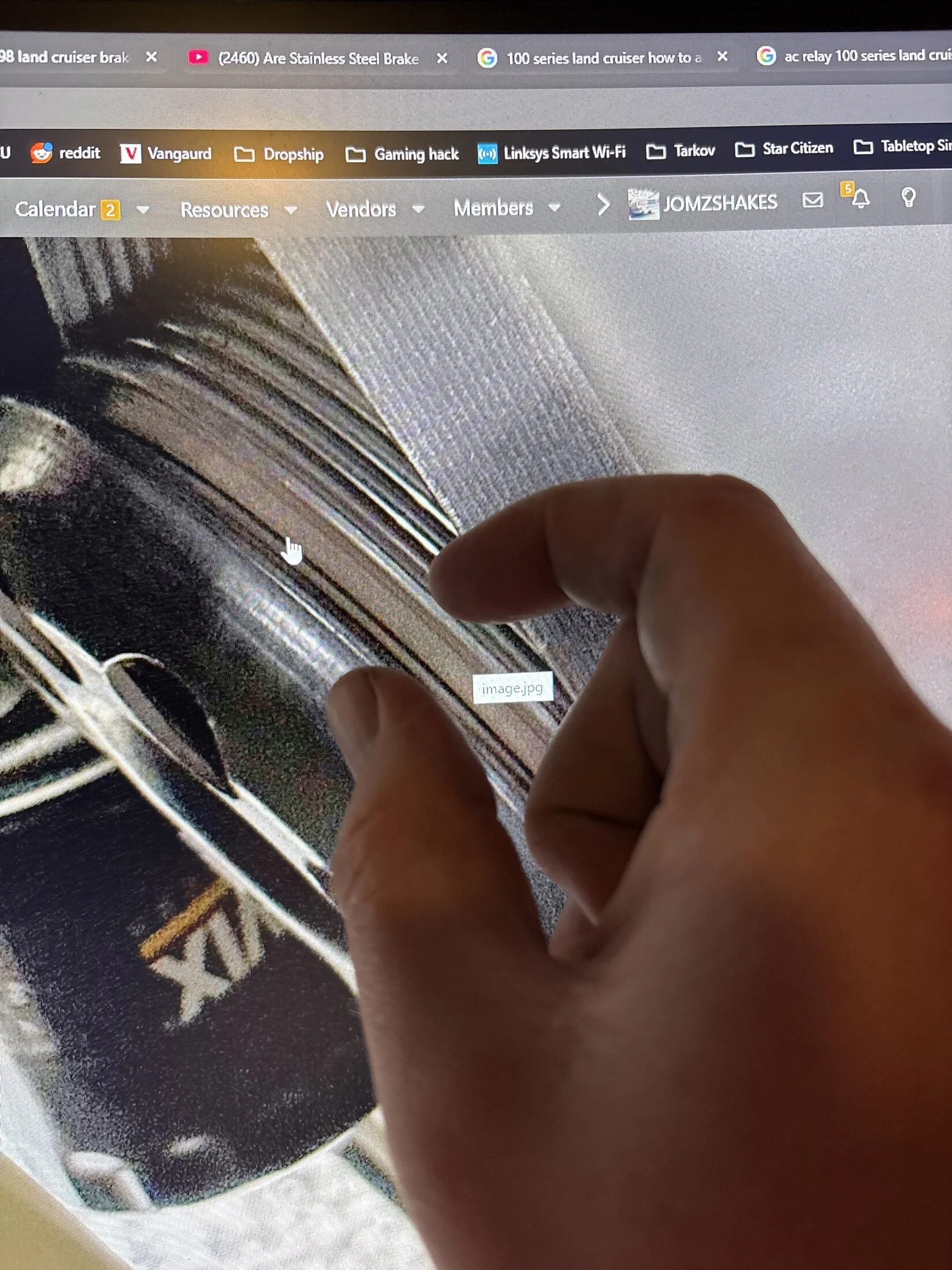

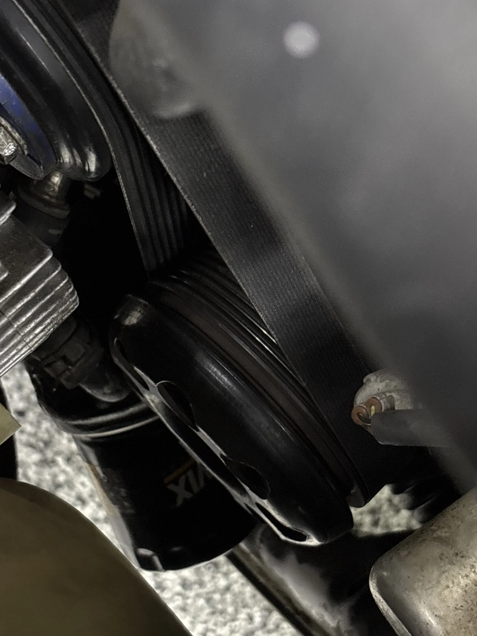

I've read some stuff on AC clutch gap, my clutch gap is .269 inches. It shows online it's supposed to be .014-.026 inches. mine does kinda look like it's poking out and I did just have all the belts off.
How do I tighten it?
Also I measured from the pulley to the "bell cap?" Not sure what to call the most outside mart I think it's a clutch cover. Is that what I need to measure?
You said it gets cold, did you measure how cold it gets? 30-40 PSI is that static or dynamic pressures? You can swap the relay if you like just to eliminate that issue and clutch gap is not an issue at all the magnet will pull it even when it's out of specs. Did you try adding from freon?

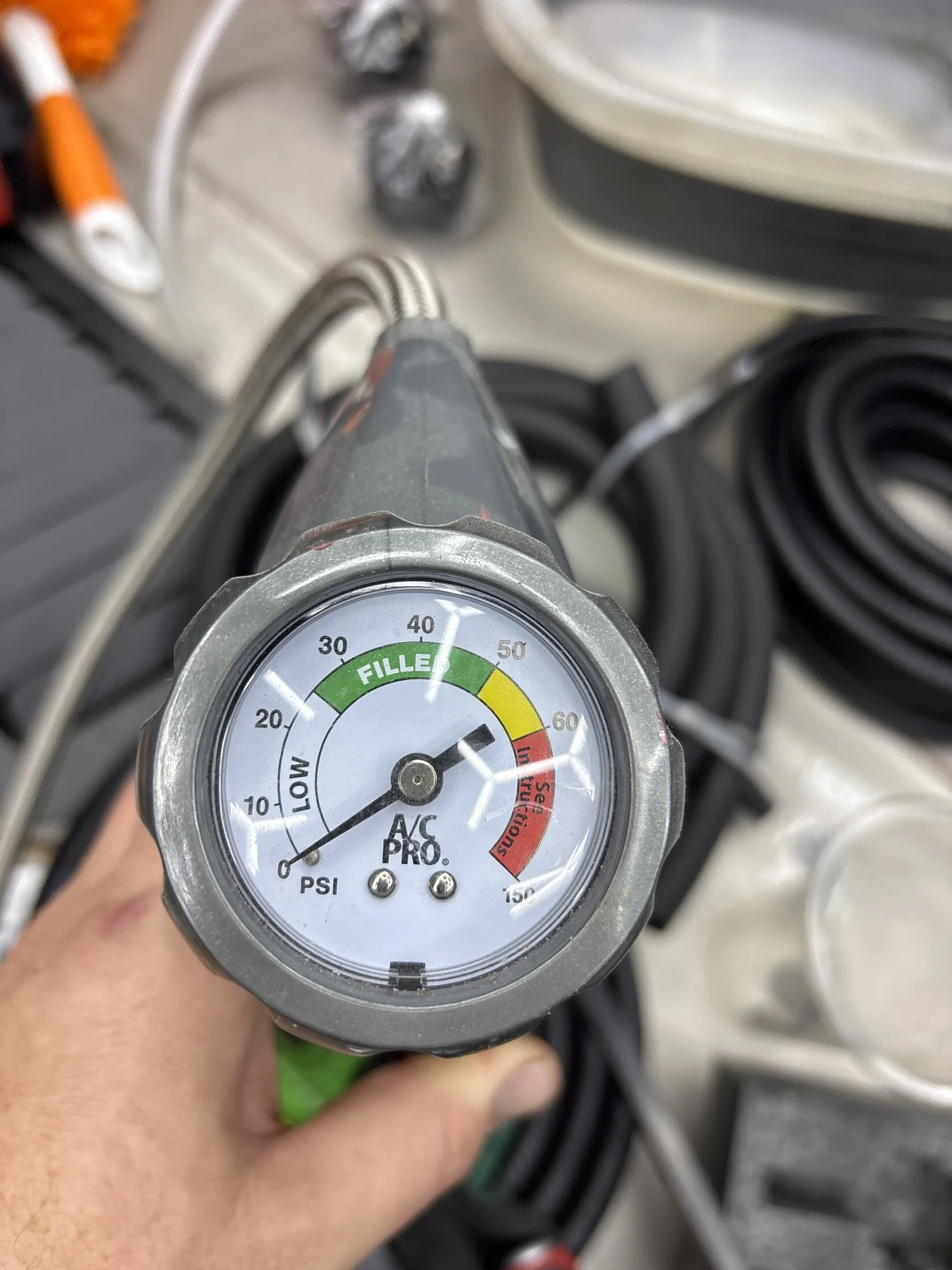

Sounds like your system is short cycling due to a low charge (likely caused by a leak). Your low side should never get below 40 psi, because at approximately 38psi, the low pressure safety cutoff switch will turn on and releases the clutch until the pressure rises above set pressure. This cycle will continue until the system has enough charge to keep the low side above ~40psi. Add a can of 134a and you will see the cycling stop. Then you can start searching for the leak.
Added refrigerant, almost instantly it went from 40 to halfway in the red.
Then it made a crazy buzzing noise twice, 15 seconds apart, and I turned the AC off and it stopped. I'm kinda scared now
That is odd, is it possible for you to video while it's happening? I cannot trust those gauges that come with the can better invest in a gauge set. My hunch is you may have blockage in the system or a bad expansion valve that is just a guess for now since we don't know what your high side is reading when all of this is happening.
I just put the can hose end onto low pressure "near firewall", and after hitting the trigger for like 2-3 seconds it went into the red
I can hear the valve engaging and opening when I put it on, I released some pressure and it's still in the red, it seemed like a lot of pressure
