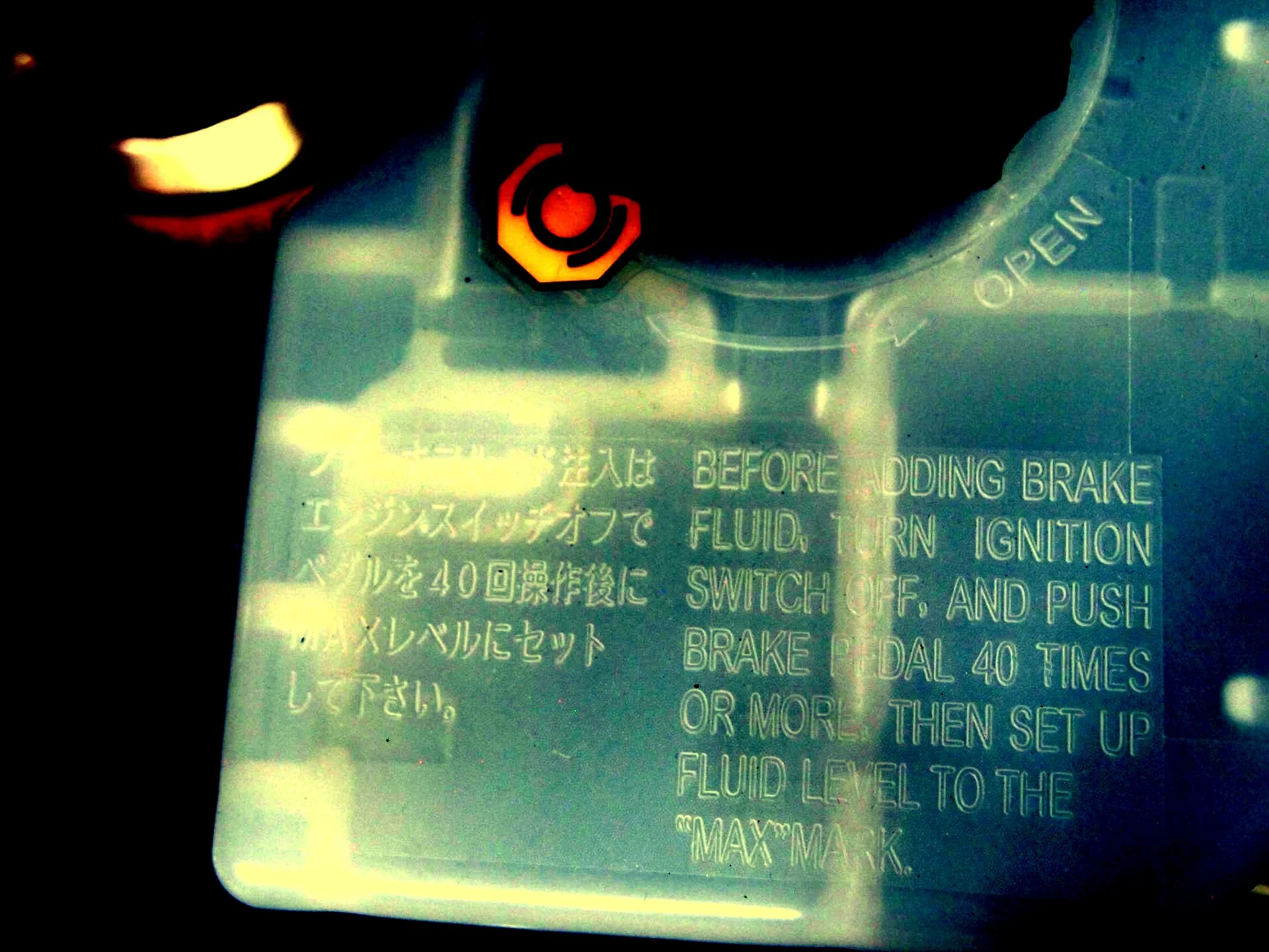

Check to see, that brake fluid level is correctly topped. To often they're overfilled.
On all 100 series brake reservoir, it gives topping instruction.
this x 100
Every time I have taken my 100 series to a mechanic (even a reputable Toyota tech) they mess this up. Annoying.
