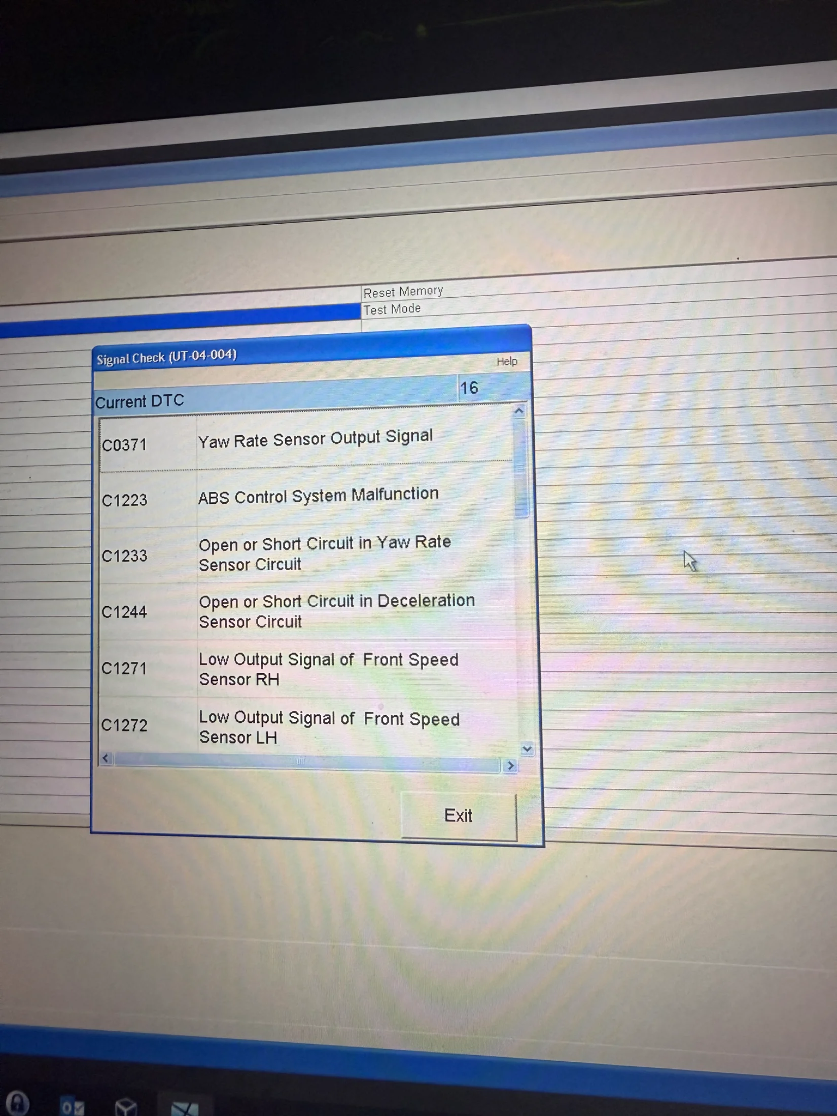

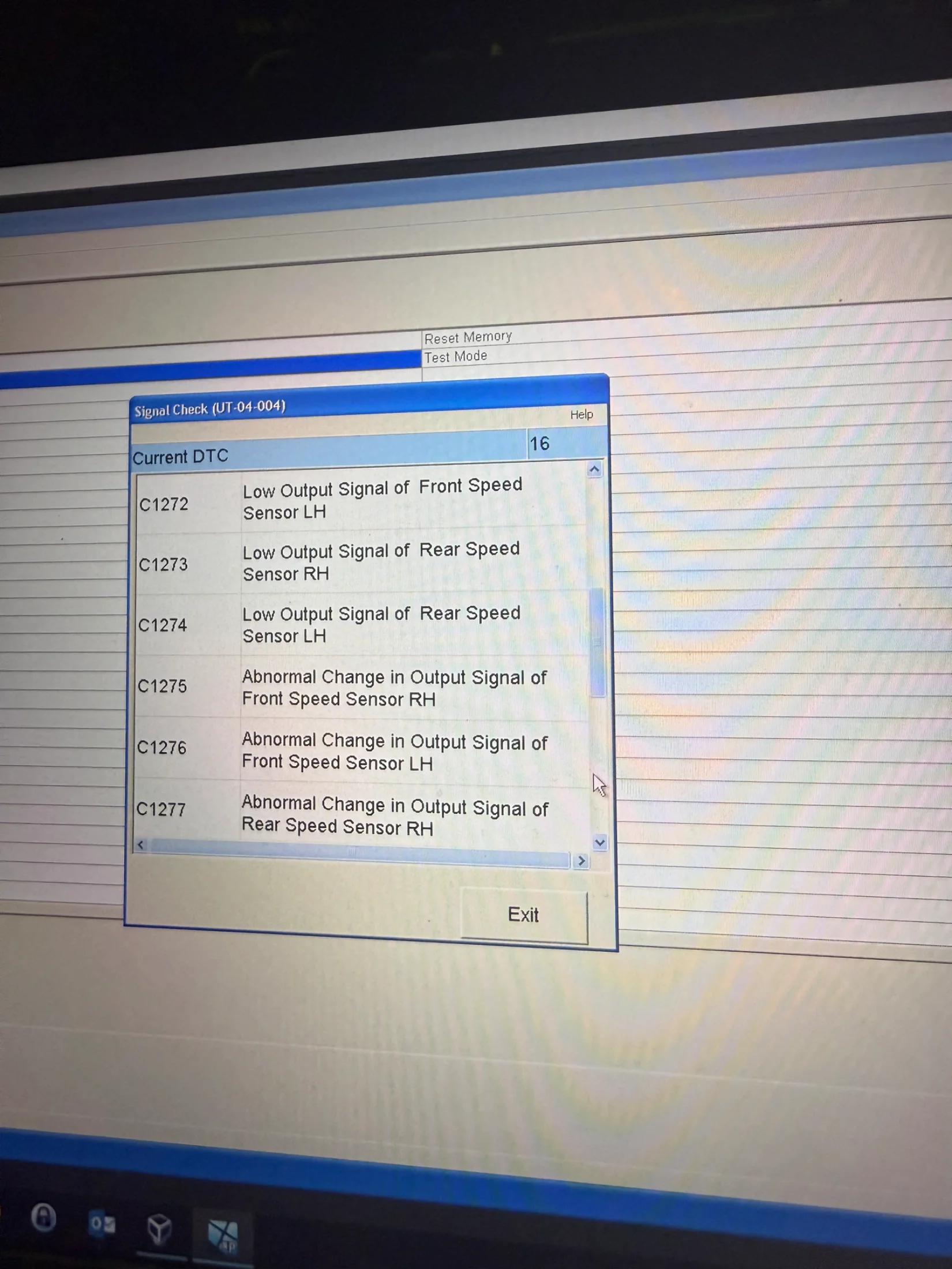

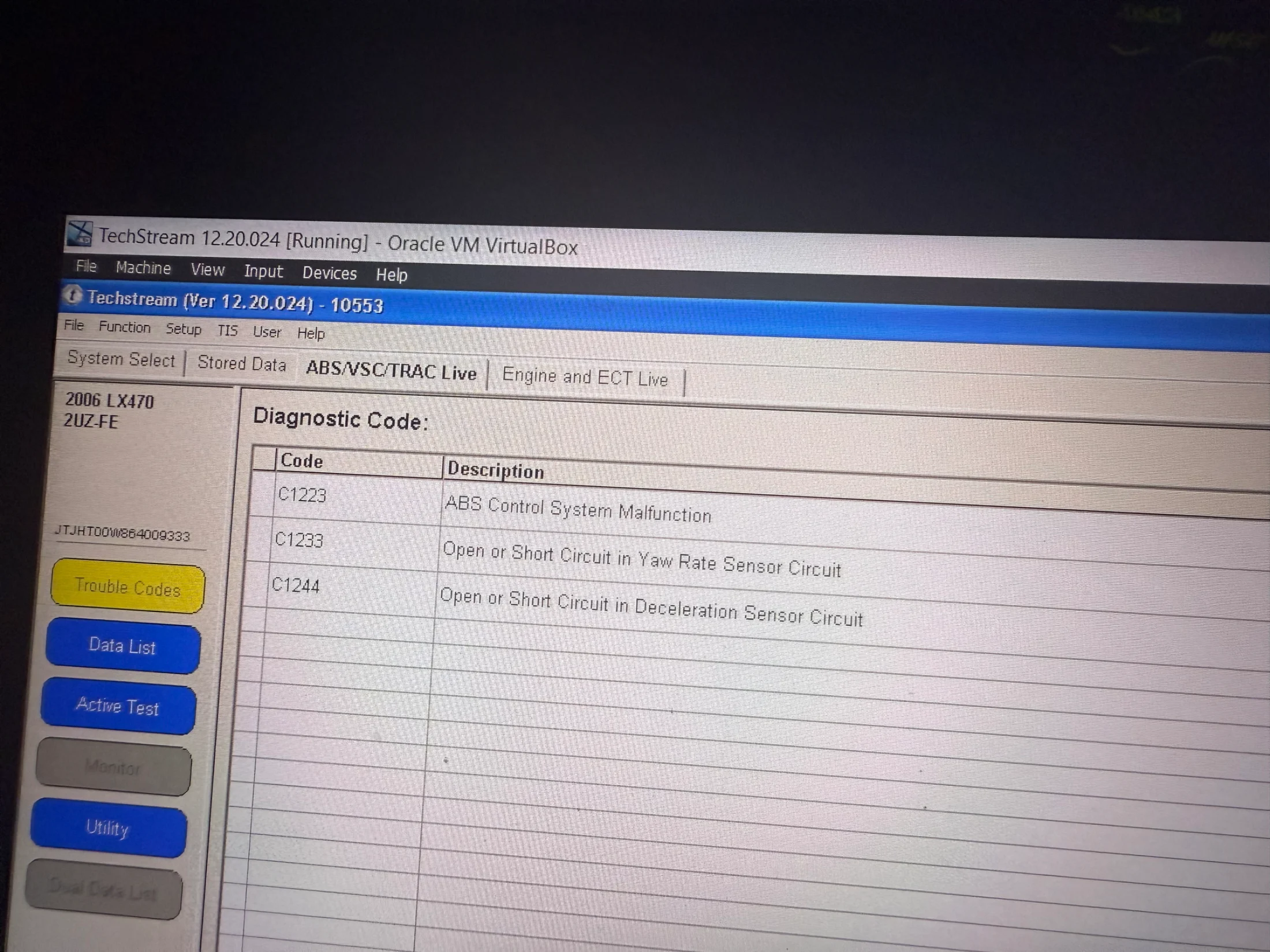

My 2006 LX470 is throwing lights. The VSC lights I can live with, it’s mainly the ABS light. I ran tech stream and it gave me the following reports. Should I start with the speed sensors or is it a deeper issue with what the report is telling me?
Thanks!
