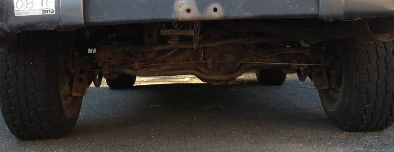

I live in the Northeast and work at a place that does abrasive blasting and painting so ive been talking to the guys about having my rear axle cleaned and painted. I plan on simply rolling my truck in, jacking it up, and having them do what they call "sweep blasting" which is going to knock off loose debris and clean me up. I don't want a white metal finish which will probably do more harm than good but rather to get a cleaned up axle for epoxy coating. Rust is slowly eating my LC away so something has to happen.
Anyways... looking under the truck I notice the break lines, ABS, the E-break lines which should be protected but is there anything else that I should be worried about? Has anyone had this done before?
Wondering if its a good idea or not... Pros? Cons?

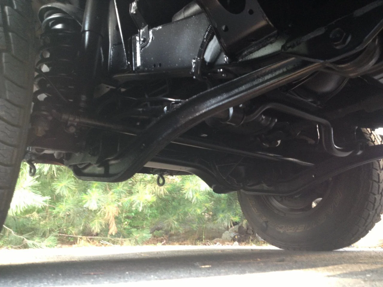

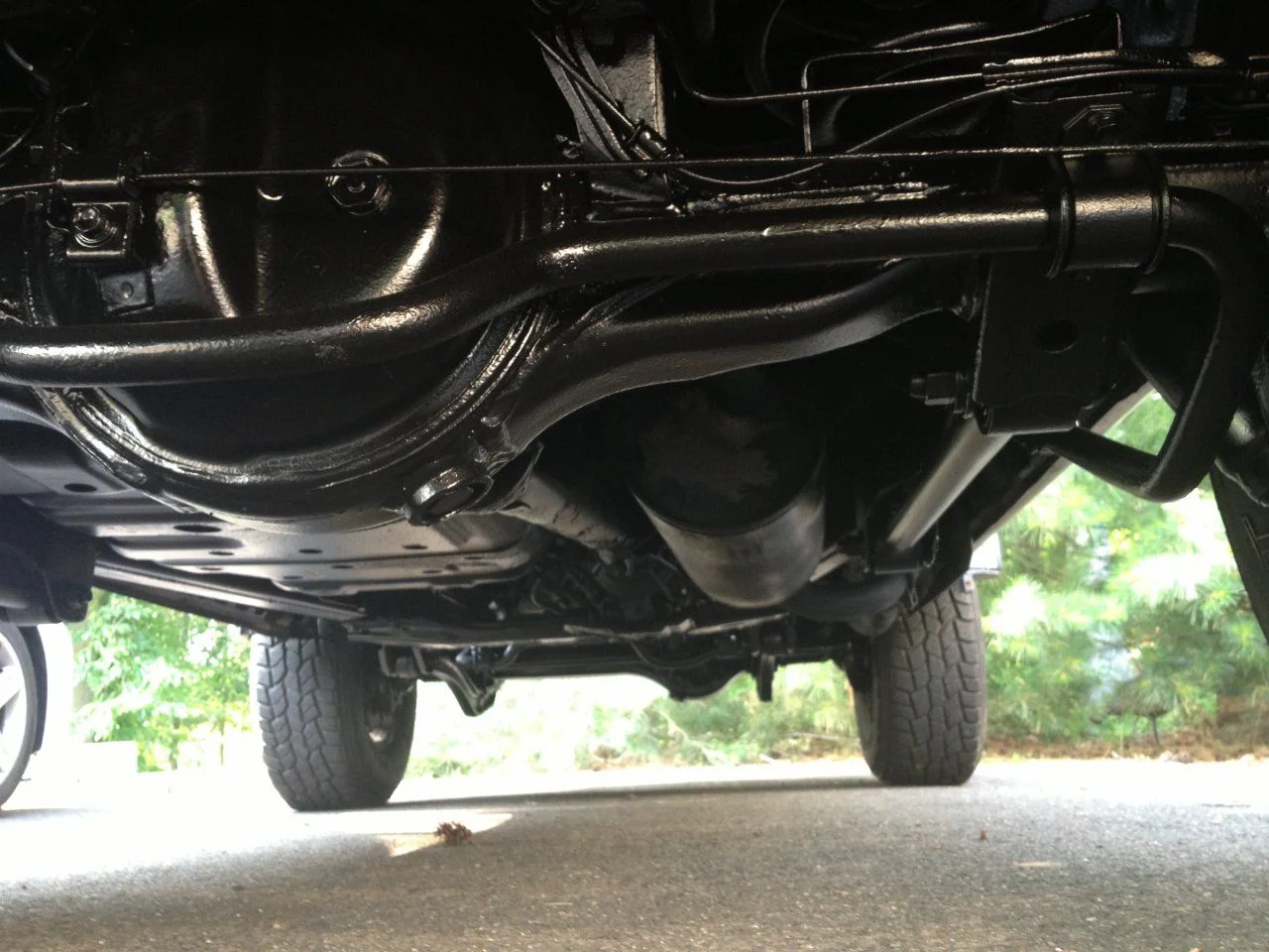

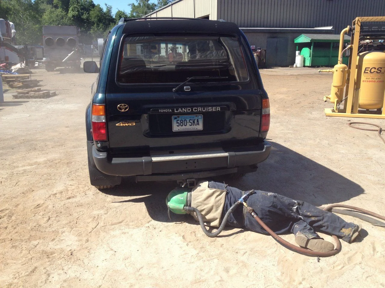

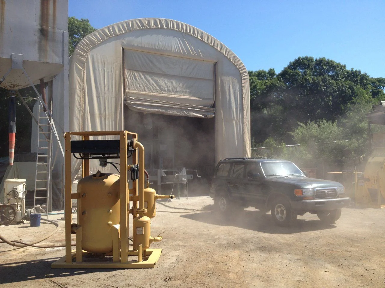

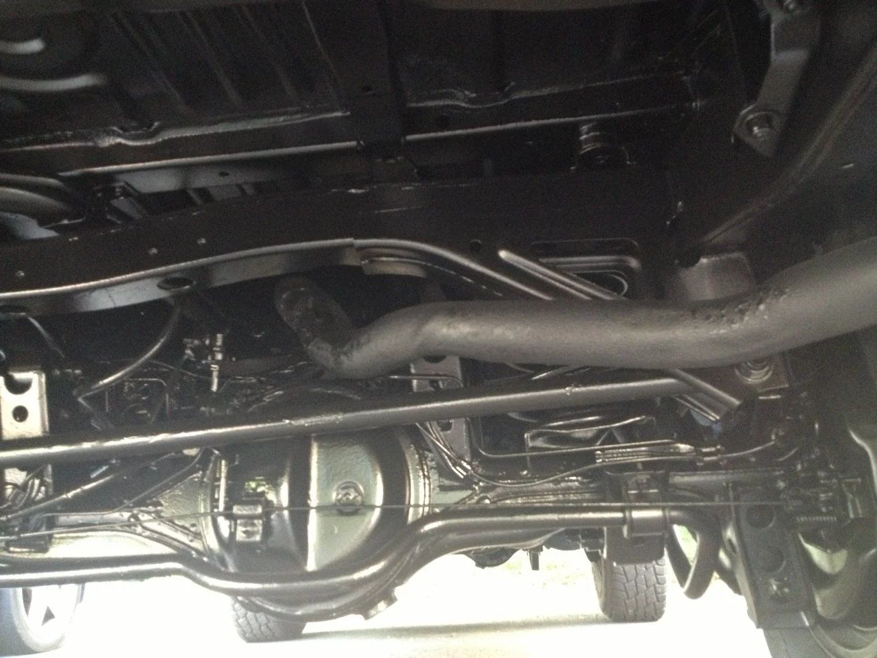

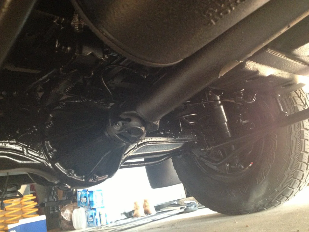

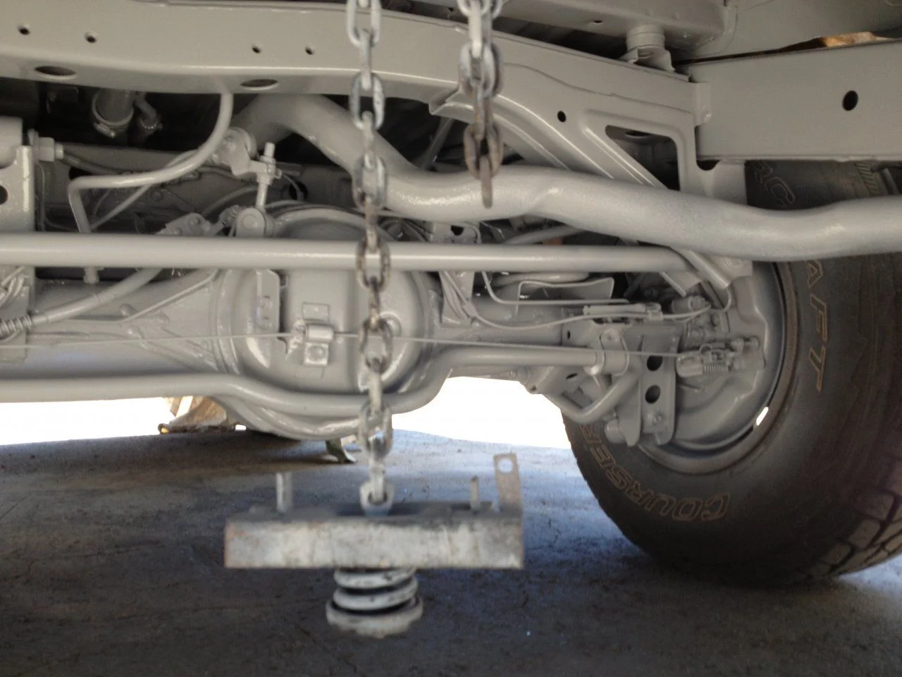

Yes and yes went well. I asked for just the rear axle and got the entire underside done. The guy said that it would have looked funny with just the back hf looking newly painted and the front not so he just went for it. Im not complaining :bounce: he spent like hf an hr blasting the underside and then dusted everything off with compressed air. Next he sprayed some Carboline epoxy primer all over. We let it cure over night and top coated the next afternoon. I let it cure for the rest of the day and drove home last night. I was super happy with the result up until I realized my entire exhaust was painted too :meh: but not much I could do other than to just drive and hope it all burns off. Judging by the smoke trail down the highway looked like it was, still smokes a bit when I drove today but its subsiding and flaking off.
Over all I think I got just what I was looking for which is many more years of rust protection! Enough rambling check out the pics!

Looking good. Some more details on the dusting..Did he tape up the rubber hoses and the brake lines to protect them or was he just careful in the blasting not to hit those?
