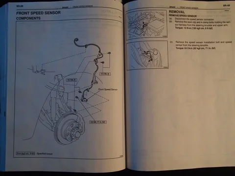

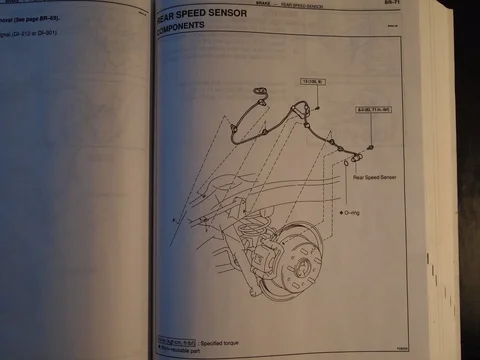

If tire pressure is good then I'd suspect a wheel speed sensor
Thanks for the responses. The tire pressure is good (29 front and 32 rear). I am unfamiliar with wheel speed sensors. Where are they and how they inspected/replaced?
