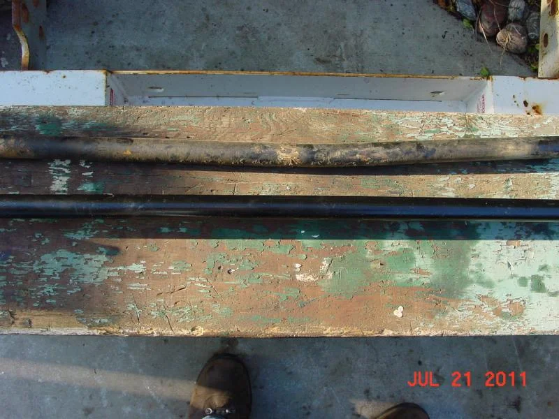

Drove with a bent tie rod for years but I also reinforced it. If u can get it pretty straight its good temporarily but I wouldn't go through the sluce or really hammer on it either.

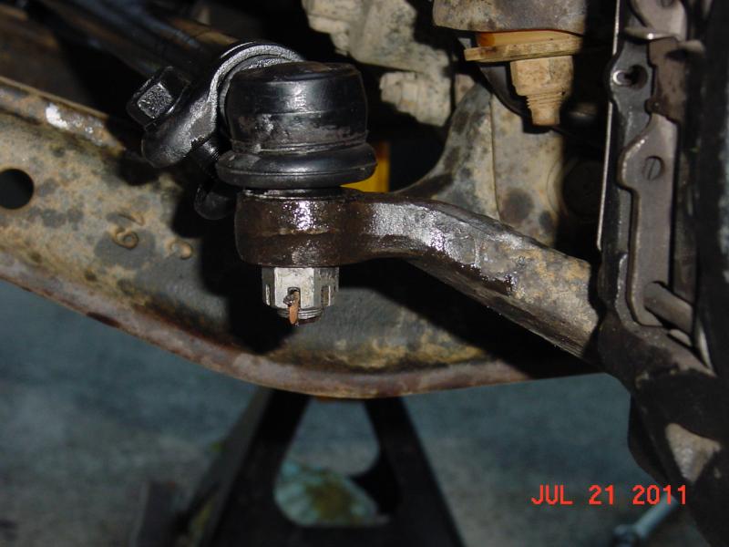

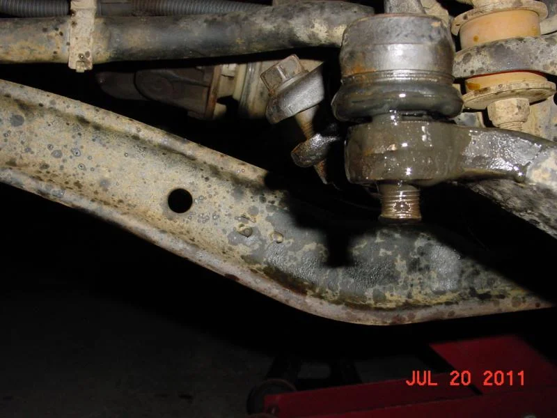

Speaking of tie rods I jacked up my rig and found the clunk I was hearing. On the passenger side there is "play" in one of the joints in the steering joints.With one wheel off the ground I get about 1/8 inch play on the one joint. Not sure what to do about that. ?? :meh: How hard is it to change that out if needed?
OK, first chapter in the steering section done. I can now say it's the connection between the "relay rod" and the "tie rod". Some help would be nice, I'm out of time and $$. Would Napa have that part?

I'm going to beat those tie rod ends out of those arms if it's the last...:bang: or the pickle fork method and try to get an alignment Monday then I should be good to go.
:cool:
p.s. decided to 'go' for it tonight(weds). Didn't work out. I pounded one TR stud to a slight mushroom head and it didn't release. Tried the other side and pooped out before it mushroomed but it didn't budge either. I pounded the tar out of those buggers with a 3 pounder. I even lifted the front jack stands higher than I normally would just for the extra swing.
Bought a Tie Rod End Puller from HF but it didn't fit. Too big. Guess the OCT style tool might work better.

Try this: Put axle on jack stand, pull tire off (obviously) then use your Toyota bottle jack to jack up under the TRE so there is some tension, then pound down on the arm, or jack up under the arm and then pound down on the TRE, depending on if it comes in top or bottom... That usually works quick for me cause you have something solid to beat against...
That sounds like a good idea.
Another thing I thought about: could the bend in the TR ( thus shortening it's length, right?) put undue tension inward on the TRE and make it harder to extract?

you are not alone. I've had some terrible fights with TRE's. Torch, hammer, Oxy-Acet torch, bigger hammer, pickle fork, puller, tap-tap hammer.. Walk away, come back, penetrating oil, repeat.. It's better to have that problem than having them come apart while enroute tho'.
So, OK, them I'm gonna leave mine alone for now and grease the krap out of it and be extra careful not do anything "bad" to it. Thanks Russ for saving me another can of worms just a few days out. :)
I wish I was closer... I have a pickle fork that attaches to my air hammer. Kills the tre but they come off quick and easy!
Yup, the 'manual' pickle fork killed the tre but didn't help in extraction.
I have to find a pitman arm/tre puller that fits. I don't have air right now and I don't have heat.
More gruntin' and pullin' and cussin' and poundin' tonight I guess.

Sooo, I may be "more" ready tonight to succeed. New better puller, much larger hammer, er, sledge... and off I go.:rolleyes:
:cool:
p.s. this is turning out to be a blow by blow project...butttttt(nick!)...:meh: :D
Don't hit your thumb, good luck. ;)
I almost feel like I'm talking to myself with these last few posts.
Needless to say...Bimbo!!:clap: The stud end of the tre almost looks bent a bit.
Had to file some to reduce the mushroom. Didn't want to gouge up the steering arm hole.
On to instalation.:meh:

I suppose the relay rod should be dead straight also, yes? If so, then I am out of compliance and will not attempt a repair until next month.
