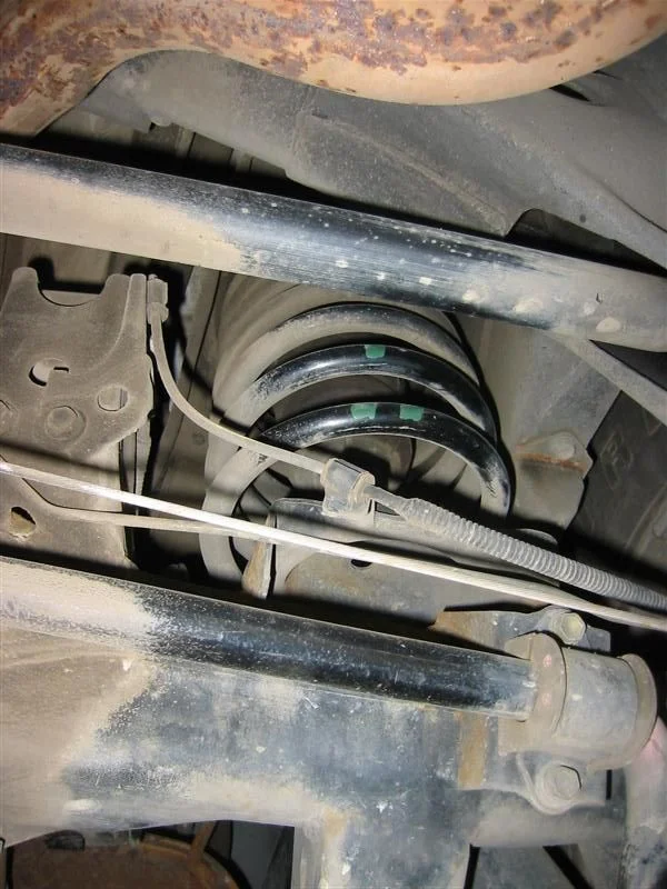

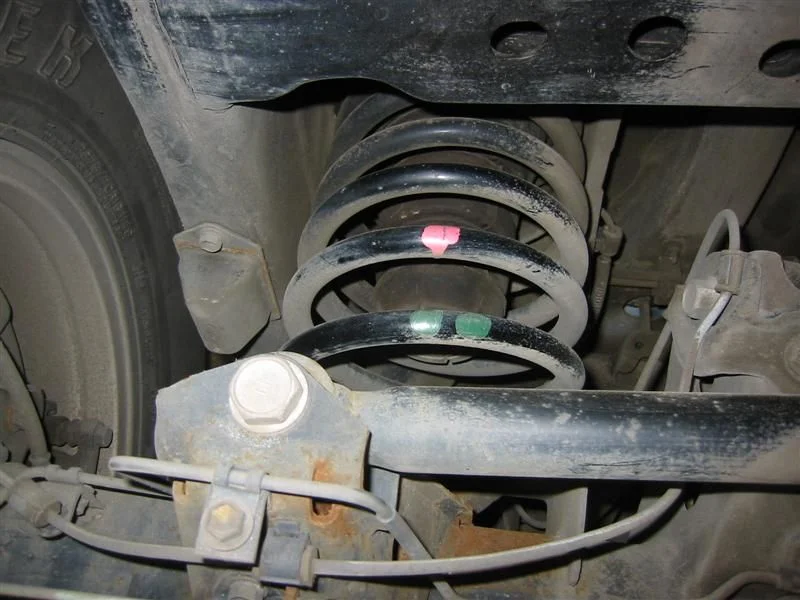

Anyone know the spring rates on the stock rear coil springs? Mine are
- Right side: two green dots down low, and one green dot above
- Left side: two green dots down low, and one pink dot above

It should be the same spring rate. The height are slightly different. I believe the taller one on driver's side.
You could adjust the leaning by adjusting the torsion bar.
they have spacers you put on top of the coils to adjust height.
I would start by adjusting the t-bar that is lower. That will level out the front and may even affect the rear enough that it levels out too. Otherwise, you can purchase OME trim packers (poly spacers) in 5 mm and 10 mm heights to space out the rear coils. I doubt the rear coils are spent at 80K miles. Upgrading/replacing the shocks may not be a bad idea though. Several here have been very happy with the stock springs and Bilstein shocks.

Shocks won't change the stance at all; they don't support any weight. The t-bar adjustment and/or spacers on the rear coils is the way to go to correct a lean.
Thanks for the feedback guys. Will lift front left and try to tighten the t-bar.
