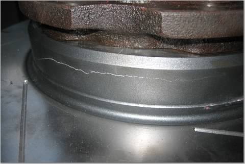

...Also, when installing wheel studs onto the new rotors, do they get pressed (driven, pulled, whatev) into the rotor before reattaching it to the wheel hub, installed on just the hub part, or do you install them onto the rotor/hub assembly?...
Use ONLY OEM wheel studs. Trust me on this (Pep Boys has earned my wrath).
Method 1: Support the hell out of the rotor (cause they will crack otherwise) and you can tap the studs into place with a hammer.
Method 2: Use a hyrdaulic press, again make sure it is supported all the way around. This may be the safest way...I didn't go this route.
Method 3: Use the lug nuts and an impact wrench. Insert the studs thru the rotor and use the lugs and wrench to pull the stud into place. This is what I ended up using after much frustration.
Take it slow and if you have to force it too much...this may happen:
47b5d907b3127cce935ea68aa4d900000016108AbMmLdk0YuV
By no means am I an expert, but this is how I did it (method 3) and it worked. Someone else who may have more experience can chime in with a better idea!
The Pep Boy studs they gave me were slightly too big and when I tried to force them in (which you should never do) they gave me a new door stopper.
Have fun.

maluhha, that's exactly why I want to get these wheel studs right the FIRST time. I got a pair of DBA slotted rotors from Boston Mangler a while back, and I DON'T want to break anything. I do have a few new Toyota studs though, just in case some of my old ones aren't reusable. My question though, is if you install the studs whith the rotors and hub bolted together, or with them about (in that case, are they installed onto the hub or the rotor?).

I do have access to a press, so if I can find a good method to support the rotor with the least risk of cracking, I'll use that.

meluhha, I ended up reusing all my old studs. I used a hydraulic press to push them out of the hub (which I ended up bolting the new rotors onto the hub before installing the studs) and they slipped out nice and smoothly. To reinstall 'em I had to use the bolt, washers & impact method, which ended up working perfectly too. They're in there good, and my right side hub/rotor assembly is all ready to go. Races driven in evenly and securely and bearings lubed (by hand) with Mobil 1 synthetic grease. The oil seal is a PITA though. I ended up setting an old race on top of it, spanning that with a brass drift and then smacking the middle of the drift with a hammer. I think that's what was done in the DVD too, but I can't remember for sure.
