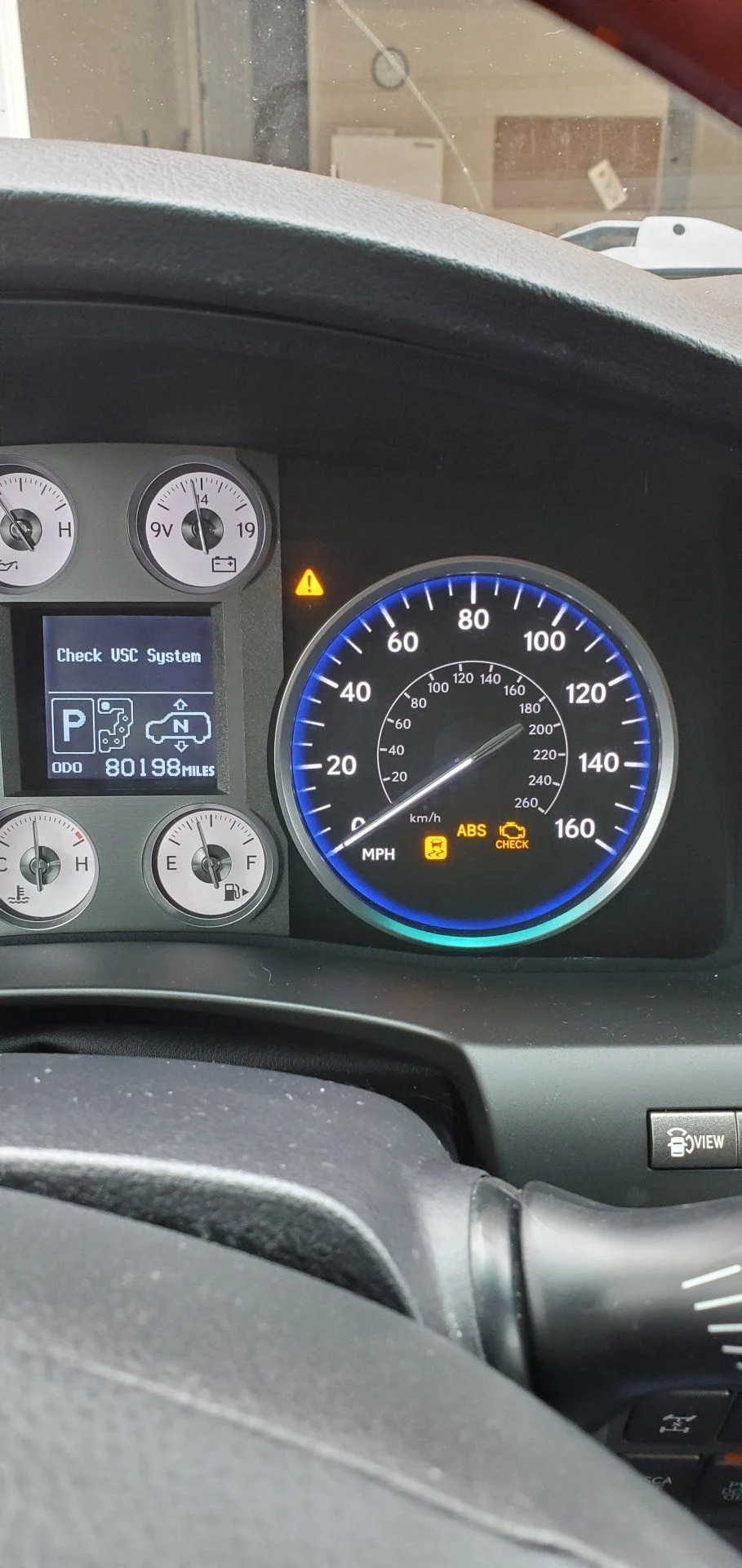

Thinking my wife might have bumped the switch when grabbing her cup, I put it in neutral and tried to engage 4LO (so I could then disengage it)...
The vehicle did not like that. You can't see it in the photo, but 4LO was still flashing.

Grabbed a code reader and it showed only one code P0705.
Cleared codes and warning lamps went off. Tried to engage 4LO and all seemed good - solid 4LO light. Tried to disengage 4LO and the dash lit up like a Christmas tree again. Code reader said no codes, and turning off the vehicle and then back on again cleared the dash.
