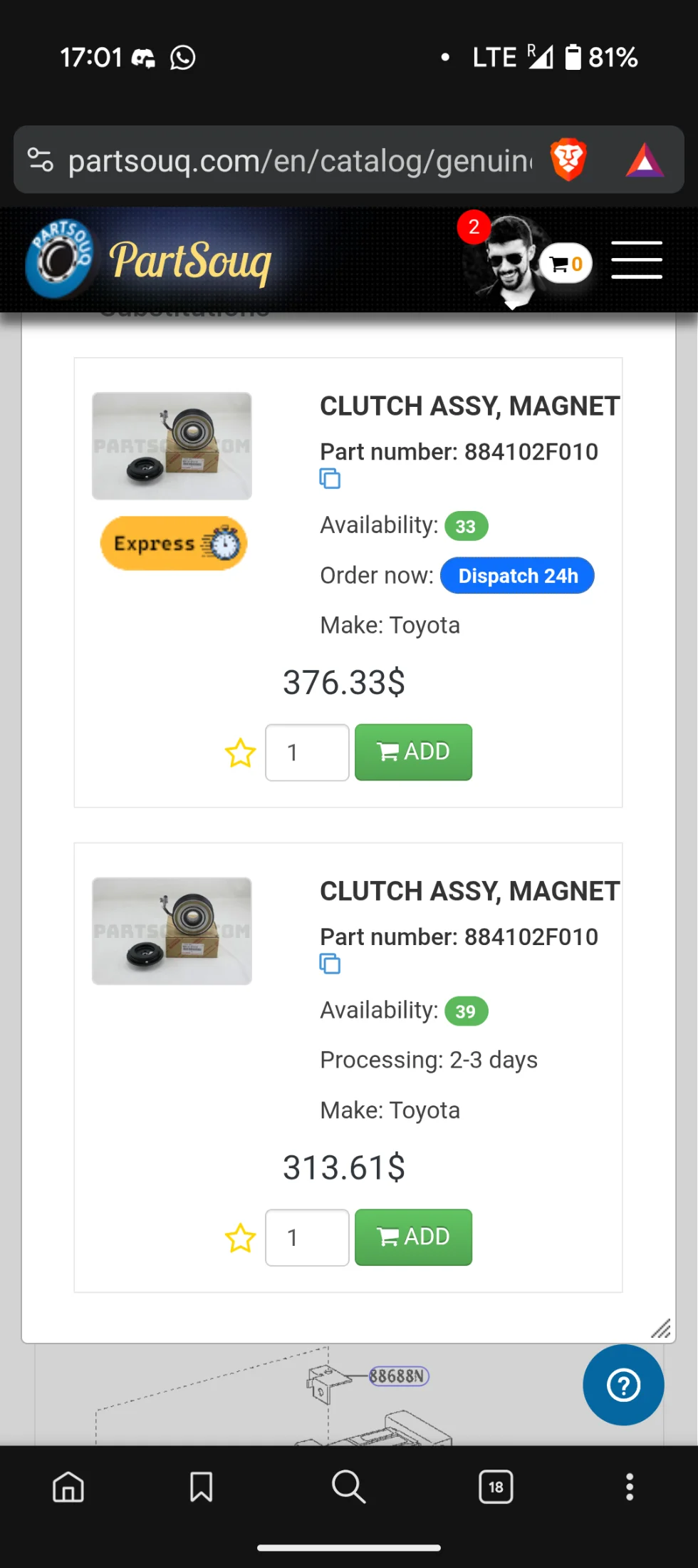

ok guys the problem was here, the rubber inside the pulley, was destroyed!
The compressor is ok, A/C works again

The reason I asked for the part number is because my AC would get slightly warm at times and be fine at other times. I thought maybe it was low on freon, so I took my truck to a dealer, which I never do, paid them a pretty penny for a recharge, since they said, they found a very slight leak in my condenser and I was a little low. After a day, it’s still the same, if even warmer at times. I just crawled under my truck and the entire compressor and clutch look fine, so it's probably not the same issue you had, and after some more online sleuthing, it looks like I’d probably target the compressor control (solenoid) valve, except Toyota doesn’t just sell that part. I see a video of someone doing one on another Toyota. I’m wondering if anyone has done one on an LC/LX200? I really don’t want to pay for a new compressor if it’s just that valve. It looks like I can just remove the passenger wheel and those protective plastic covers to get to it. Assuming I don't 'eff it up' trying to pull it out, do I have to have the system evacuated of freon? 🤷🏻‍♂️
