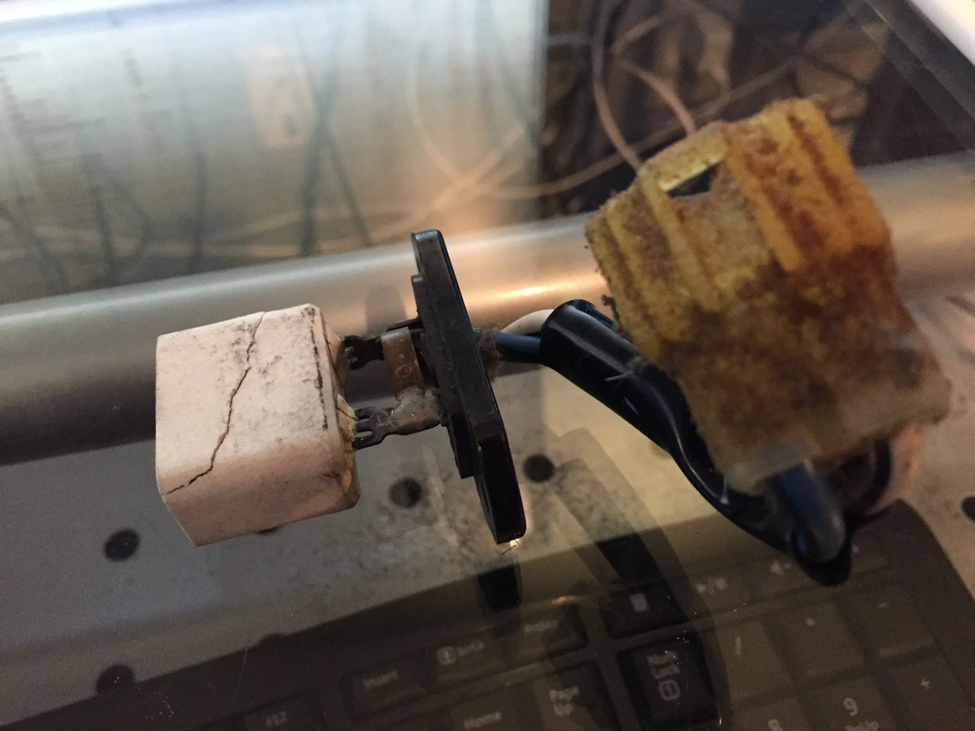

The ceramic of the resistor assembly is severely cracked. Hopefully be able to put an order in this week. It's been a reeallllly long time with only the high fan setting. :)
Ok I have replaced the resistor and now the fan works on the lower settings.
But now I have a new problem, the lower fan speeds are all the same now. Low, Low-Medium, and Medium all blow out at the same speed.
