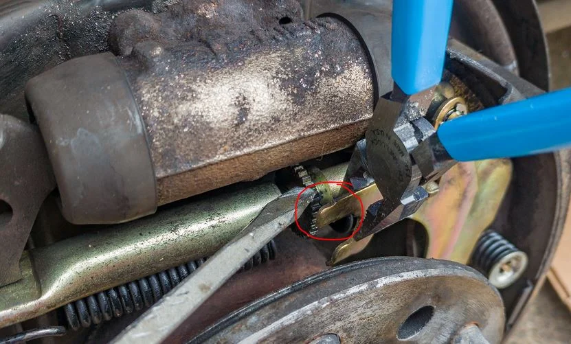

Great thread and info from everyone. I posted on my experience with ABS on my 1998 but on a recent situation with a very loose handbrake lever, removal of the drums (rear only of course) it turned out that there's an adjustment plate made of ~16 gauge sheet metal. It has tabs that will snap off if you have a driver that pulls the lever aggressively when parking. Granted, in many coastal areas along the west, we have hills and slopes where you'd think the lever being pulled will do its job. Gotta pull that sucker to avoid forcing the tranny forks I guess. Well, bad engineering on these little parts and when they break, the rear brakes will no longer self-adjust. The system (as mentioned elsewhere) is designed to adjust each time the lever is pulled up. Alas, the weenie sheet metal tabs break and the handbrake become useless.
Great picture! For future reference that small adjustment wheel with ratchet teeth is accessible from back side without removing wheel or drum. Look for the oblong rubber plug. From that position you can adjust shoes tighter. If you go too far they can be loosened as well from the same hole, just need another tool (I use a 90 degree pick) to push the ratchet pawl off the wheel while turning wheel in opposite direction. Of course if those pawls are snapped off all bets are off.
