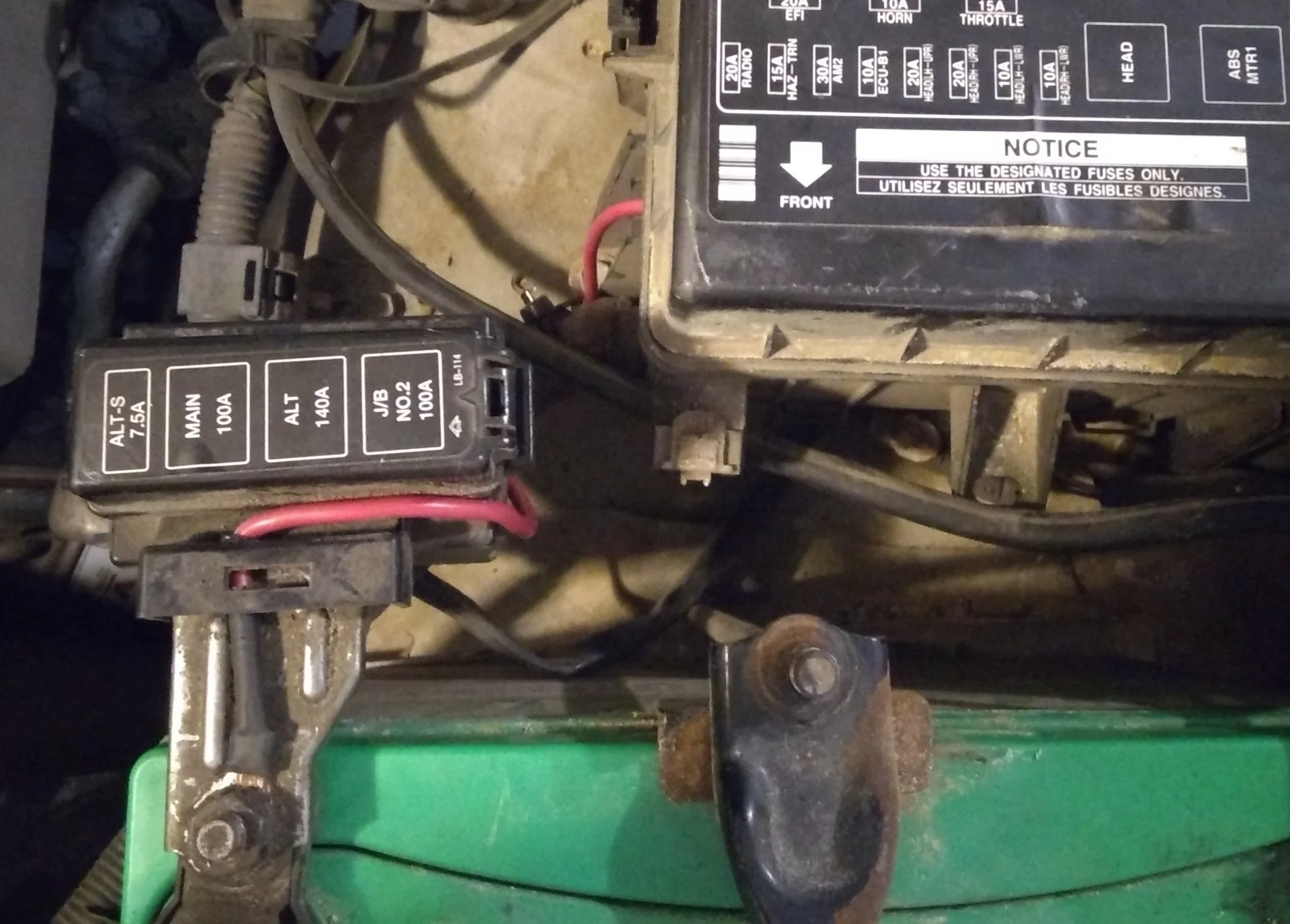

View attachment 3173612View attachment 3173613
Personally, I would not consider this a permanent fix but rather a temporary solution to an obvious problem for which a permanent solution exists (buy a new fuse box). @medtro ‘s approach can be a permanent fix, but your’s tapping straight to the battery is not, IMO. I think you’d be better off going through the fusible link for power rather than straight to the battery. BUT, I’m not an electrician, so….
I have a 20A fuse inline (yellow) as shown in the pic. This is between the battery and Terminal E. I'm going to consider this permanent for myself.
