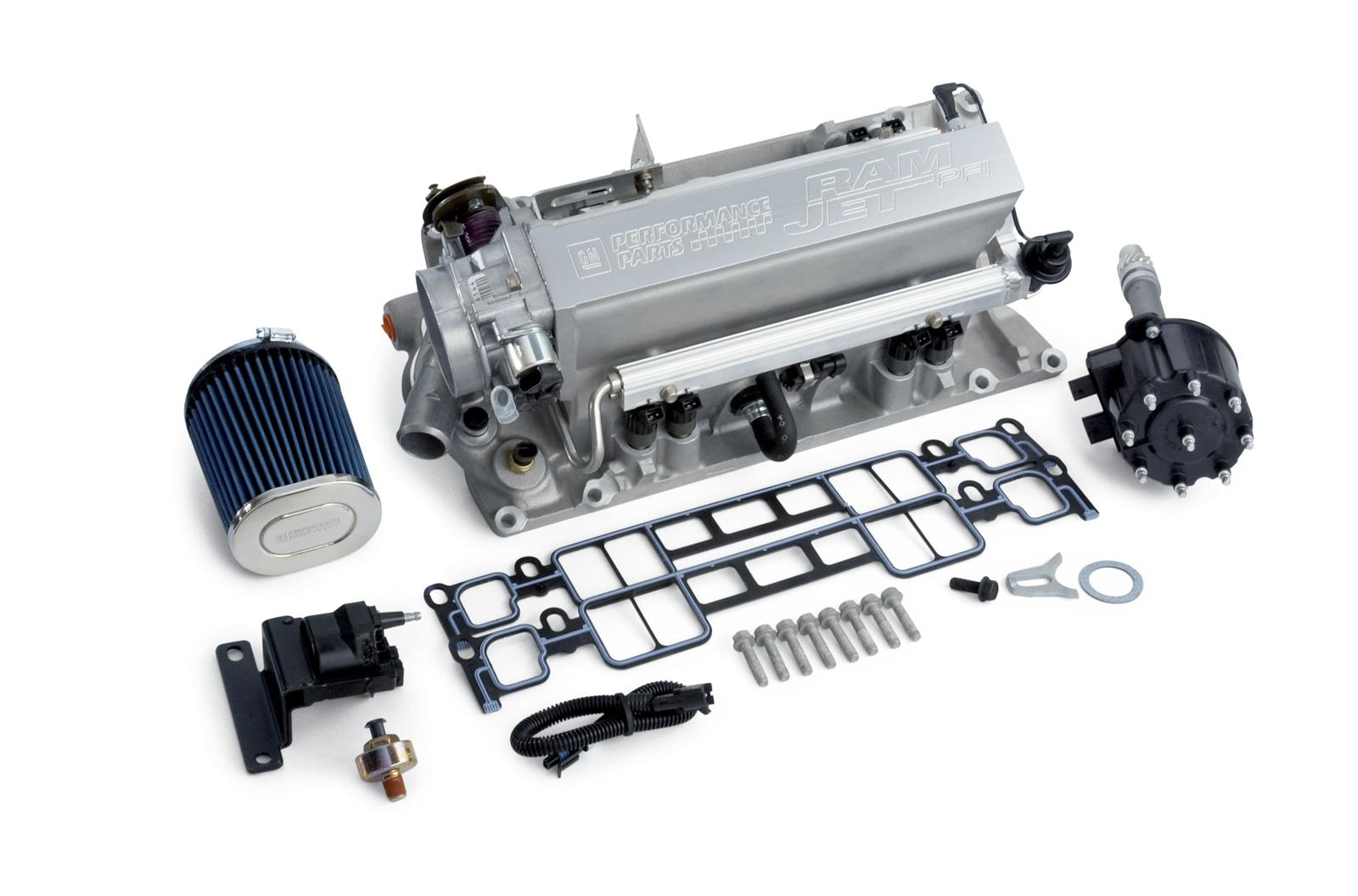

For induction, I have been looking at solutions between holley, eddelbrock, and ramjet. Its been hard for me to find any meaningful comparison, but I may be looking in the wrong places. Right now, I'm going back and forth between RamJet and Holley. Holley looks to be $3700, ramjet looks like $3000, and eddelbrock is closer to $2000. This is without any head conversion to rollers (I'm uncertain if this is truly required). Is the performance gain from Holley significantly different to justify the expense? How do they justify a near 200% price increase above eddelbrock?

Purchasing a 3700 dollar induction system for my setup now feels like putting lipstick on a pig. Thank you, but no thank you Holley/RamJet. I'll definitely be putting in some time at the junkyards.
