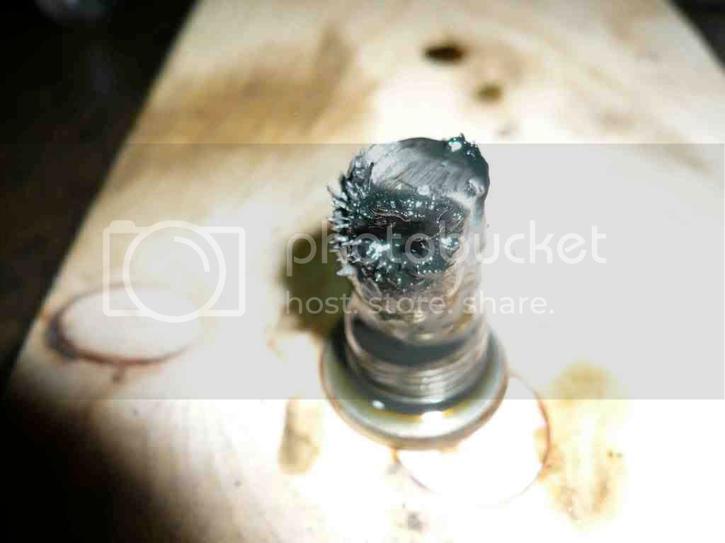

There has been little or no change. Did find some filings in the front differential oil and a small piece of metal maybe 1/16" thick and 1/8"x1/8" in the oil.
