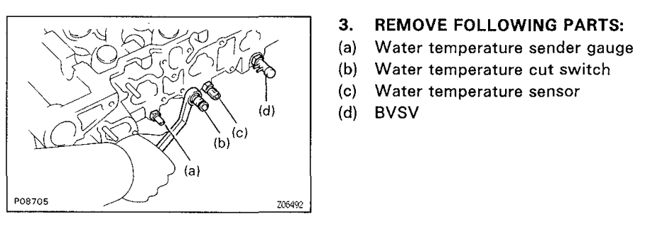

thanks for the links and comments. for the sensor, i believe we are talking about (c) in the diagram below?
They sure make it look easy to reach in there and get at those things. It was not the case for me. I agree, BTW, that just replacing sensors in general is a great idea. They are 25 years old at this point and at the least the plastic on the connectors is brittle as hell.

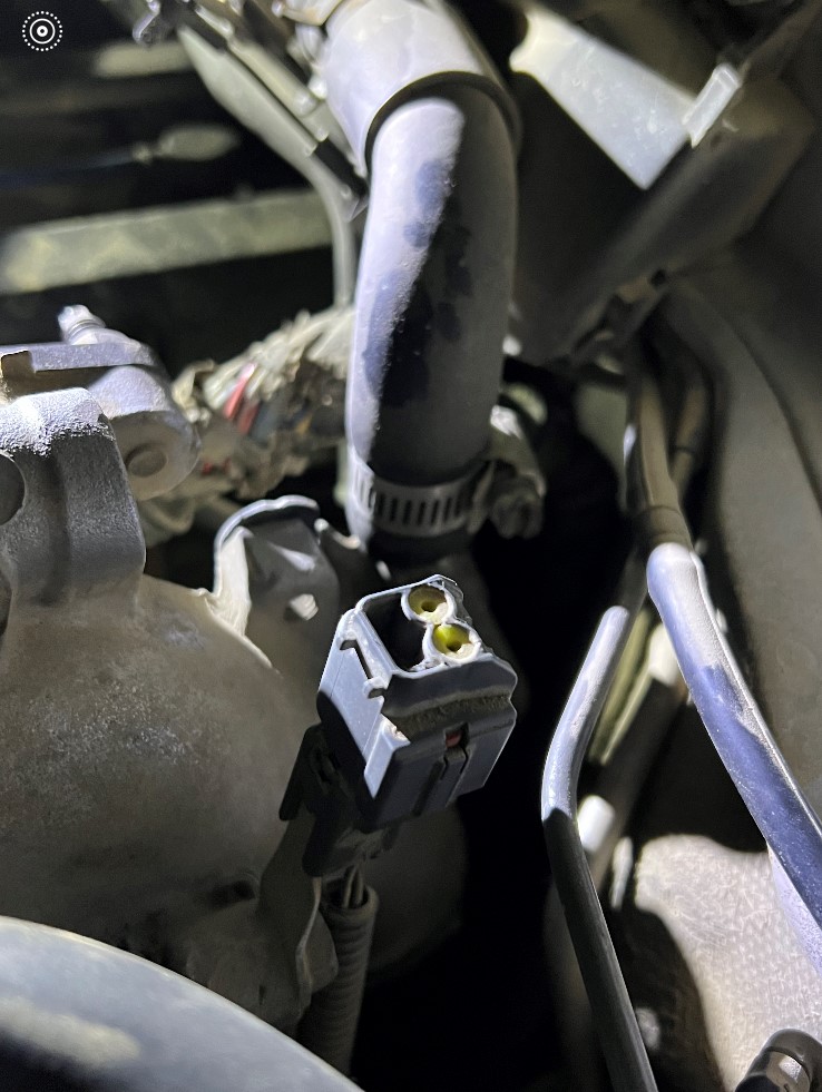

temp sensor was pretty gross and brittle, but changing it out had no impact to the crummy idle, etc. still glad i changed it. i took a closer look at the EGR delete, i said wits end, but that was just the "key chain" they sell. the plug looks similar to the one sold by mud vendor (pic below) ? didn't see anything visibly wrong with any wiring around the MAF but the main wiring harness near where the EGR would have been has been hot, and main insulation is exposing some of the wires (no bare wires that i can see) which you can also see from the pic... the truck is idling at only about 250 with AC off, which i know is way low, possibly same culprit?

You said the harness by the egr has seen some heat and it's showing wires. Definitely open this up and investigate. Make sure there is no metal wire exposed and get the harness repaired and wrapped up well.
Also make sure there are no vacuum leaks.
If all that checks out and doesn't fix the issue than I would recommend doing some research and gaining a thorough knowledge of a proper egr delete and than make sure it was done proper.
