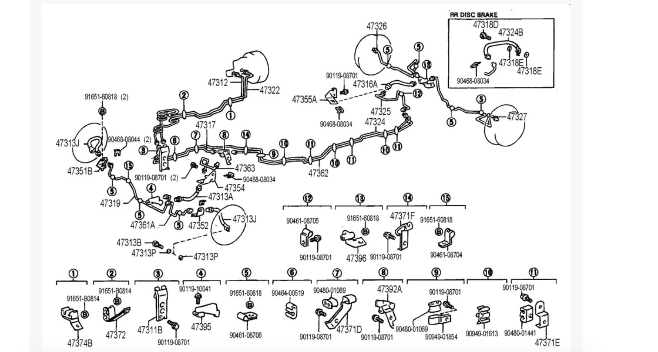

I have one about 20 minutes away that I will try and source one from on Monday. I am hoping it comes pre-bent and flared..First time replacing brake lines. The one that needs replaced is 47324
What year/model 80 Series are you working?? Not a parts expert but there appears to be a change between pre-95 models and 95-97 years.
47324 shows to be Tube, Rear Brake #4, 47324-60211
It will be an exact replacement, all the right bends with flared ends, flare nuts attached

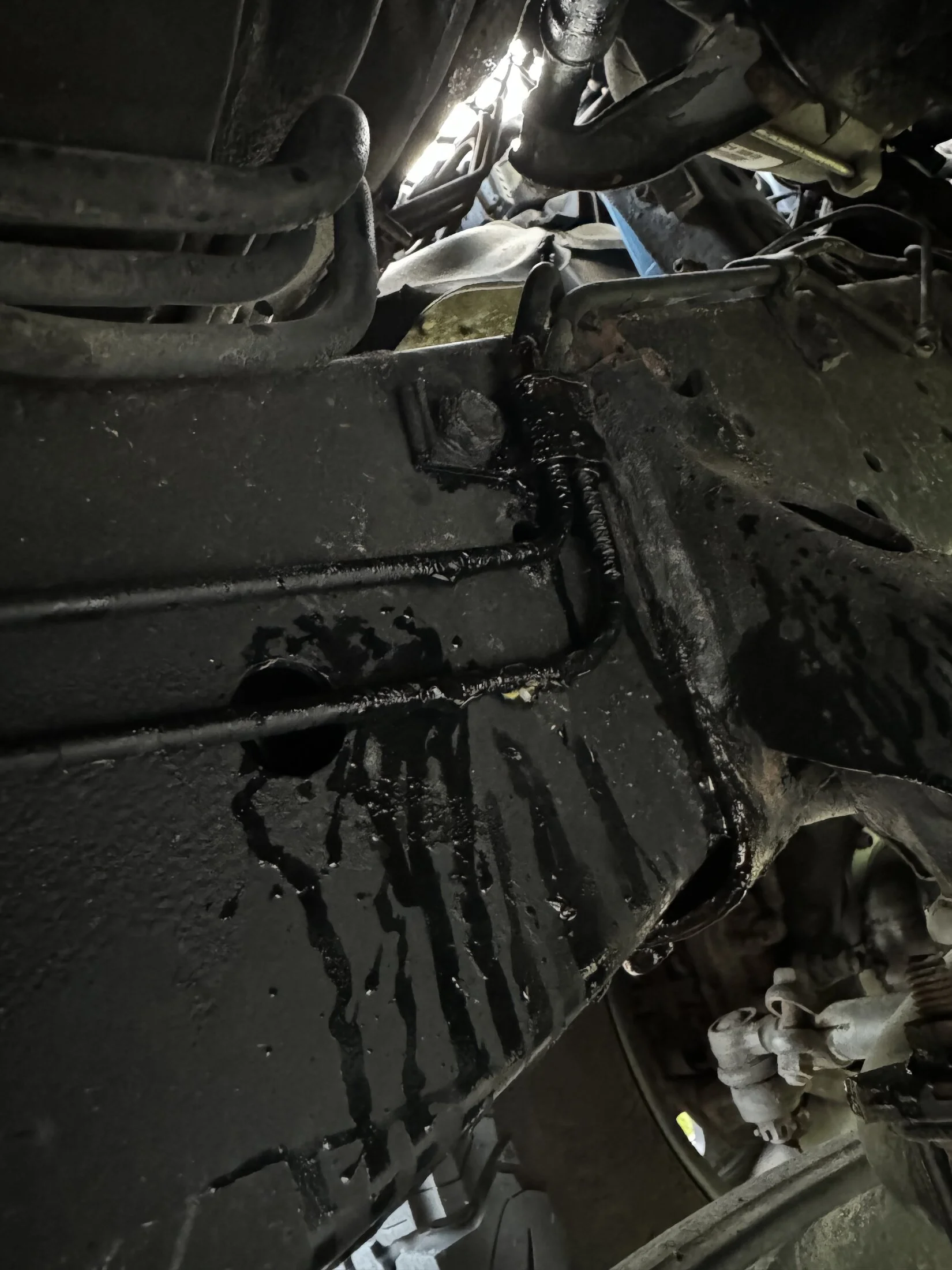

Is the leak under the bracket in the photo? Any other lines with corrosion?
