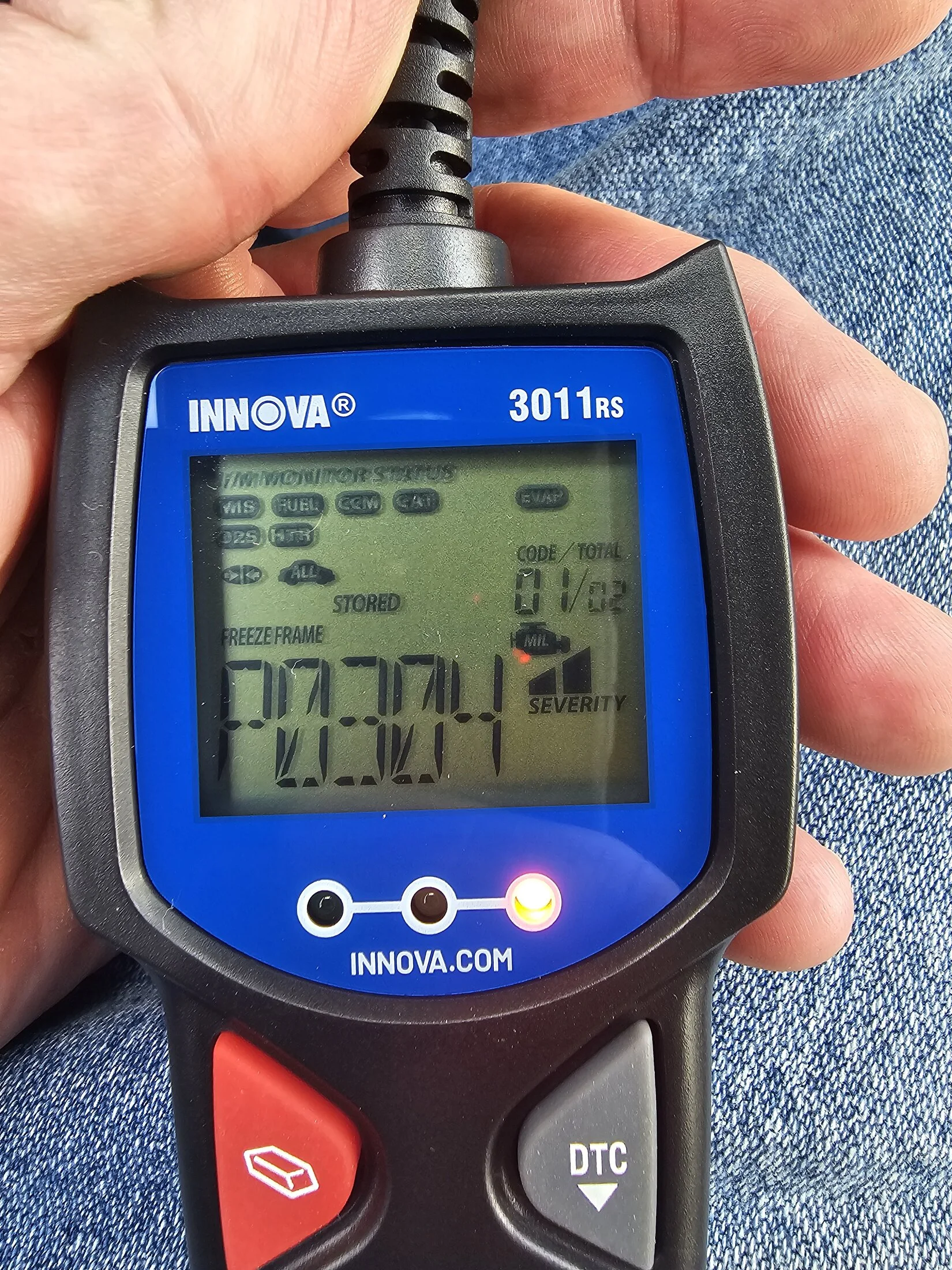

Driving the 4runner last weekend I felt a slight misfire after a cold start. It went away shortly after but the next day I started it up and the check engine light was on and it had a constant misfire. I replaced cyl 3 ignition coil and all the wires from the other ignition coils to cylinders 2, 4 & 6 while I was at it. After erasing the code, the 4runner won't fire at all. TIA for any suggestions.

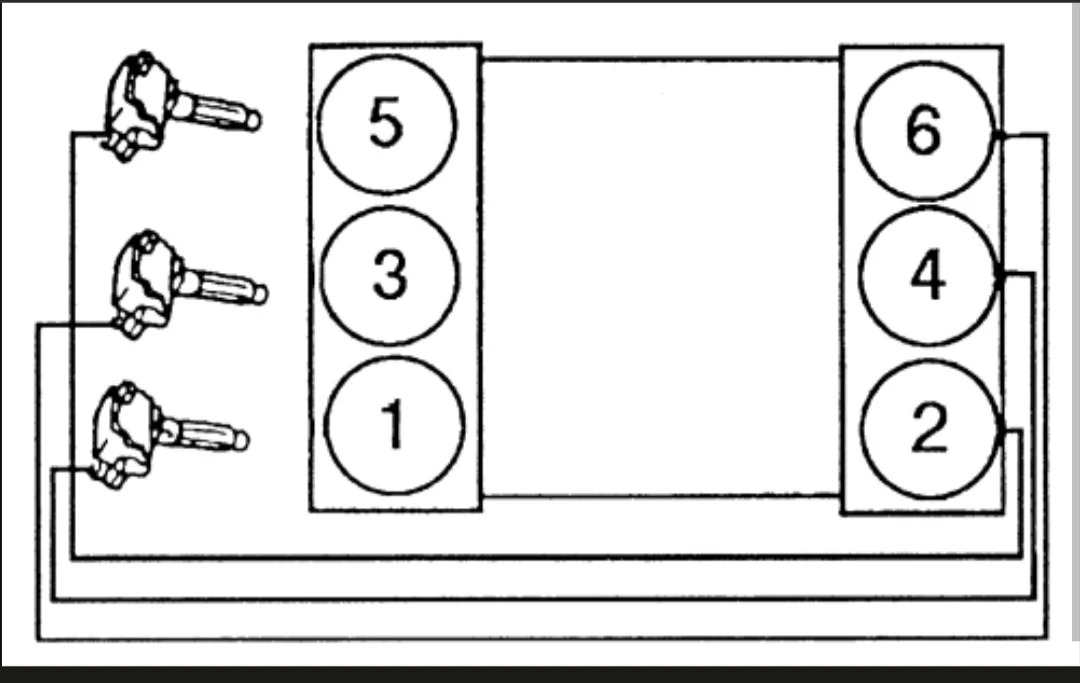

did you verify wires are routed correctly?
