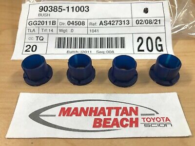

yes...bushings are on order. I removed the solenoid that is on the bottom side of the ignition switch assembly. This essentially removes the key lock feature in Park.
Is the solenoid you mention part of the lock cylinder - or a separate part??
What part numbers do you have for the shifter bushings?
