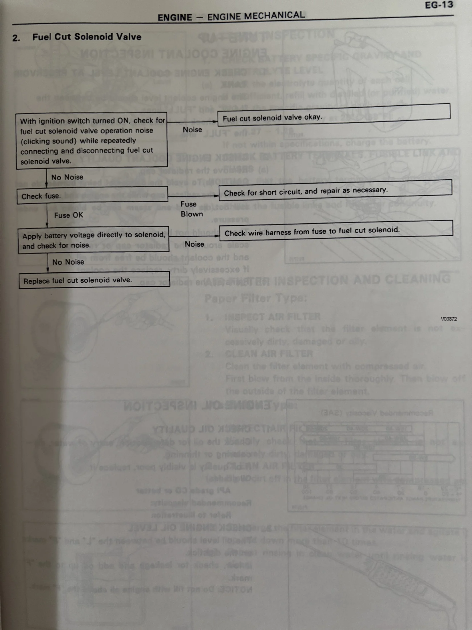

Next would be the injection pump and that solenoid that opens to allow fuel into the pump. Those are a fail point.

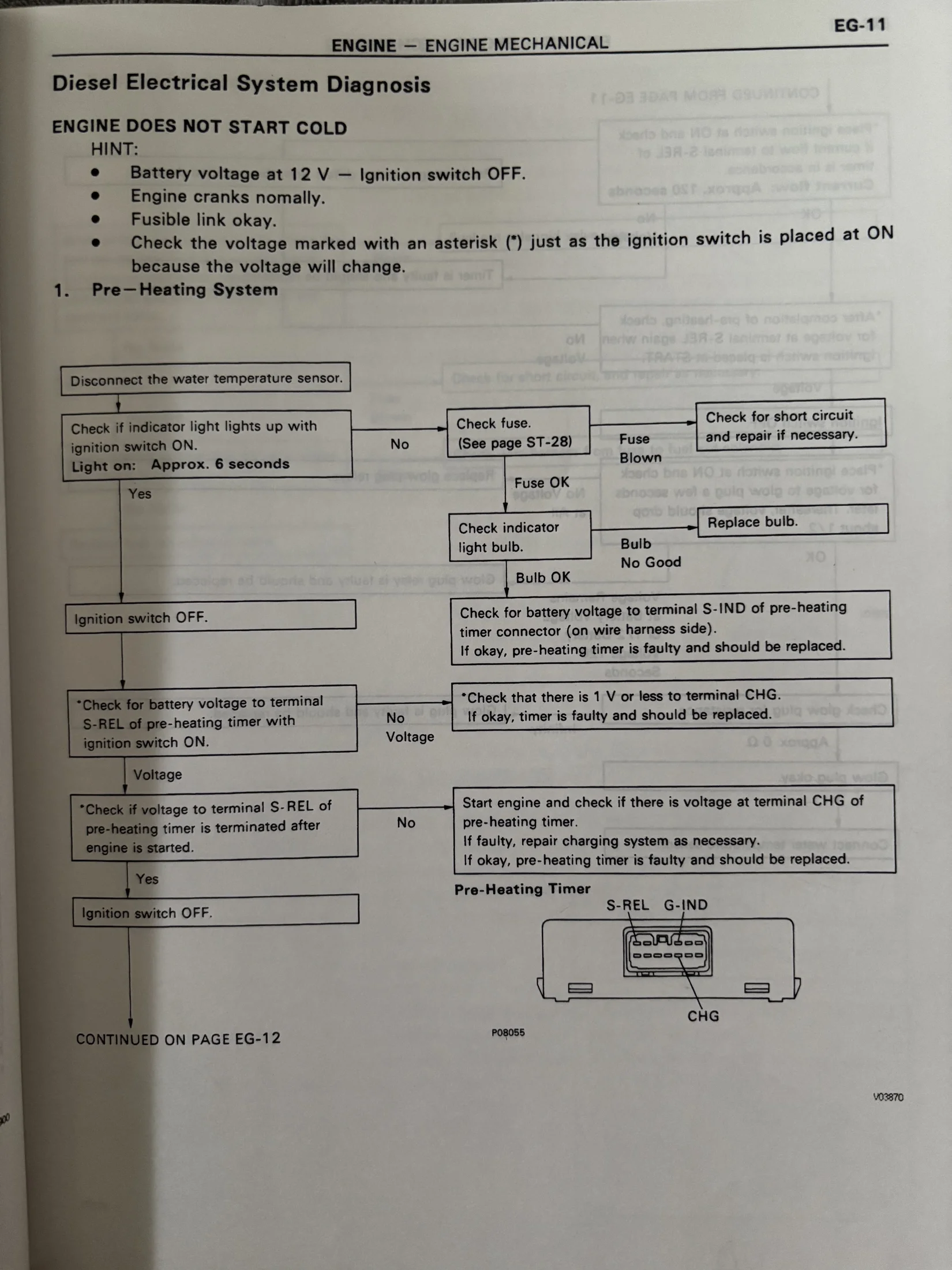

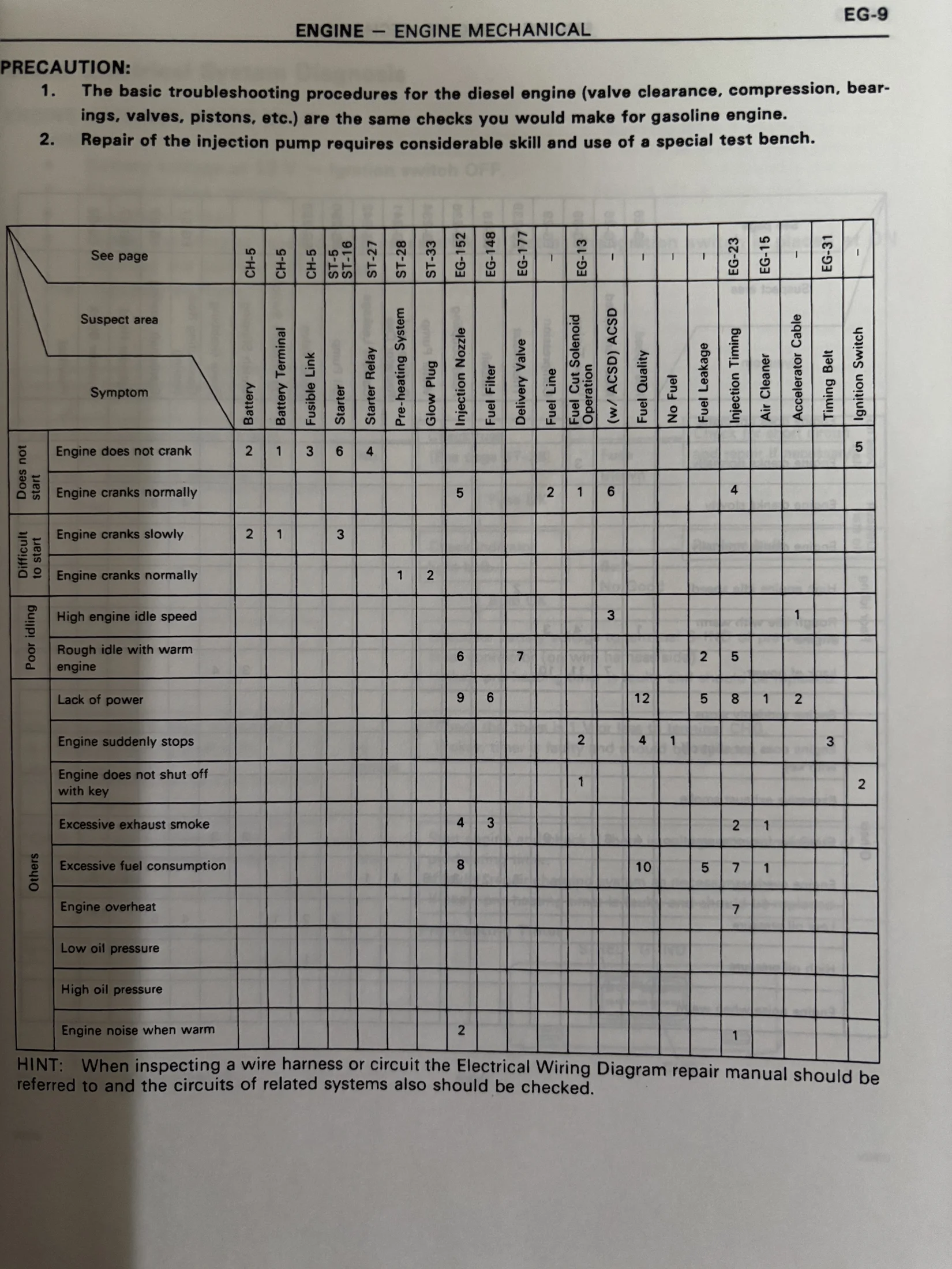

Also here is the troubleshooting steps out of the engine manual.
