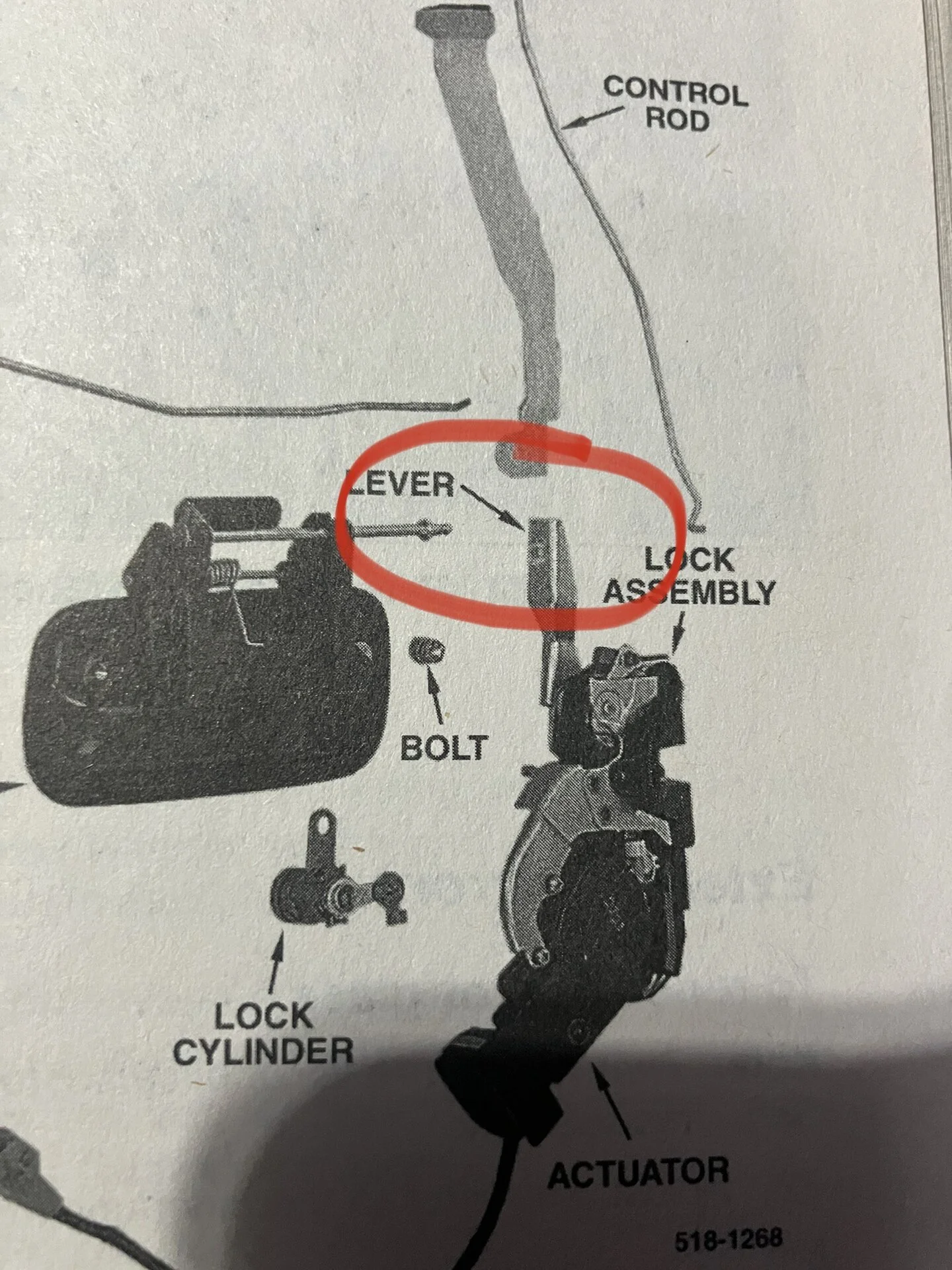

The pivot rod from the door handle seems to be semi-permanently attached to the metal door lock actuator lever. Below are some pics, including the Haynes guide. The spot circled in red is where the handle's pivot rod connects to the actuator lever, but I can't get them separated. It doesn't seem like there is any retaining clip, but I'm also afraid to pull too hard and bend/break the actuator.
Pic 1: front left door handle from inside the door pocket. The actuator lever is much more firmly attached, with a snug, round mounting, compared to the plastic U-shaped lever of the rear door handless.

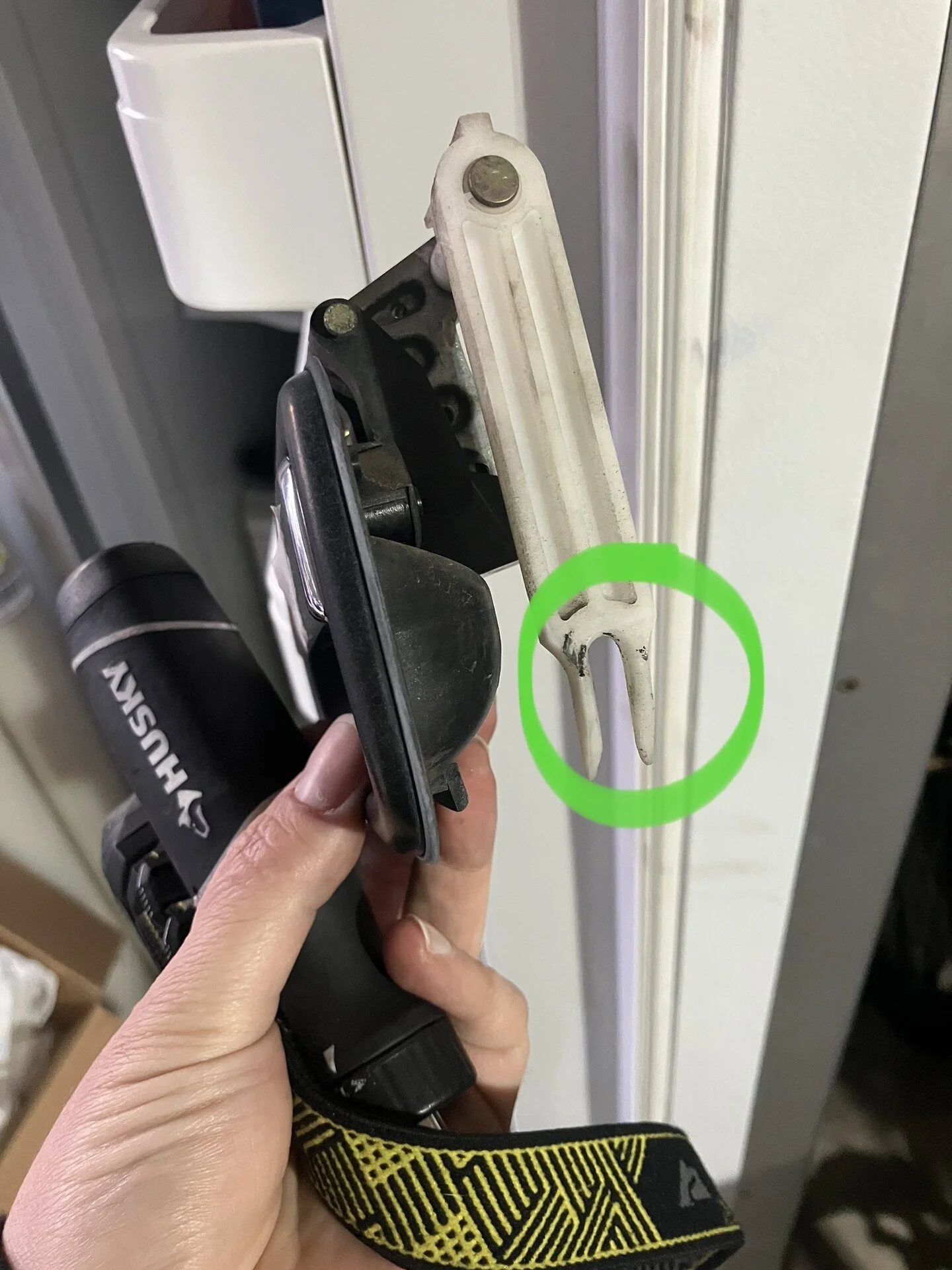

Pic 2: rear door handle - notice that the *plastic* lever on the rear handle is connected to the handle. It separated very easily since the lever has a U shape clip at the bottom (circled in green).

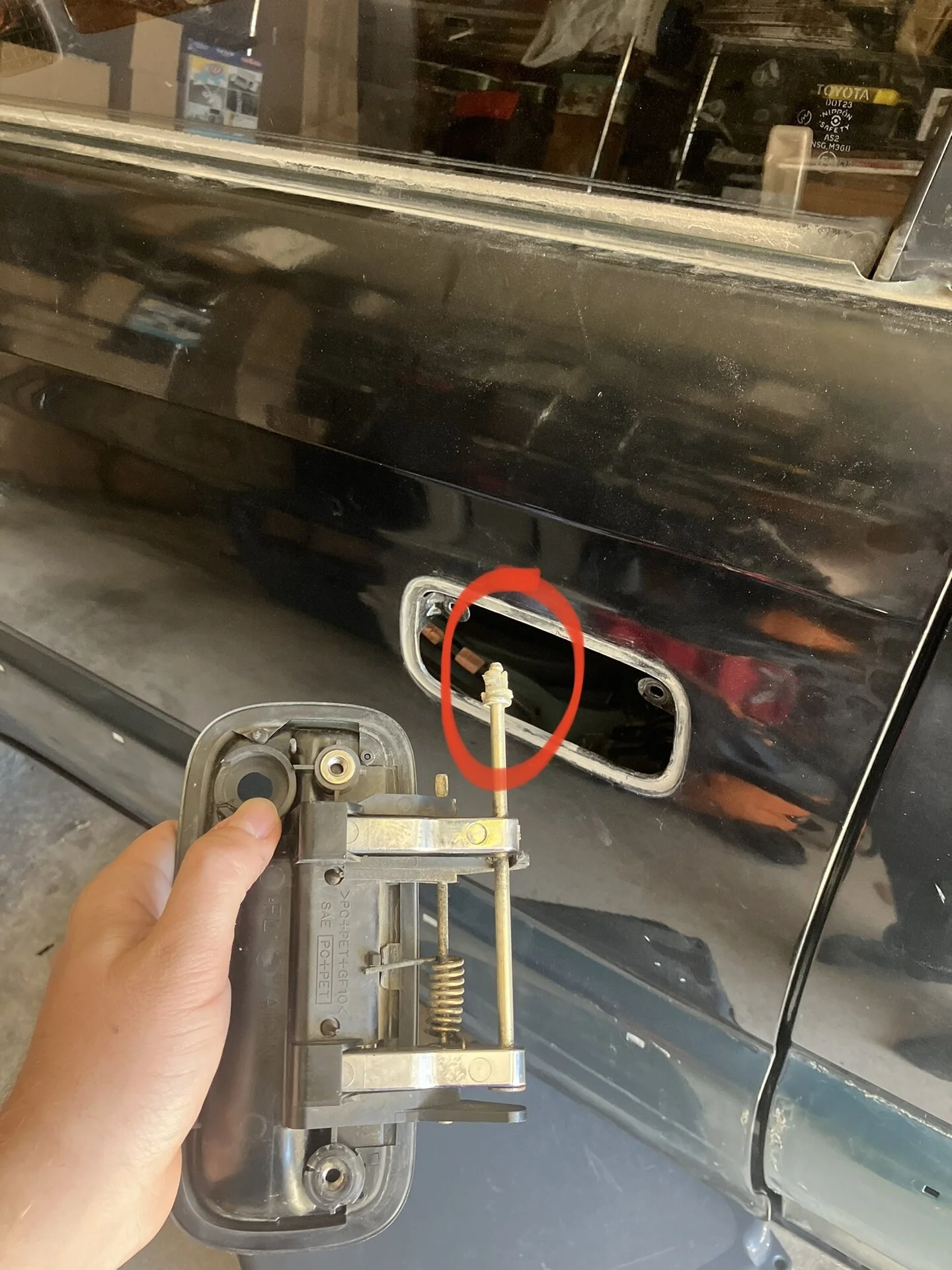

After about $100 in purchasing different tools, I finally got the handle loose from the actuator lever with the help of the trim removal tool circled in red! Last step and she's going for paint in 11 days :)
