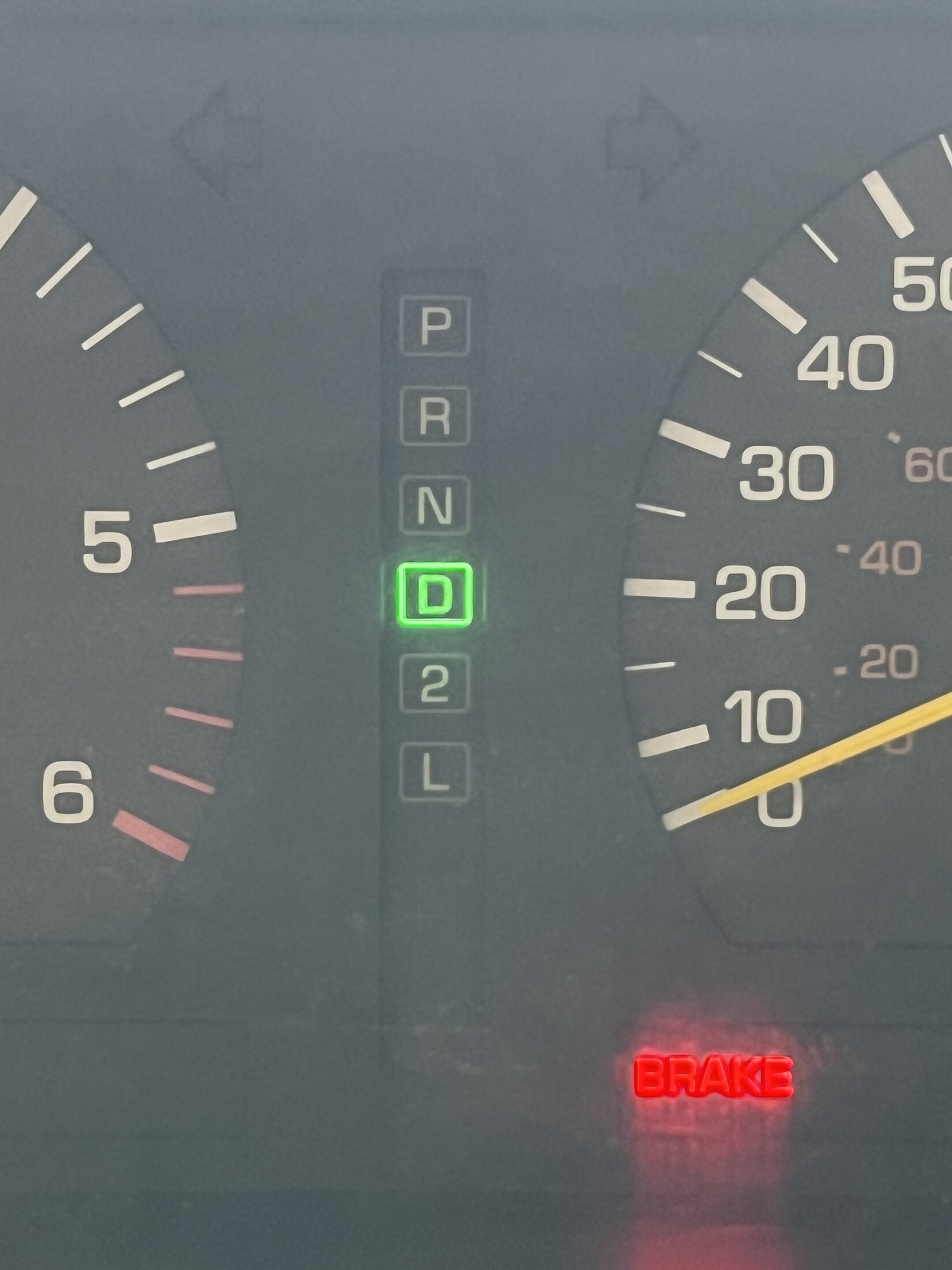

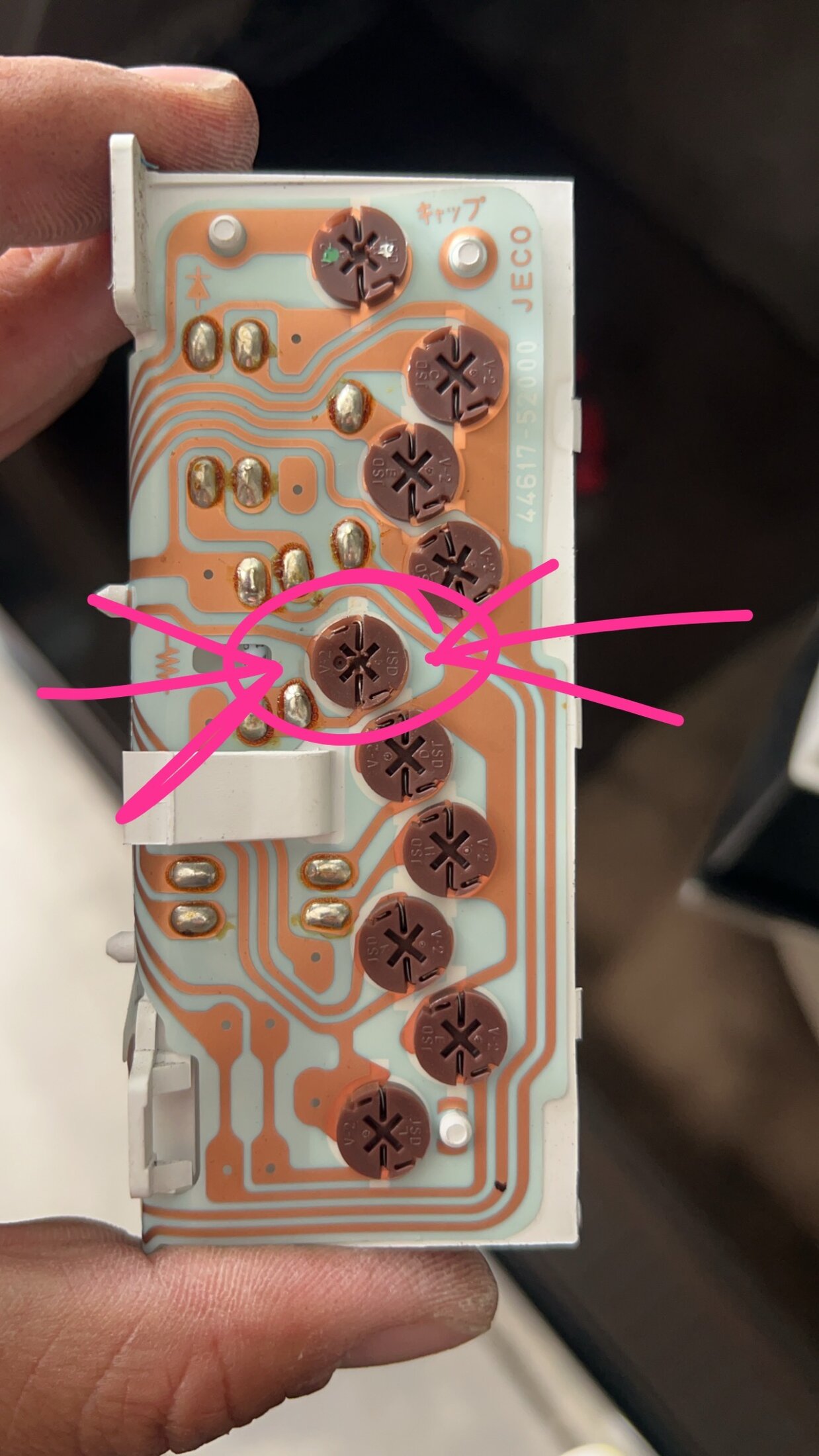

95’ LC 80 series D light replacement instrument cluster
Sep 12, 2024
1
1
Washington
Bulb part # 90072-02005
See photos for more details

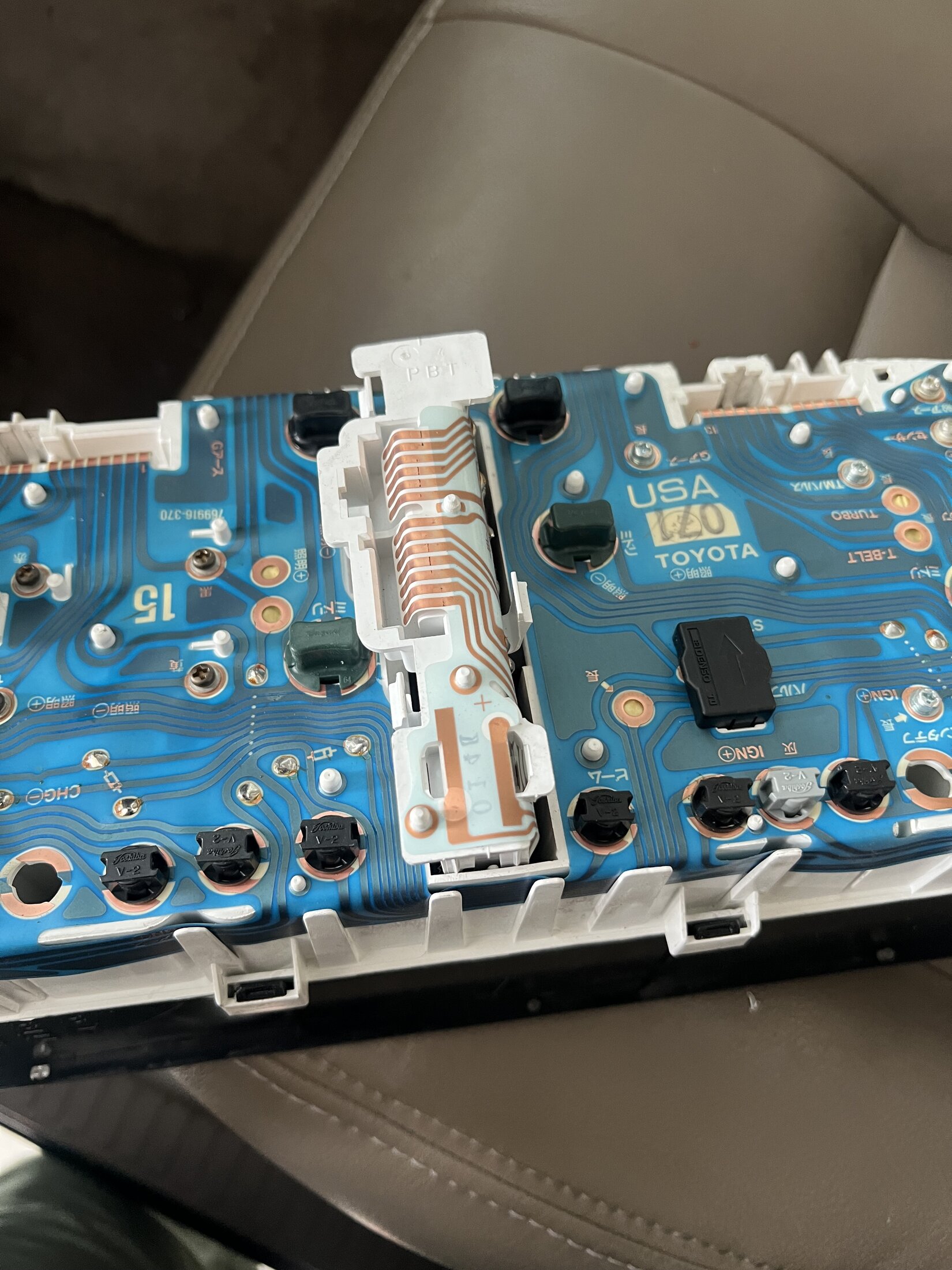

Did you replace bulb & green condom, or just the bulb?

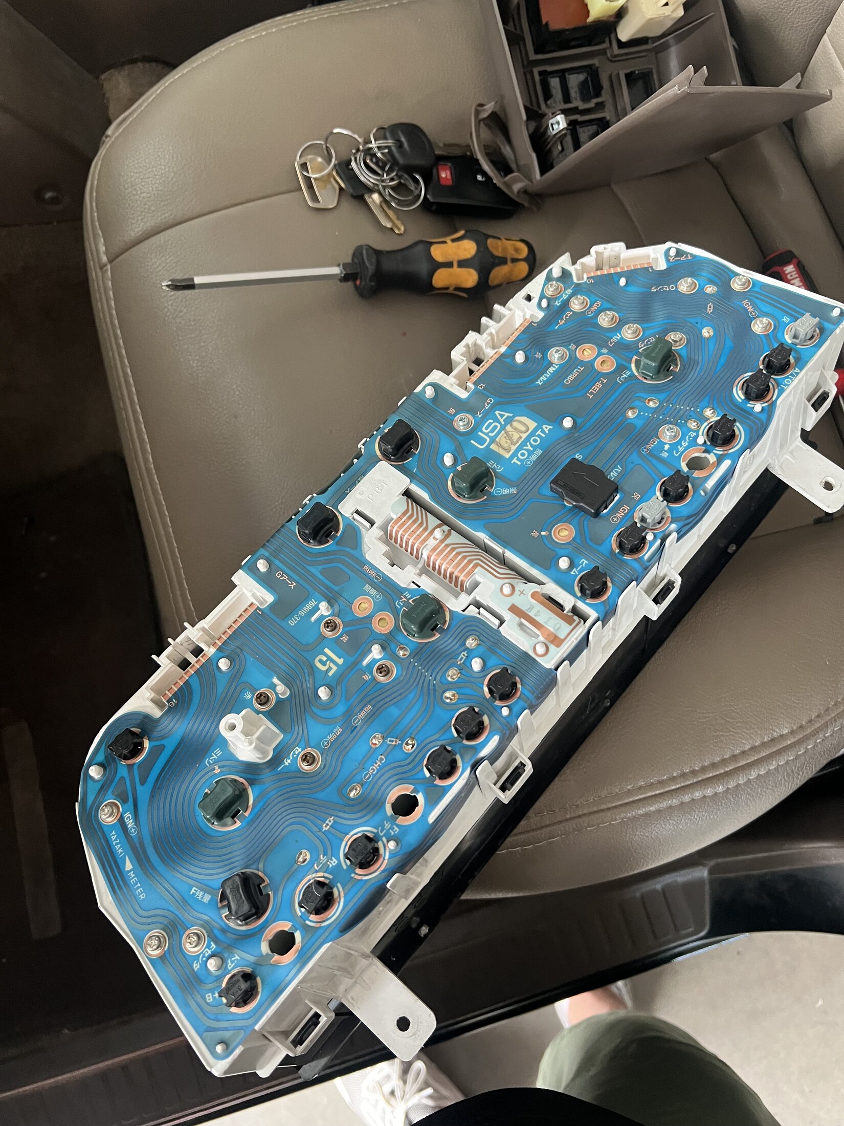

I’m about to tackle this while fixing my speedo, I have the bulb, but no new condom.

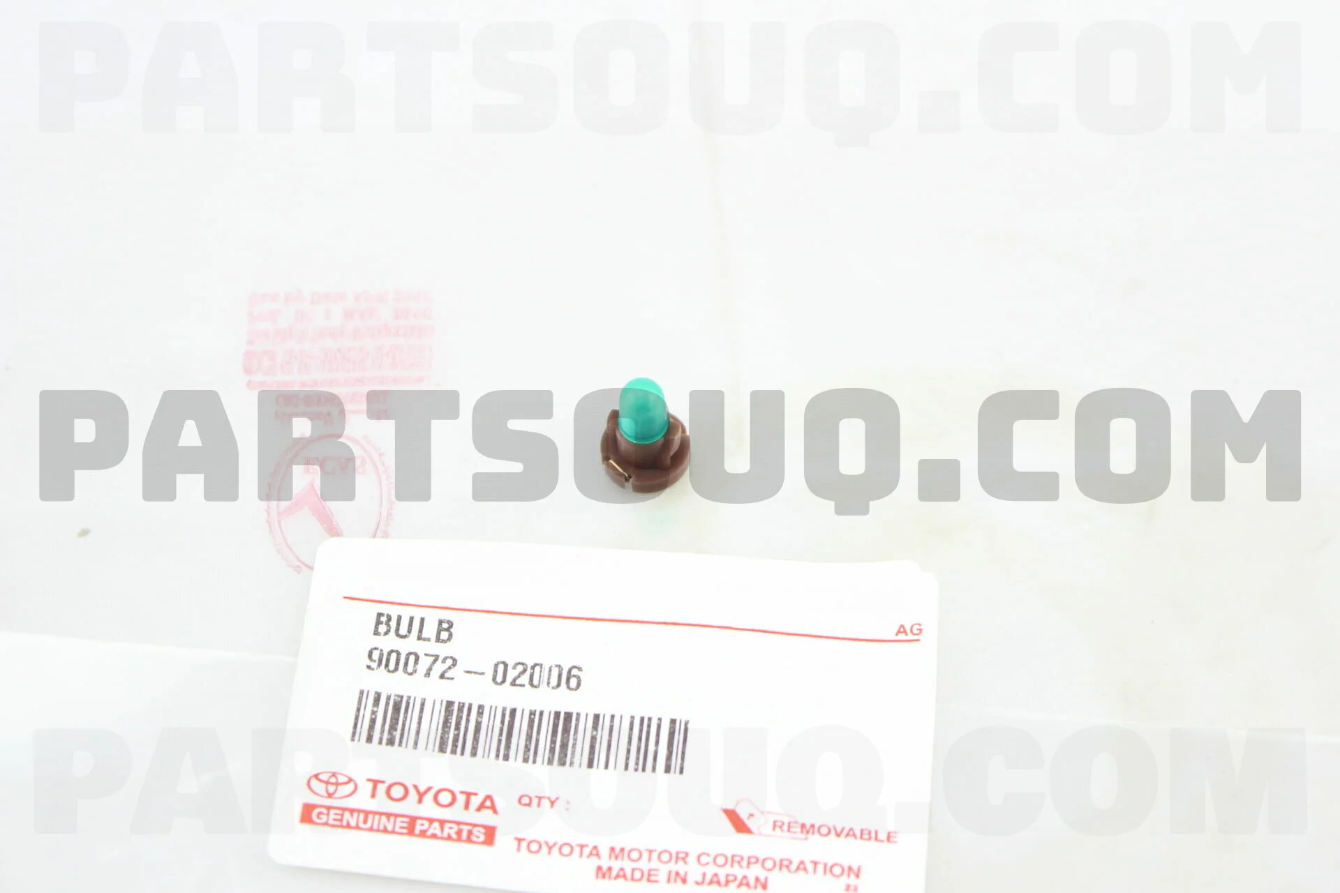

I am getting ready to pull my gauge cluster on my '96. While I have it out, I would like to replace all of the bulbs (including the D). Does anyone sell the complete kit or do I need to buy them individually? Thanks.
I bought them individually from Partssouq for a whole heckuva lot less than the local dealer was asking.
Thanks CharlieS. I am new to this forum. Is Partssouq an online store or a member on this forum? I will also be looking for replacement AC registers as well.
Overseas parts supplier of oem parts, they are usually signifigantly cheaper but sometimes come with foreign credit card fees and increased shipping but their parts usually arrive quicker than stuff I have ordered from the west coast.
Replaced all of the bulbs and the AC registers. Thanks so much to all! The only edit I have is that I found it easier to take a 180 degree pick and remove the clear face from the gauge cluster and then pull the assembly out to unclip the connectors. This made it quite easy.
