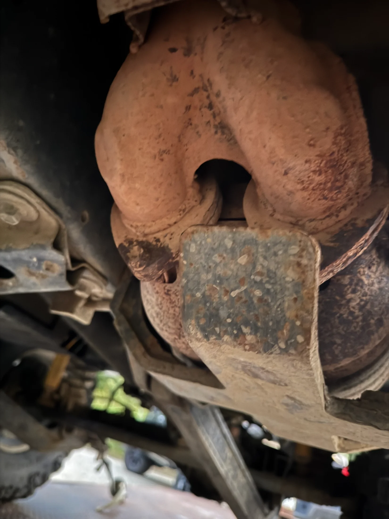

Routing is above the frame, looks original to me. Maybe there's two cats in there? hard to tell with the skid plate that's protecting it!
Yes you have 2 cats under that sheet metal shield.
I found this, apparently there ARE two cats hiding in there! Only thing I "need" right now is to replace the muffler and tailpipe, but I may yank the cats. No inspections here

@Elkwagn, Stock ODB1 93-94 models used two cats side by side with one O2 sensor in front of each cat. Each cat handles 3 cylinders. The 93-94 has the preferred routing above the frame.
Stock ODB2 95-97 models used two cats inline with one O2 sensor in the front and the second between the cats. The 05-97 routing under the frame is what you seem to be describing.
Your single cat system is an aftermarket version used on the 95-97 most likely made by Magnoflo or Bosal who was bought out by Maganaflow. In order to use that on a 94 then there is going to be some voodoo that was done to have the proper O2 configuration.
You should post some pictures of what you have including the O2 sensors so we can evaluate what you have.
