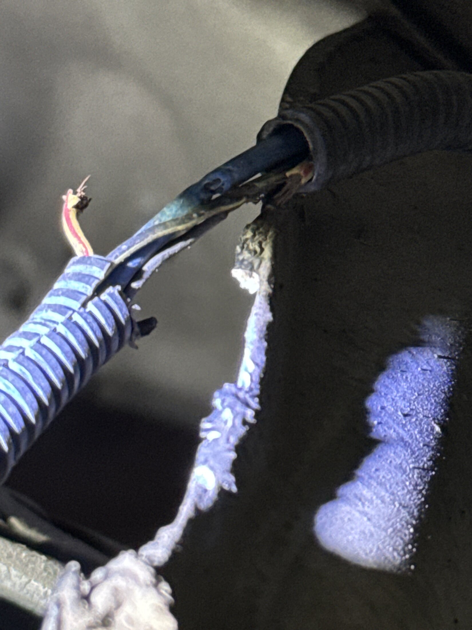

So my new to me 80 was throwing 21 code. Found wiring was damaged. I have a parts 80 so I cut the wiring for o2 sensor off old parts rig and cut damaged o2 wiring from my 93.
Question is the blue wire is a wire inside a wire. How to I splice that one?
Can I use heat shrink butt connectors or is there a better option? I’m now getting 25 code and I think it’s the blue wire double wire that is causing it.

The blue wire has a wire in a wire. How do I splice that in?
It can be spliced, separate the inner and outer conductors, then splice them one buy one. use 2 small pieces of heat shrink to keep them from touching and then a large piece of heat shrink over the whole thing.

The blue wire is your O2 signal wire. It has a shielding jacket around it that only blocks EM interference.
The yellow/red is your heater+ wire.
You should have enough extra wire to put in a butt connector or solder/shrink wrap.

So on blue wire can I just cut the outside shelling wire and just connect the inner wires together with solder butt connector and shrink tube?
Yeap. I soldered and used shrink tube to cover my connections. I would cut the shielding cover back about a half inch from the joint so there's no chance of the shielding touching the signal wire.
