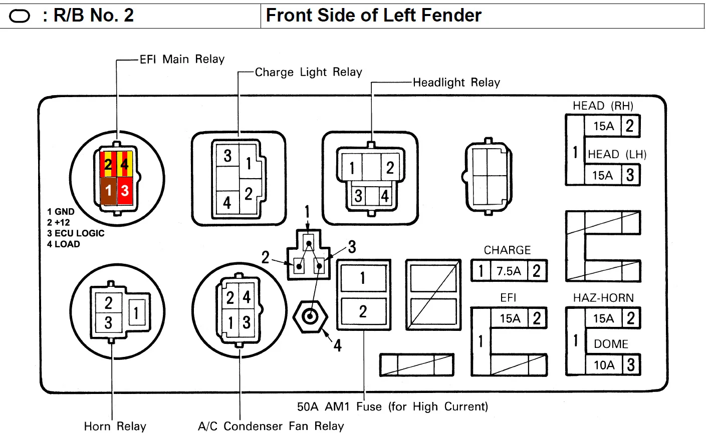

check your EFI -Main relay in the engine bay.
My parents had a 91fj80- and when that relay played up it exhibited the same symptoms. Eventually theirs had to be replaced and all good since
A bit of percussive diagnostics should reveal the issue.

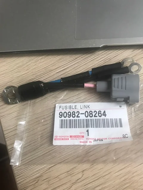

As stated above, the set of 3 fusible links off the positive battery terminal are subject to vibration and can fracture over time.
On the 3FE, the EFI main relay/contacts/wiring should be inspected.
