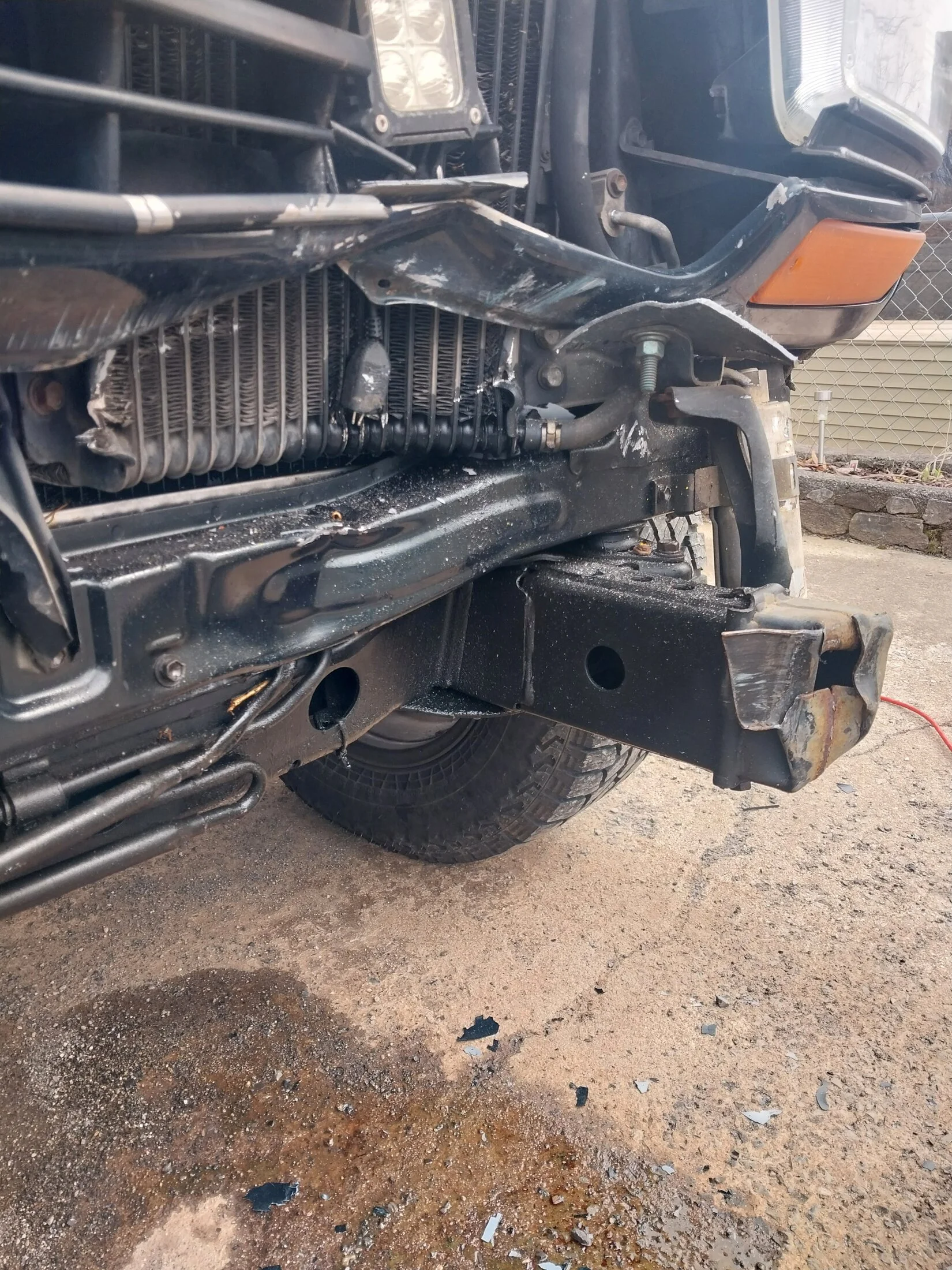

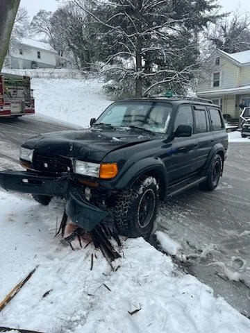

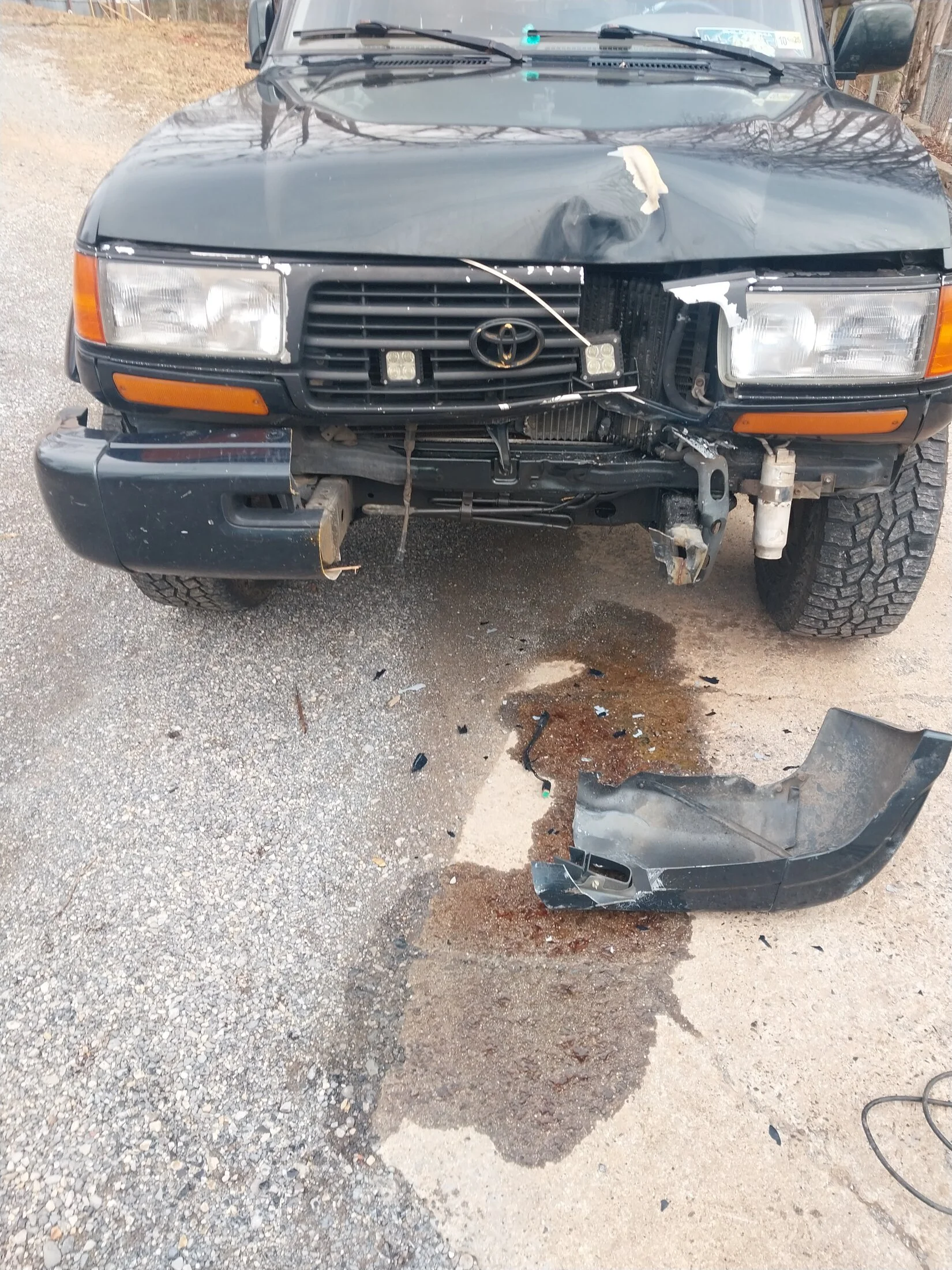

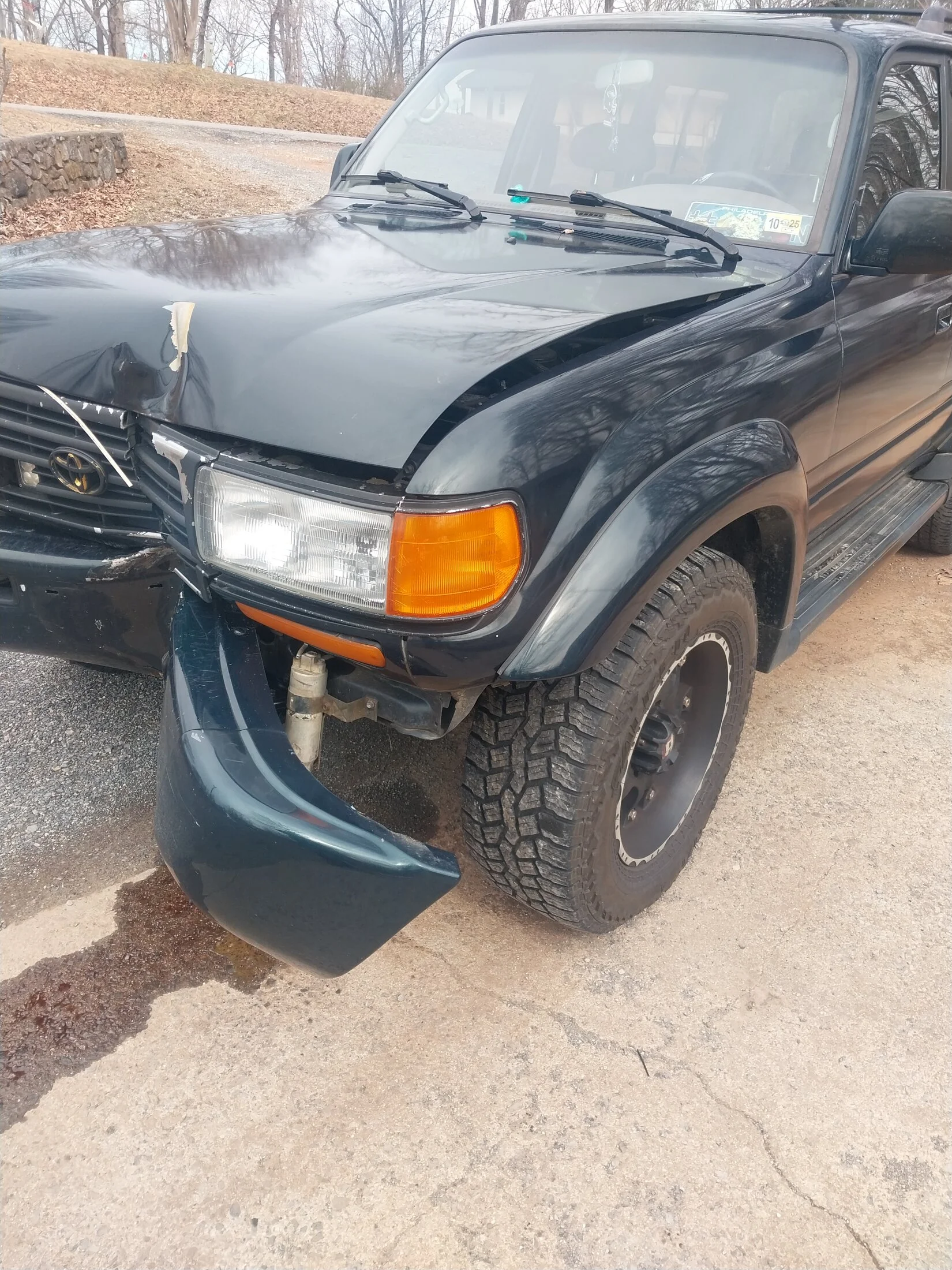

My girl wrecked her 95fzj80 last week. She made it out without a scratch landcruiser took a front end hit. My question is I have a 92 fj80 parts rig core support is good with no rust thought about just pulling the fzj core support back out but if I can I would rather switch it out with the fj80 one. Same thing with the fj80 hood I have one of those too.
Some pictures of it because we all like pictures.
Tommy
I am not sure about the core, I do have a good one from a FZJ if you need it. I know the sheet metal below the grill is not the same or the grill itself has a diff shape. Trans cooler should work. Hood should work, at least I hope, as I just bought a 92 to swap the hood to my 96. I have the frame horn pieces too I think.
I appreciate it man I have most of the parts already. The core looks to be the same just trying to get confirmation parts rig and her 80 are 5 hours away from each other.
