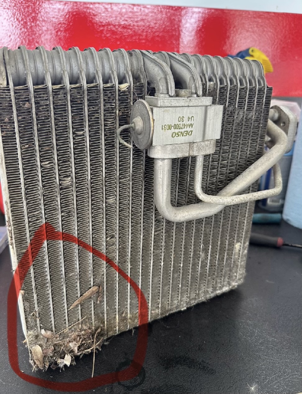

So not wanting to take any chances and busy at work I decided to take it to get the ac sorted out. My compressor was not engaging about at all and I did opt to have the expansion valve replaced and the dryer too (all Denso). Shop called and said my evaporator core was s*** and they couldn’t guarantee my ac would work if they didn’t replace it while it was torn apart. They wanted $350 for a new one 😂😂😂

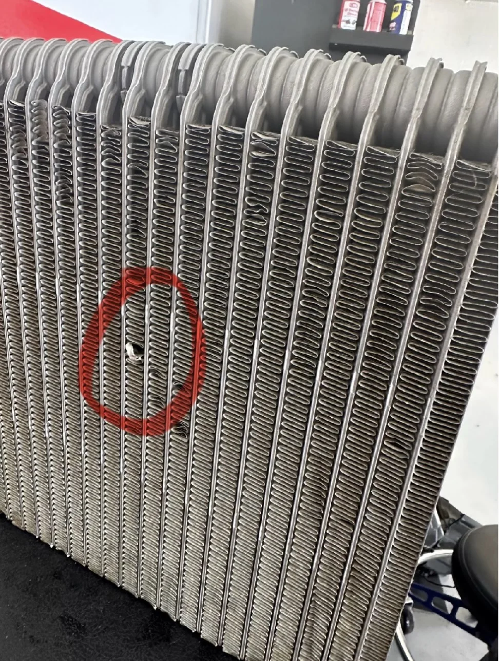

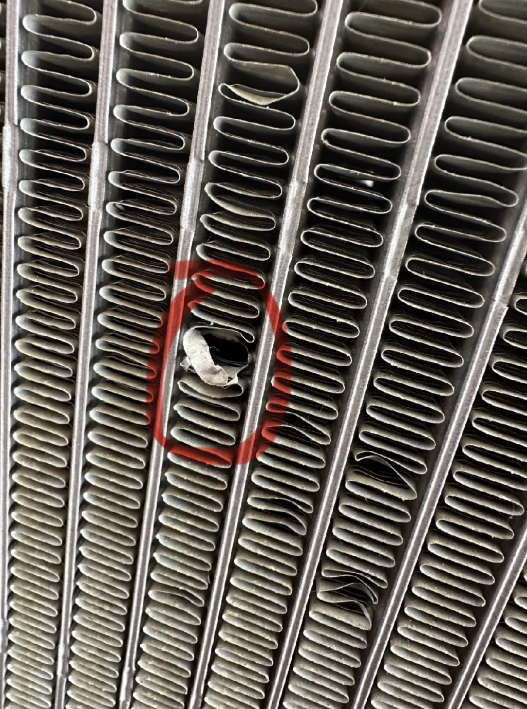

Here’s the pics which don’t look that bad. I told them as it was out, to clean it up and put it back in. Thoughts?
OK? But why do I not see any oil from a leak? They want to replace it because???
Forty years of AC and I can count on one hand how many evaporators I've seen leak that weren't caused by someone damaging it.
Unless you see oil trace indicating a leak, clean it up and run it.
Why would oil leak from an AC evaporator core? Stupid question maybe but I’ve also been told if there’s damage like that it’s likely a leak and Freon is escaping.
Never mind I answered my own question. I get it now. Well the person I spoke to obviously didn’t know what they were talking about and the shop either didn’t or was trying to sell me parts I didn’t need.
Because there is oil mixed with the Freon and it leaves traces when there is a leak.
That's part of the diagnosis.
If your compressor shut the bed and junked itself, it will contaminate the entire system and no amount of flushing will remove the particulate from the evaporator or the condenser and they should be replaced.
If all that happened was your Freon leaked out and it didn't work anymore, then it can be resealed and not have to replace everything.
