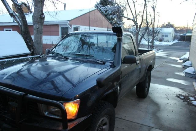

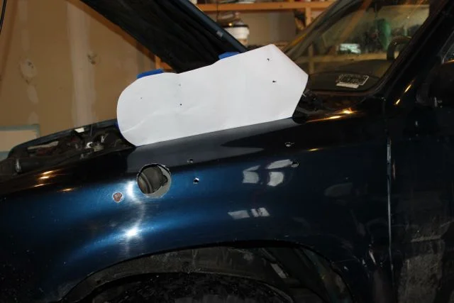

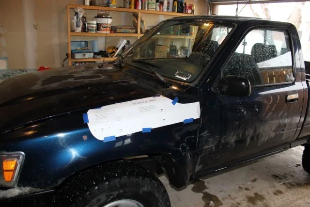

So I treated the faux-lux to a snorkel. I bought one off of ebay, an HDPE snorkel, and I think I got a good deal, but I really wanted to have cleaner air for the filter. My property is up a dirty road, and going up and down it as much as I have been (and will be for the near forseeable future) tells me that a snorkel will help keep my filters cleaner, and bringing in cooler intake air isn't a bad thing at all.
So...
Fitting the template...
No going back now!
All done!
Not bad for an afternoon's work.

that is awsome, what did the half cut cost you back then? I did not see that posted.
Roughly $3K, plus shipping.

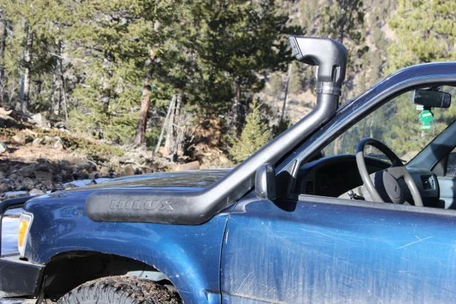

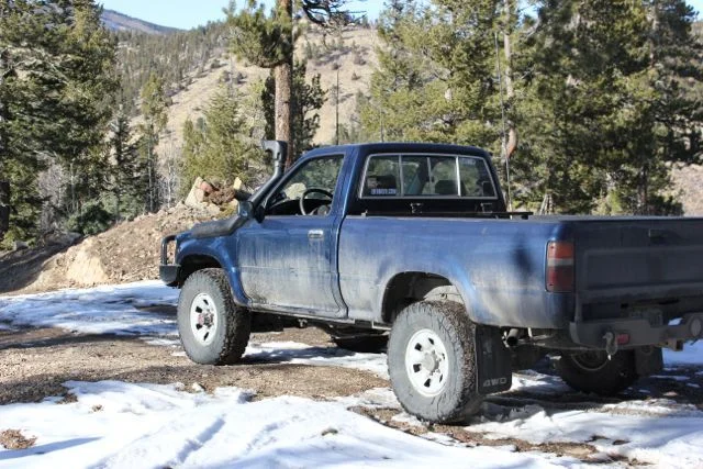

So, with about 100 miles on it now, I want to know why I didn't do this sooner? My EGT's seem to be a solid 50-100 degrees lower with the snorkel!
Will take a while to really give me a good idea on the EGTs, and mileage, but so far I think it's pretty clear that the EGT's are significantly lowered...
A couple of better pics of it today too...

I'd like to get a snorkel for my truck also. Is this what you got?
http://www.ebay.com/itm/1989-1997-T...&fits=Make:Toyota&hash=item565336bfc5&vxp=mtr
It doesn't have the exact same listing as the one I bought, but it's from the same seller, same price, and same description. So I'd say it's safe to say it's the same one.
VERY pleased with it. Took me an afternoon to install it, and much of that time was spent wiping up the snow off of the truck so that I would have a drier surface to work with. Would have been even faster if I would have been in my shop with the plasma cutter, instead of using a file to enlarge the inner fender hole. But either way, that's no beef with the snorkel.
I'm kind of bummed I waited too long to post feedback for them, because they did a great job, and the snorkels (I ordered one for my 60 as well) arrived faster than I could get home to look at them. In fact, I just emailed them to thank them for their service.
