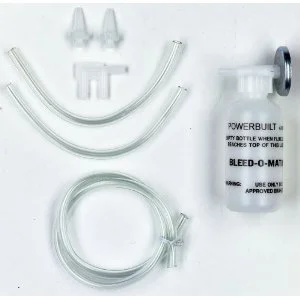

Mine were like that, bled, bled, bled the system and that solved the problem. Even minute air bubbles will make the different between well bled brakes and a lousy brake bleeding job. It took me a good hour to do it, did it alone with one of those $8.00 one man bleeder systems. Cheap but works.

FWIW, I have never had an issue bleeding brakes on my truck using a Snapple bottle and a length of clear tubing. It's a simple system with no ABS. Put a block of wood under the pedal to avoid going to the floor and pump away.

Try the one man bottle, cheap and works if you follow the instructions.:cheers:
