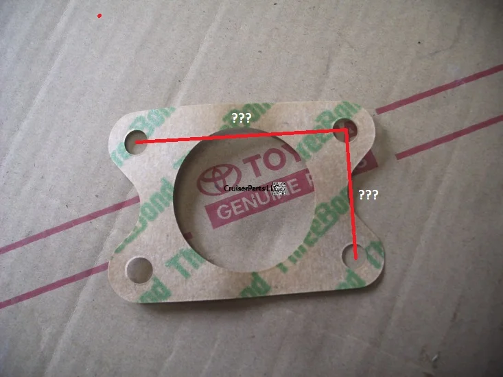

If anyone is available to get these measurements for me today from a 1991 FJ80 that would be sweet! It's the gasket between the MC and booster. Trying to build a spacer at work and I'm not home to check my measurements. Appreciate you!
THANKS IN ADVANCE!!
I just happen to have a MC on my desk, and the hole spacing is 45mm by 75mm. Mine is for a 1994, but the gasket is the same part number for 1990 through 1998.
