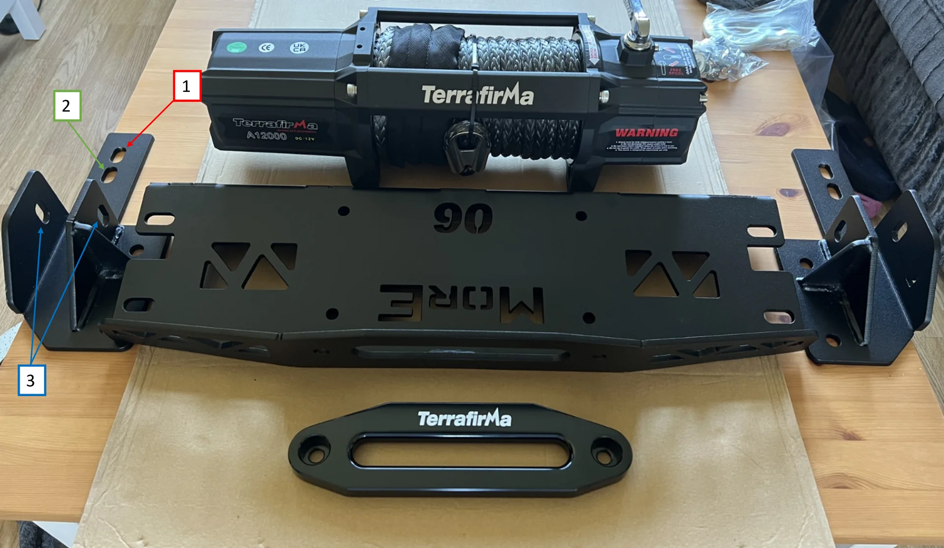

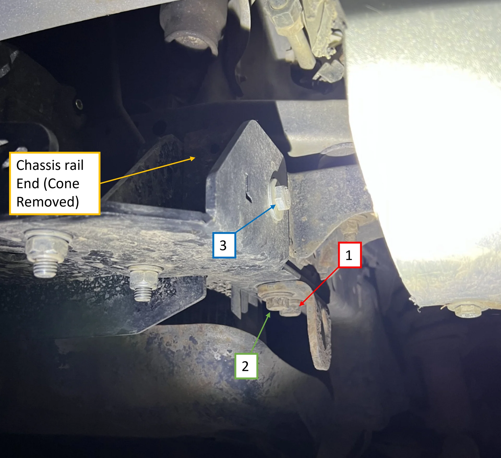

Some day if you think of it could I trouble you for pictures of where the winch mounts to the frame? I think it wants to use the same holes as my bumper but I can’t really tell.
Hi Philip,
Of course, picture not great as taken in the dark. There bolts that hold the brackets on each side are labled 1 2 and 3. Number 1 goes right through the chassis rail (I had to drill these but he said some already have them). 1 and 2 use the mouting where the tow hooks normally are.
Let me know if anything else is usefull, only recently fitted it so all fresh in my mind.
