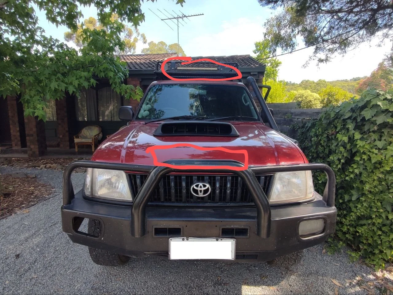

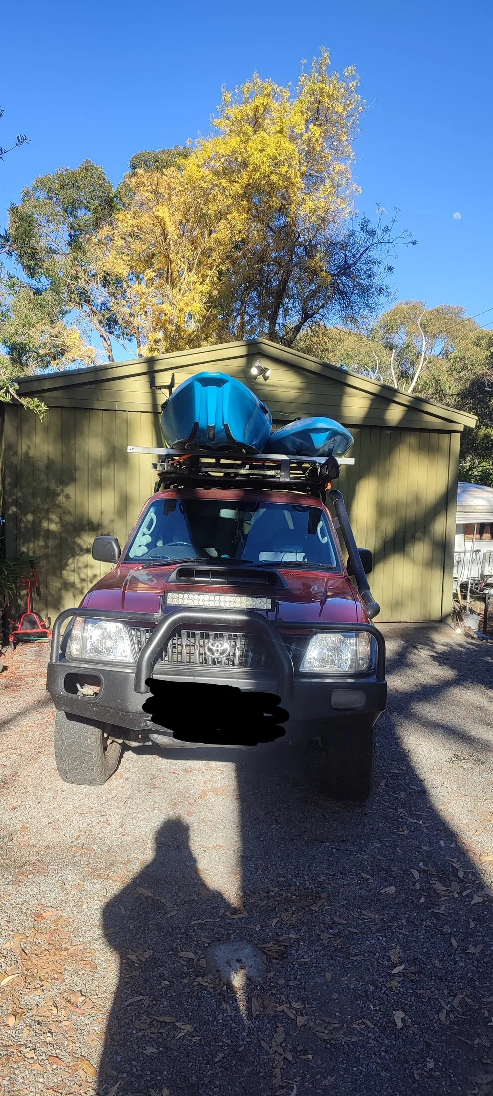

I'm on holiday so don't have access to a pic right now but i've edited one I do have of my old Prado to show what I did. Basically chunky light bar on top of the bull bar, keeping free air flow in the center hoop. This light was the same length as the center hoop so aesthetically looked awesome (IMO). Then a second light bar up on the roof cage as circled. I'll try and find a pic showing the BB light. Their might be one buried in my phone. To be honest, this light system was fantastic for lighting up the immediate area but it needed a couple of long throw lights in there for 100km/h night driving on country roads (which I do a lot of) as you couldn't see far enough ahead for kangaroos etc on the sides of the road.
I've still got some experimenting to do with my new car light setup but I think I've changed my tune on whether to place spot lamps in the center hoop blocking air flow to the radiator. While troubleshooting on going over heating issues with the old 1KZ Prado, I wonder if I over reacted with removing the front spot lights from the standard location center hoop of the BB? I never actually tested the theory. Once I got the cooling system renewed, I wonder if the spot lights do make that much of a difference to cooling of they could have stayed? Anyone have any real life data on this? I'd be keen to know for my new car 👍
