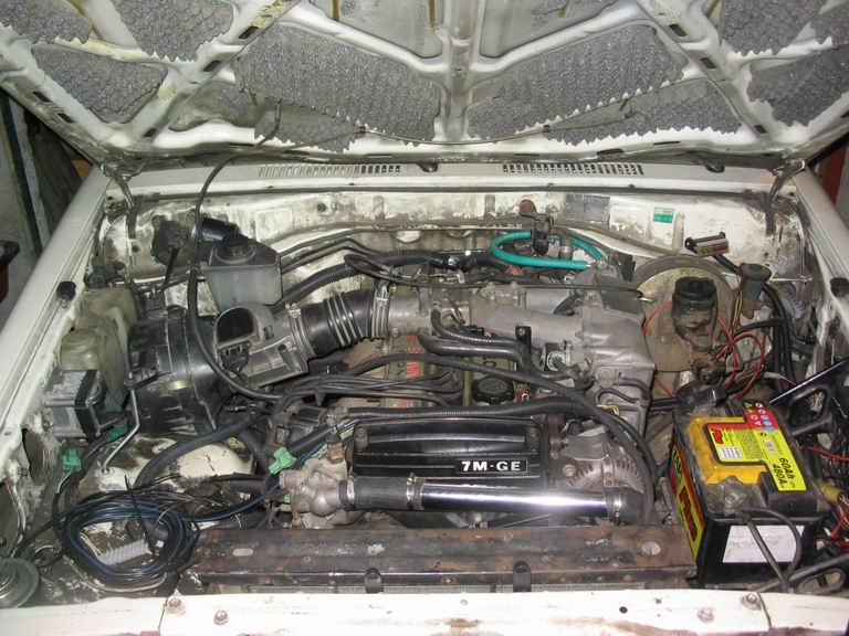

One LJ70 with 7M-GE builded at Finland, can´t remember was there Volvos portal axles also.
