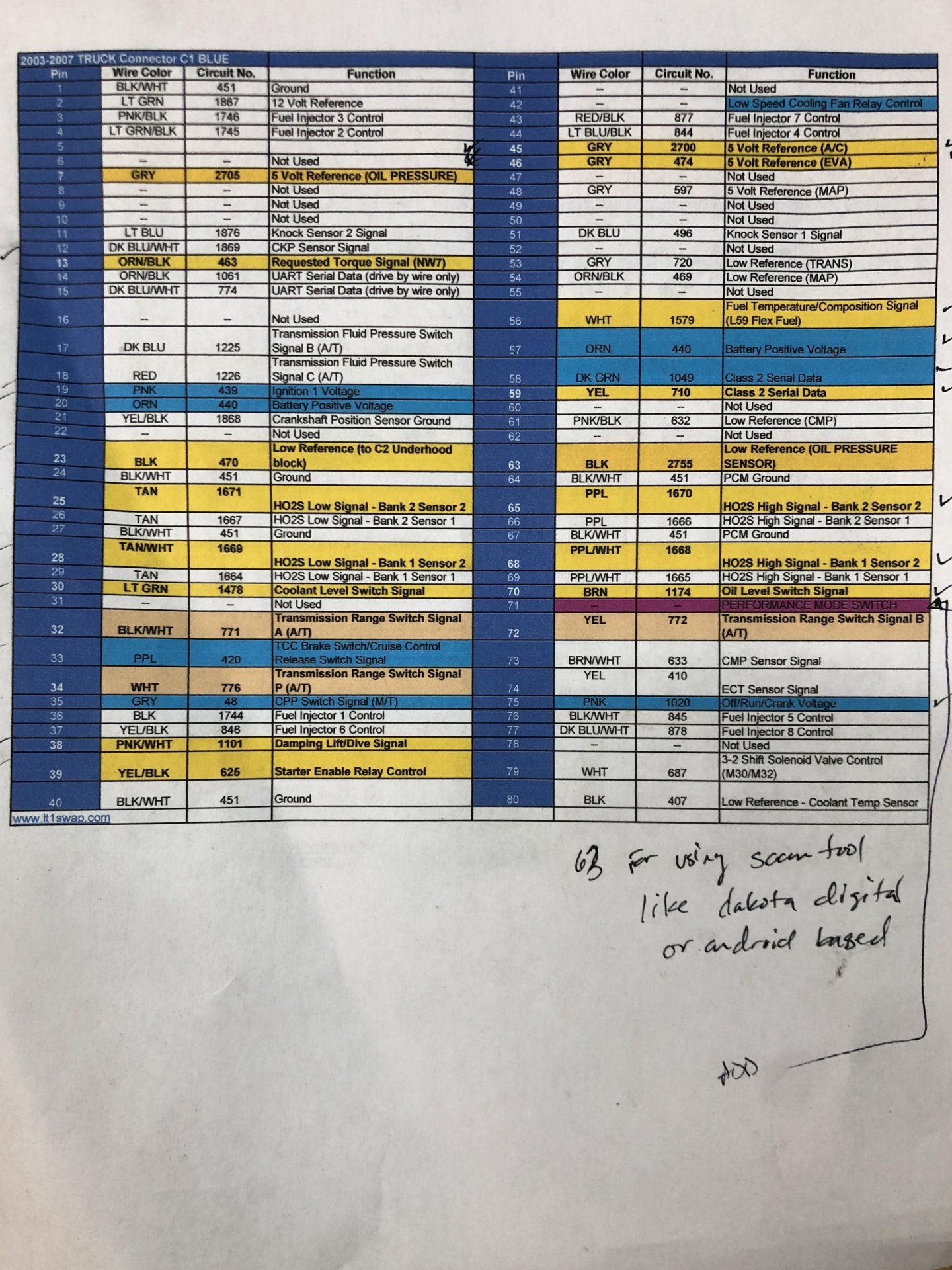

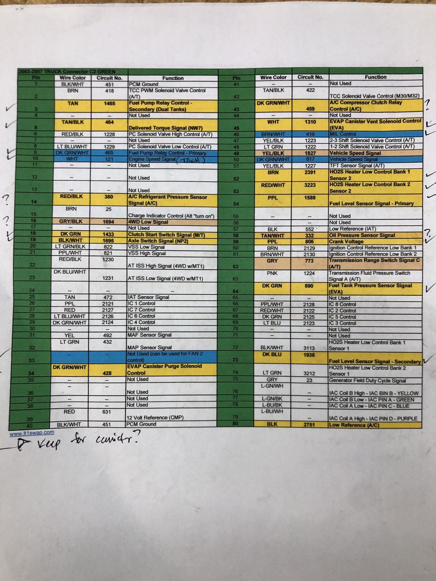

speaking of which got a quick question... started to work on my harness again since it’s a rainy day here in Texas... but going of LT1swap site for the pin out he talks about removing the ac connections.. in our setup we’re using them right to run ac?
Use:
pin 43 on the green which is AC compressor clutch relay
Not using:
Pin 14 AC refrigerant pressure sensor
Pin 80 Low reverence AC
Use:
Not using:
View attachment 2383546View attachment 2383548
Right now I'm just using the wire off of the toyota harness for engaging the ac compressor. It works but the idle dips momentarily. Trying to figure out how to use the gm ecu more for that.
Ok so using the gm ac connector but wired to the Toyota harness to engage the ac compressor.
I haven’t removed the ac wires yet from the ecu. I think I’ll leave the wires there until it can be figured out how to control it via PCM however I have a 2004 so it uses the HVAC to control the ac. I saw a post that rockrod had an idea to use the hvac control and just mount it behind the dash but it would be controlling the idle up and memory I’ll leave the wires there but not connected for now and just use the Toyota harness.

I was at Tanner 4x4 in Colorado Springs last week. They were doing an LS swap on an 80 at the time. Looked good! And Pete said they connect all the functions like the cruise control and AC idle up. Might be closer for you.
all i did hooked wire from old toyota a/c clutch to gm clutch flushed all R12 stuff and filled the system with r134 Freon and some PAG oil with no problems with idle and inside cab is like fridge when a/c is on
