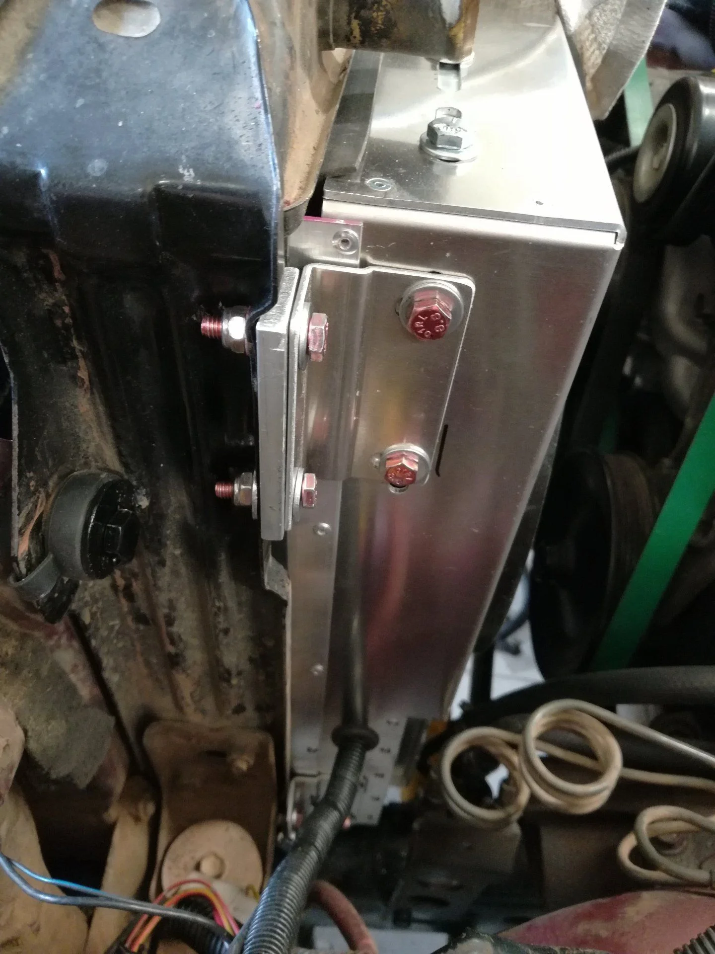

Here's a couple shots of the new oe radiator and Derale fan setup. I looked through their differents shrouded fans and found #16838 to be a perfect fit

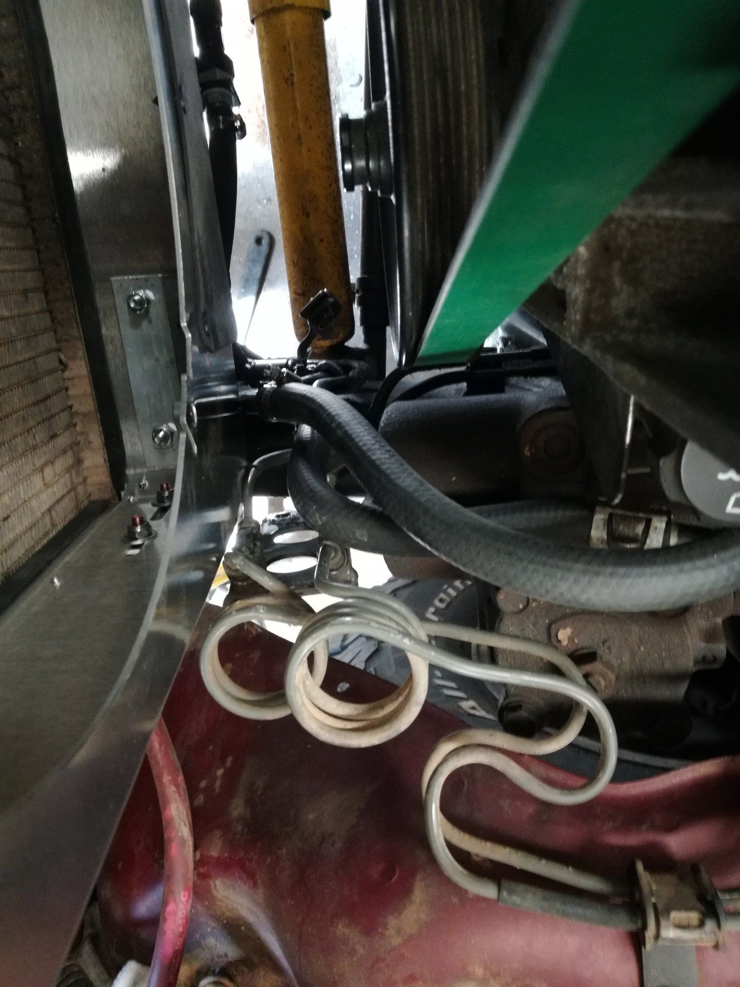

Hey, did you have any clearance problems with this setup? Mine interferes with the brake lines where they come down from the fender to the frame on the DS. Trying to figure out how to handle it. Pic is with the brake line bracket unbolted and shoved about as far as it can g ... and it's still against.

Well, I made it fit.

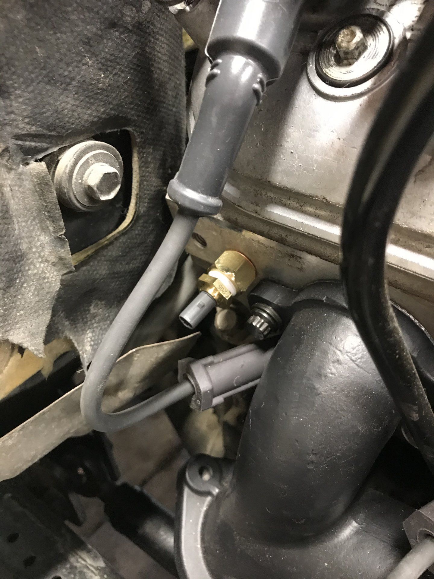

I’m having trouble figuring out what tap I need to do the oil pressure sending unit on that piece on the drivers side of the oil pan.

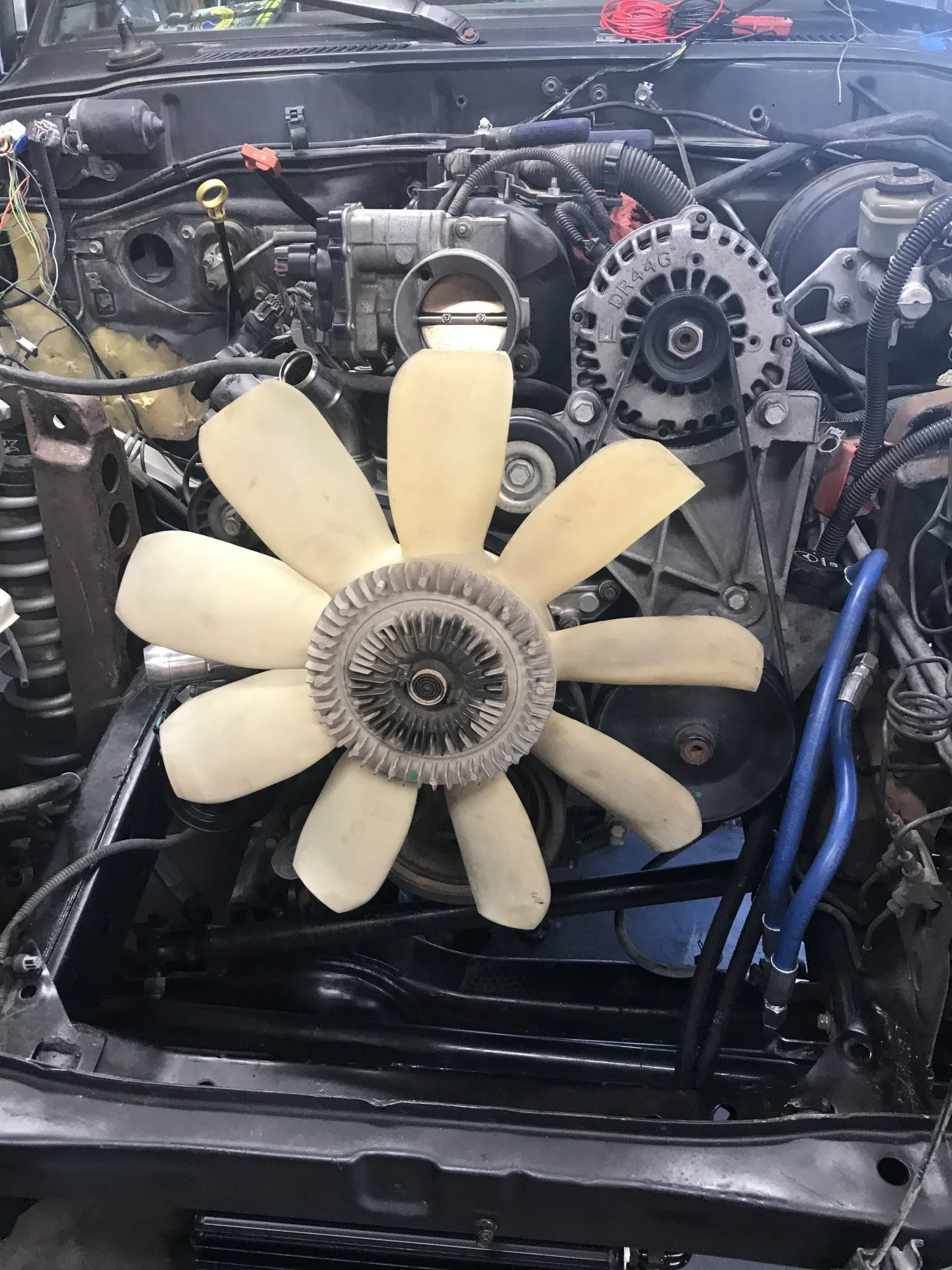

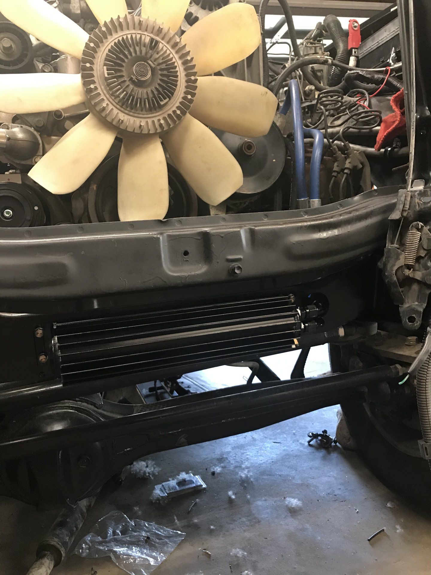

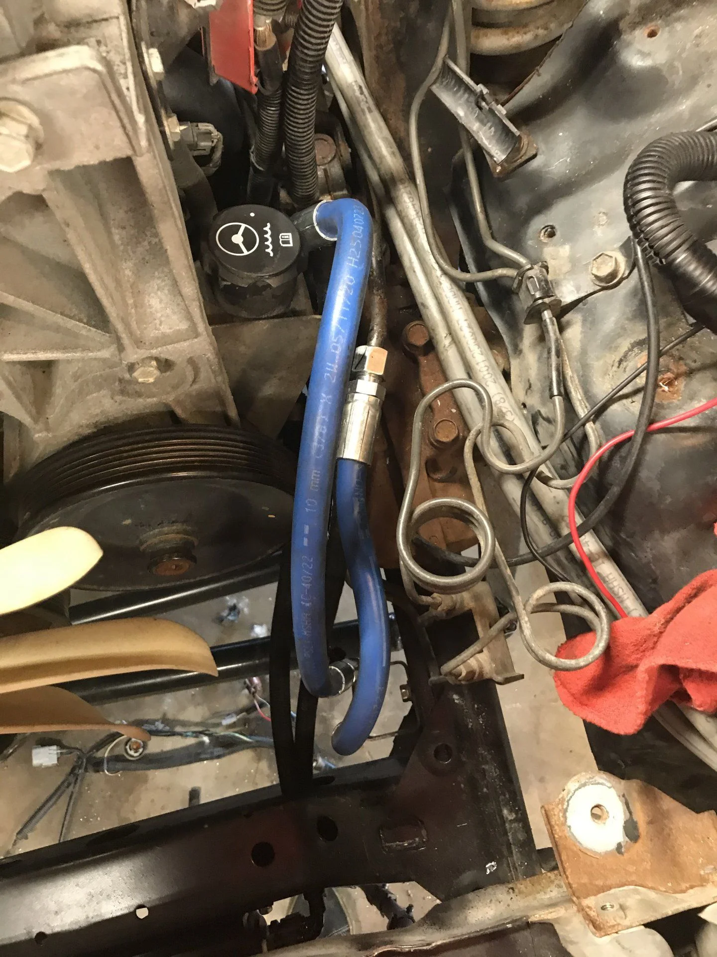

You’re not cooling the PS fluid in any way? Looks like you have a leftover cooler there that’s unused.
Tight for on the corner of the engine there.
The black finned cylinder is the power steering cooler.

on 1991 land cruiser oil pressure sensor thread is 1/8" BSPT ( BRITISH STANDARD PIPE TAPER ) but i do not know on others , it may be same
if you goo on the bottom and last page 2007 5.3L ls in 1991 80 series you can se how i did some parts for shiftier i used toyota sifter and all other parts r GM , cable is from trailblazer
that's what i've been seeing. thanks

It's the Derale 16838
Fits the radiator nearly perfect. I riveted some small skirts to the side to contain the airflow. Mounting brackets can be drilled through the flange on the radiator - i made some 1/4" Al blocks for where the flange dips in at the top.
The problem is that it a bit to deep on the DS bottom corner and interferes with the brake line. Had to chop it out and bend up some sheet metal to patch it back up.

Now that it's mounted, I'm thinking that maybe a cleaner approach would've been to cut 1/2" to 5/8" off the entire thing. It's going to be tight on the intake up top as well, and that would help.
