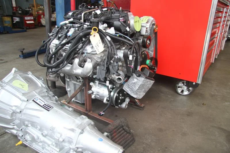

I have been following different threads of engine swaps and decided to pull the trigger and get my done...
After a long time sourcing and looking for the best deal, I am set on swapping the complete power train to a GM. I will be keeping my stock shifter and transfer case... that is it!
I will be very please with your feedback and input during the process.
I will not be doing the work myself since I do not have the necessary equipment to make it happen, and my mechanic skills are not to the level required to succeed on this venture.
My good friend Hoang Ly from Mopar Alternatives in Murrieta, California will be doing all the work.
I already have a 6.0 Vortec with 70k miles and a matching 4L60E transmission. We are using a Marks adapter to the stock transfer case, motor mounts, and other brackets from Marks, and the computer and wiring from Howell...

I will post a complete list of what we are using and start posting pictures and video...
