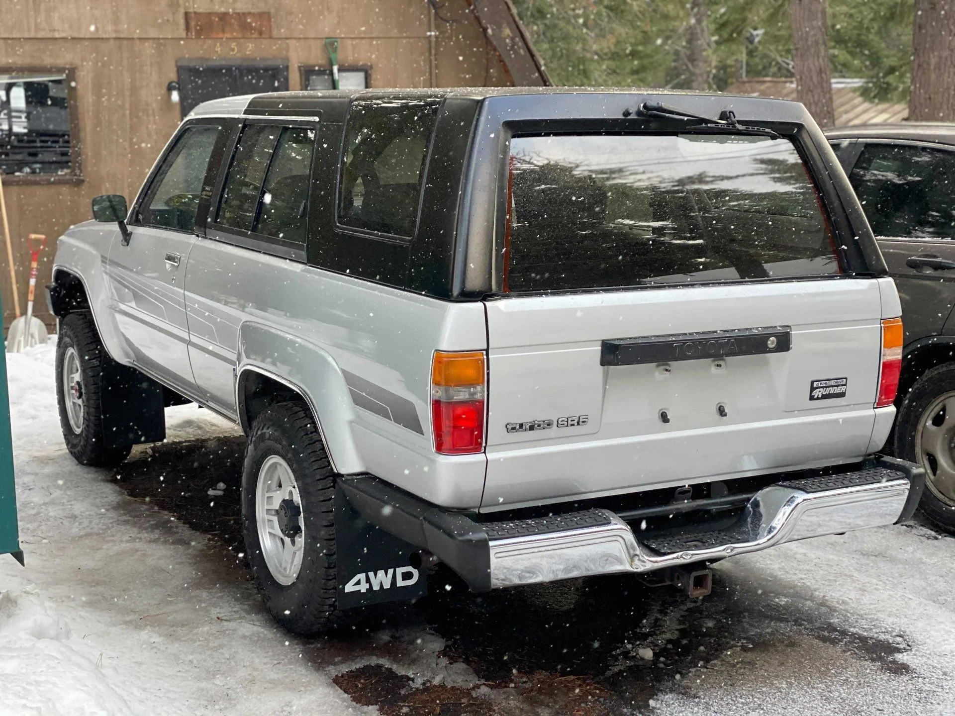

Hey guys, quick question for you all. Just picked up an '86 4runner and am looking for advice on how large I can go when I get new tires for it. I'm upgrading the suspension - 2.25" OME rear leafs with add-a-leaf and nitrochargers all around, but wont be doing any body lift or anything else. Running this upgrade with the OEM 15"x7" wheels, how large can I go on new tires without rubbing/problems? I'm going to be getting K02's if it makes any difference. On a seperate note... if anyone is looking for 30x9.5 falken wildpeaks in norcal, im your guy 😂

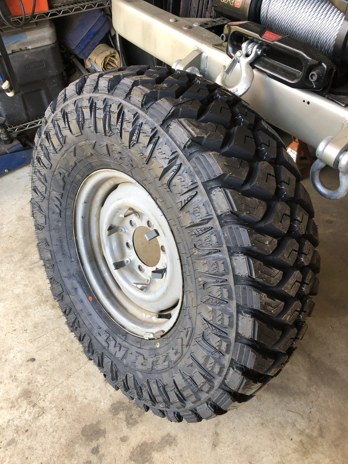

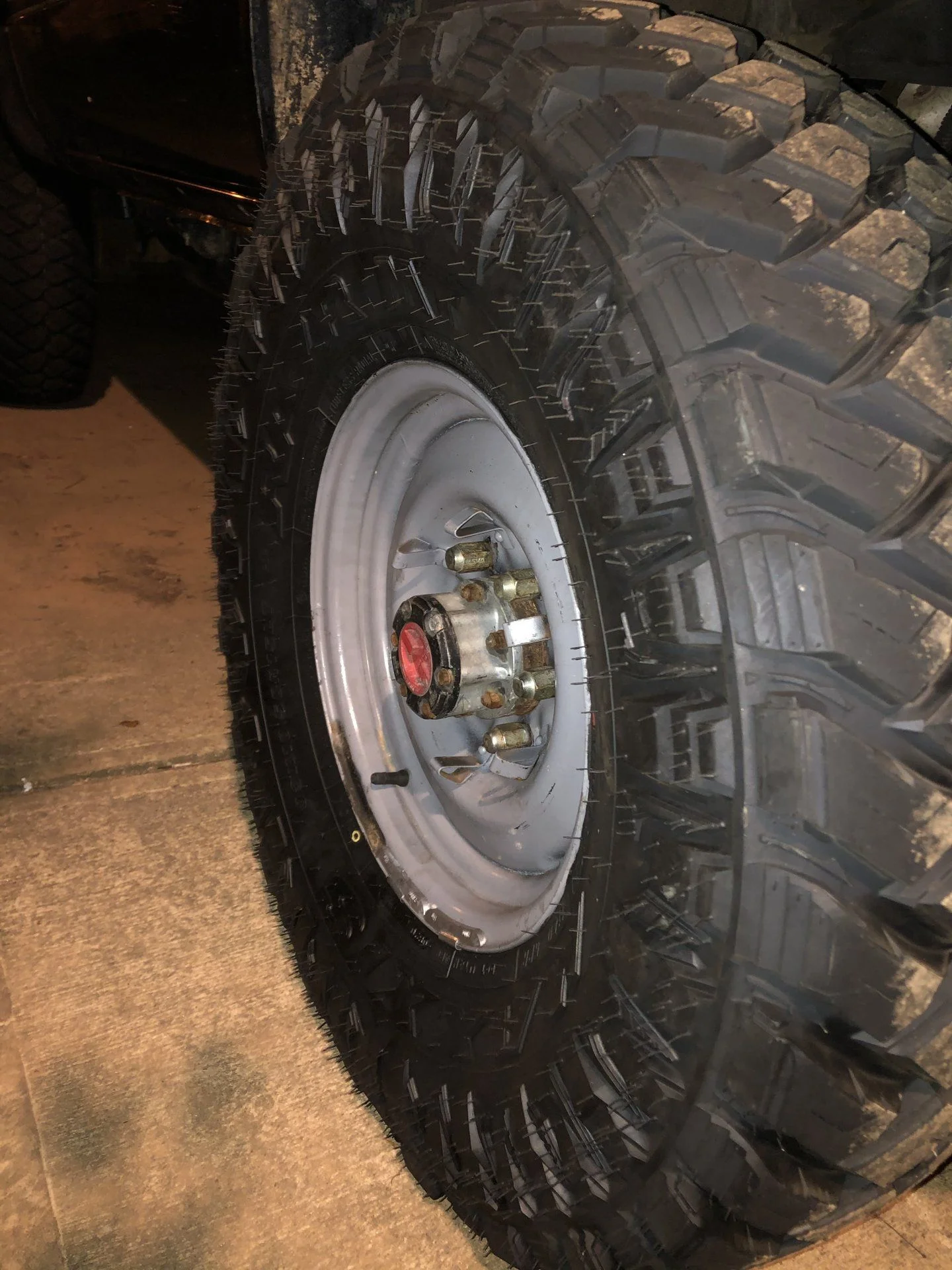

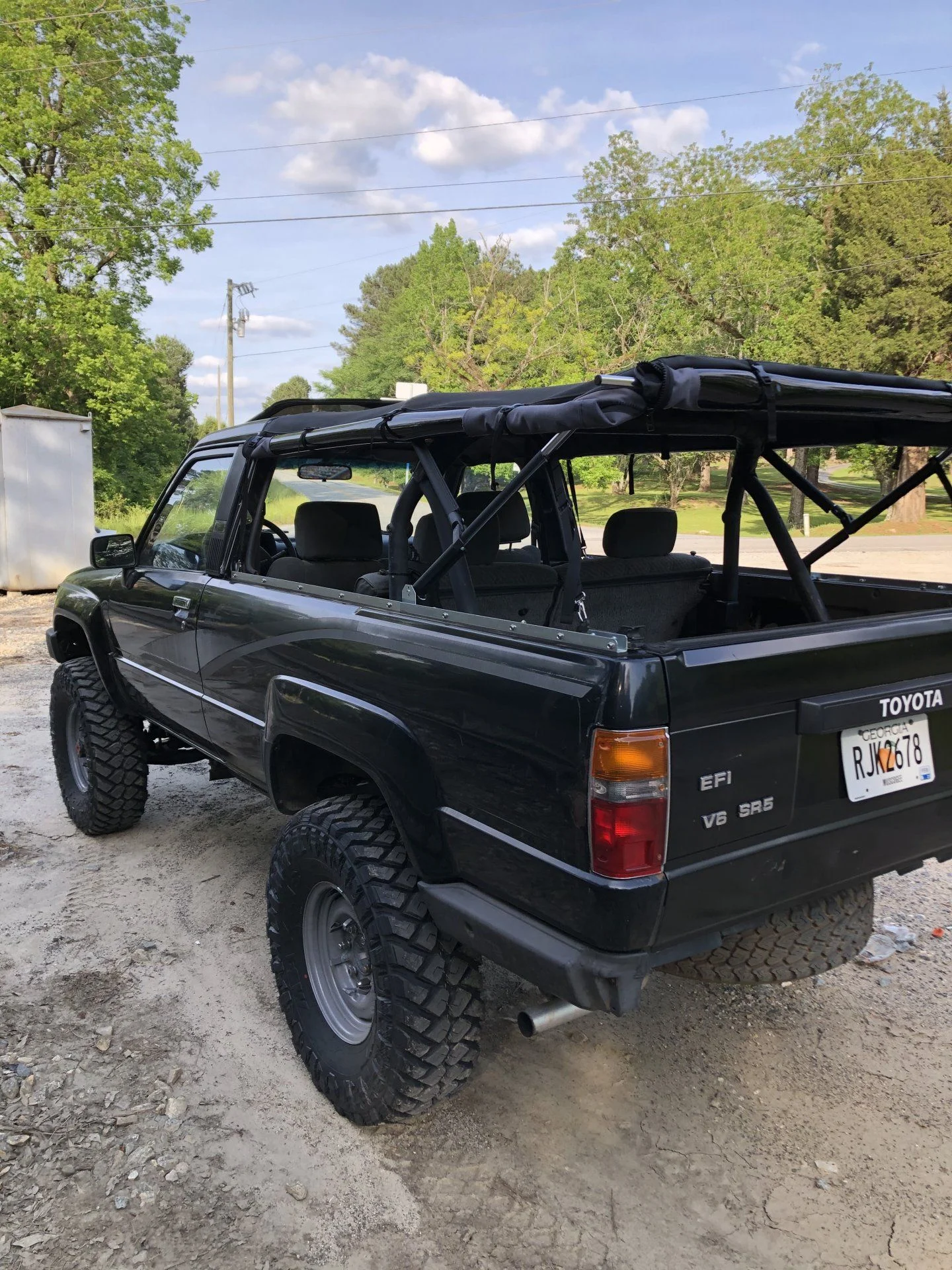

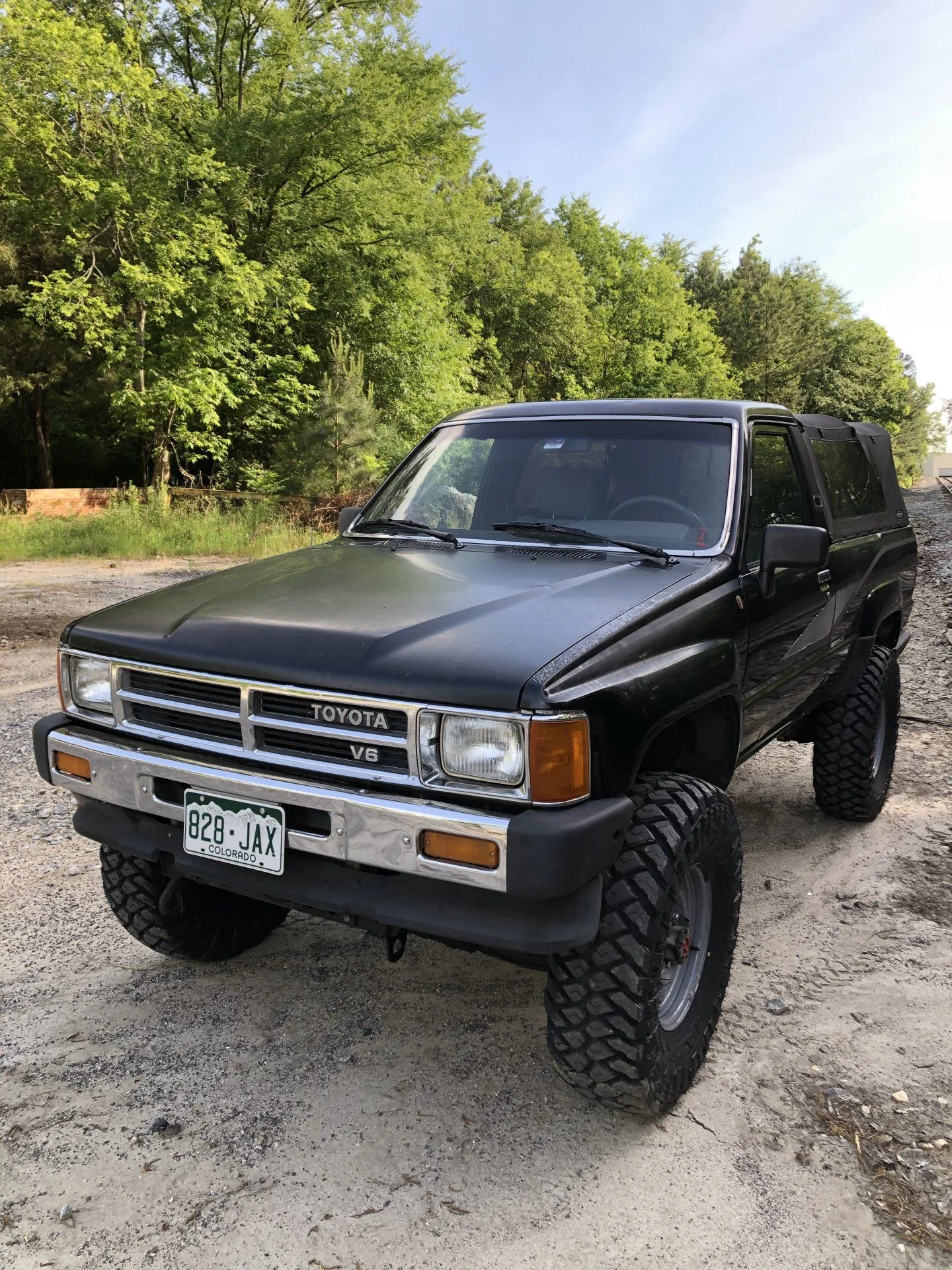

33x10.50R5 Maxxis Razr on 1989 with 2” BL and stock suspension.
Truck didn’t have flaps when I got it. Zero rubbing in any configuration. Stock Land Cruiser wheels are 5.5” wide.

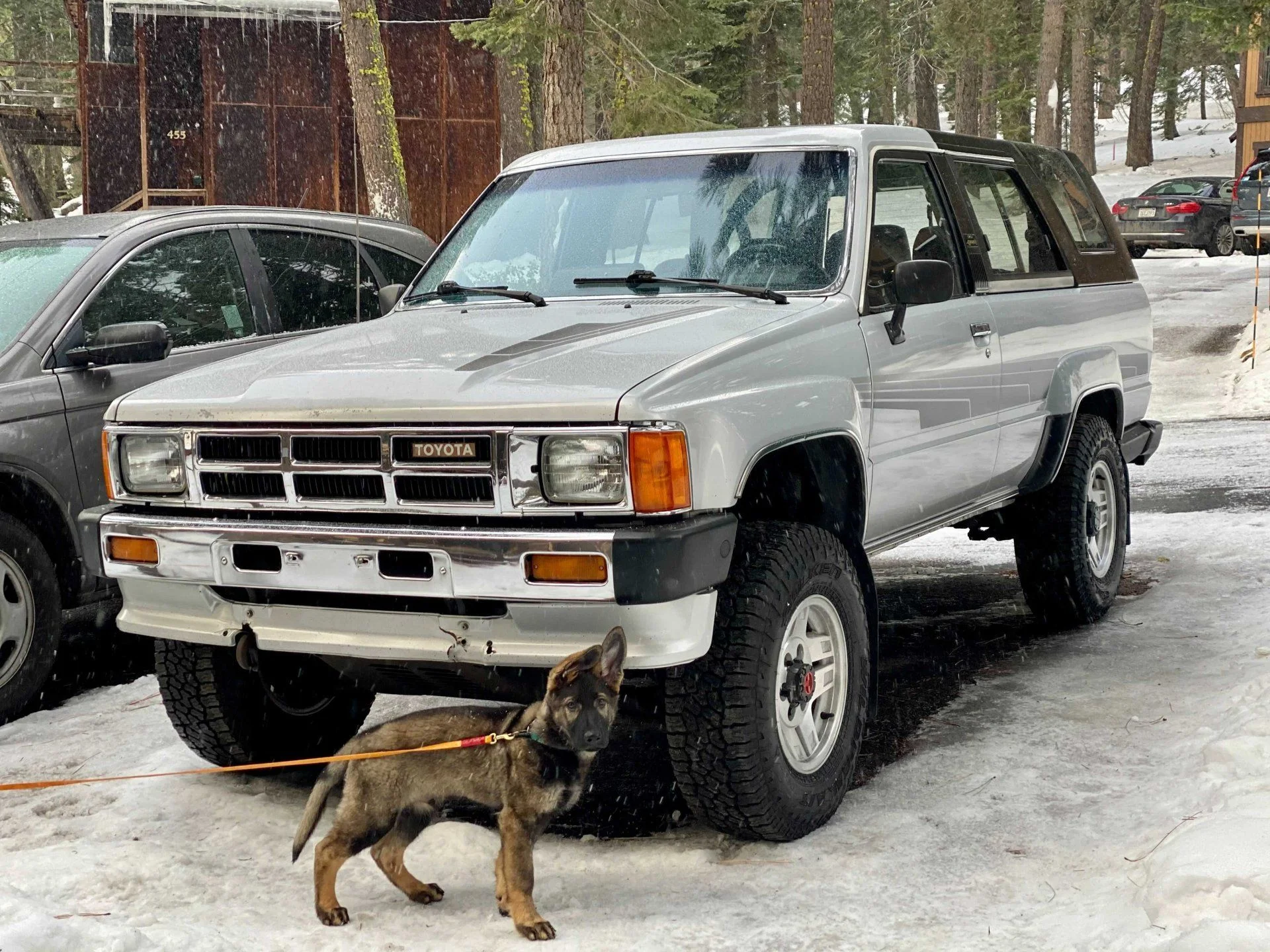

I've got 31-10.50's on the same wheels as yours. I am running Roger Brown BJ spacers up front, t-bars set to stock ride height, and OME rear springs that still need one more short leaf removed. the only rubbing that I've had was from a serious g-out, in the dark, in the middle of the Carrizo Plain, due to some PO cutting off the rear bump-stop landing pads.
Once I find a narrow 16" alloy wheel that I like and that have a near stock offset I plan to move to 235/85R16's (32" pizza cutters).
