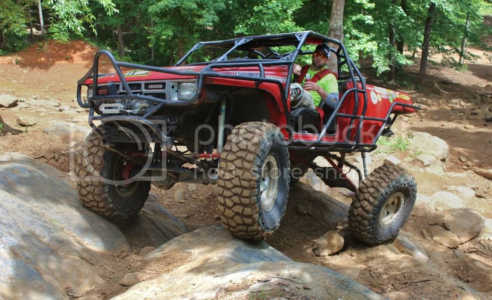

Sheared 6 arp studs and the 2 dowels off of my driver's side front FJ80 axle hub/drive flange last weekend at The Great American Park in Auburn, AL.
Need another hub, as these hard-ass ARP studs are not easily drilled for use of an Easy Out to extract them, plus the hub body itself is a little mangled around the holes. I think a guy I wheel with may have a hub I'll be able to acquire, but won't know til we look at it Sunday.
1st question: What is the going price if any of you have or know of where to get a used FJ80 hub. Would like to know just a ballpark price, as I've never had to repair anything on my front axle under my ownership of the truck.
2nd question: I've asked around and done a little bit of research and have just about decided to drill out/tap the 6 stud holes to 3/8" and use fine thread cap bolts to bolt the drive flange to the hub body. Anyone else tried this? Success stories? I obviously know I'm able to break the ARP's and those are the strongest studs available, so I figure the only way to get stronger is to go bigger and go with bolts for more clamping force than the original cone washer setup. Pics below...

I'm not sure what the specs of your 4runner is, but if ARP studs are gonna break, dual cases and 39" stickies are the recipe for it. If you aren't having any issues breaking factory studs, I would assume ARP's would be overkill for your set up and a waste of money.
