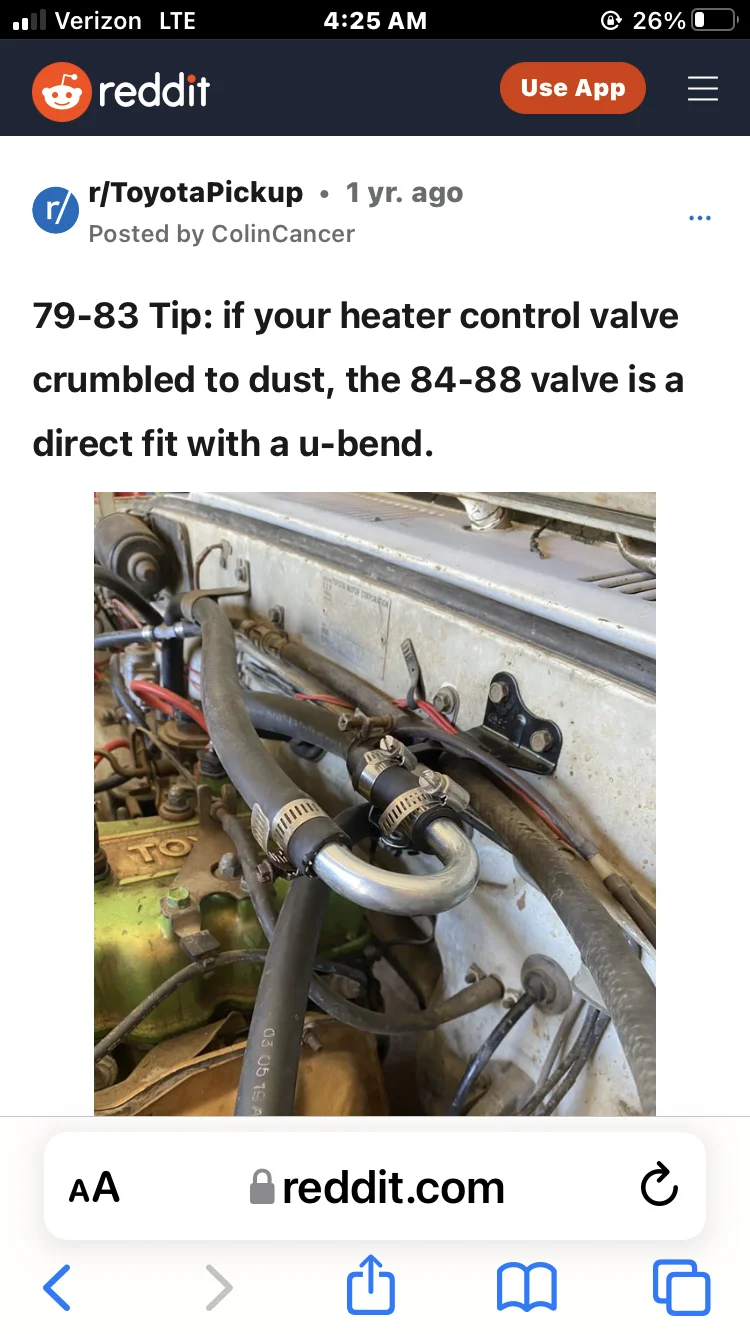

Just got my 82 up and running. Replaced all heater lines and now my heater valve is leaking. Are these NLA? Anybody find a substitute?
Thanks
They're unobtanium. I've tried finding anyone at all that sells a replacement. The later model trucks use a very similar valve but the output on the bottom faces the wrong way.
I found this and I think I’m going to try it.
