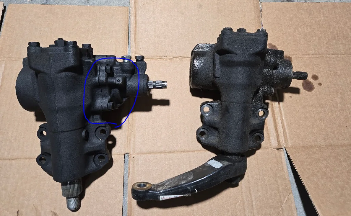

I have the TT coil suspension and I know several of you that have this same suspension and have also installed an 80 series box with it.
I thought this would bolt right up but I'm at least 3/4" away from the holes and already hitting the shock tower. What magic are you guys doing to get these to work together? @dbbowen How did yours go? @TRAIL TAILOR any advice?

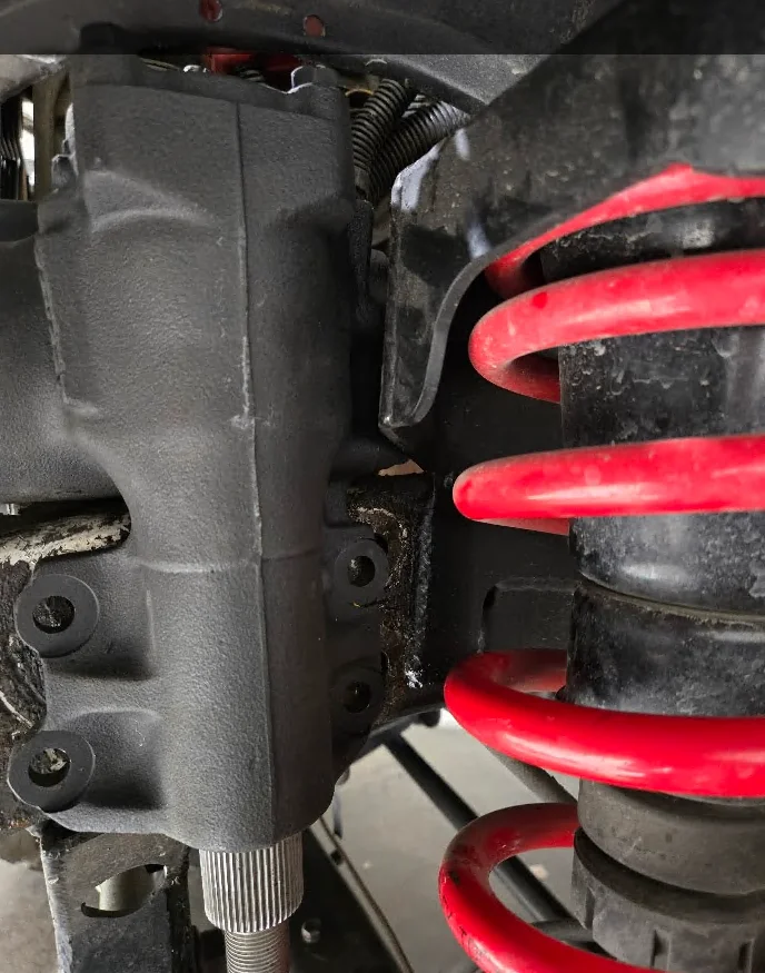

I used a flap disc to basically trim out the leading corner of the coil bucket until it fit. Its easy to cut too much so i feel like slowly removing with a flap disc is the move
