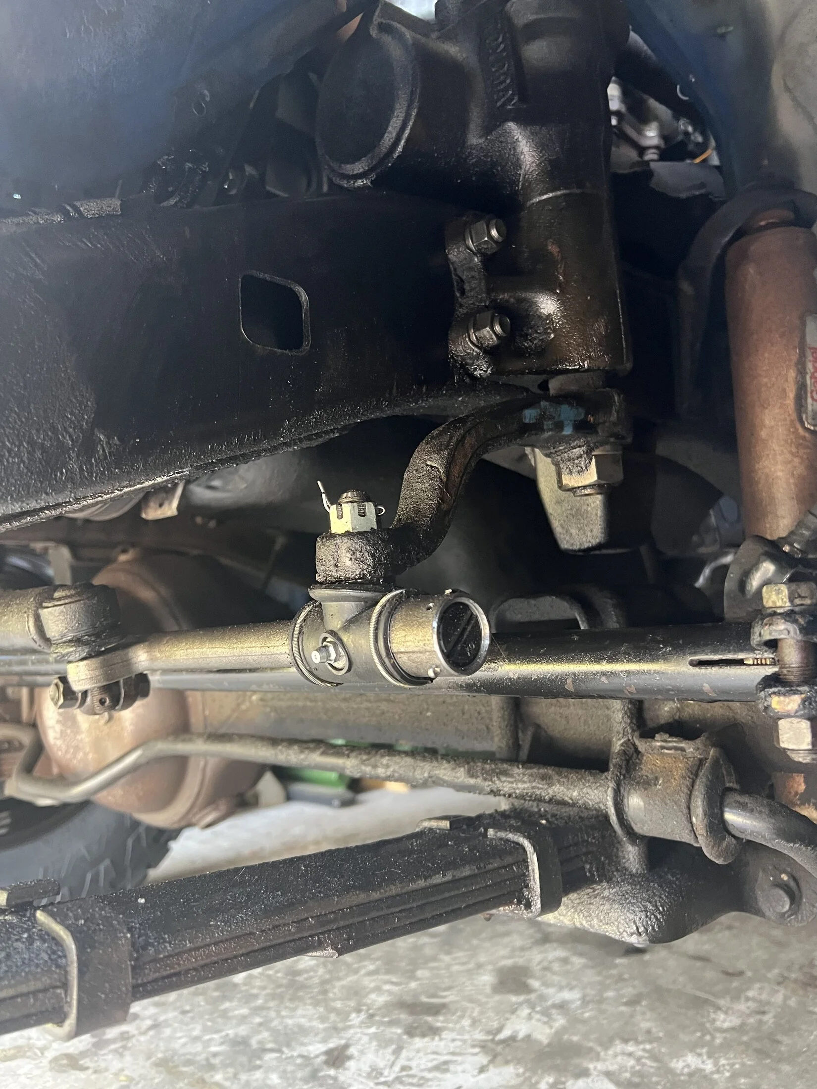

In anticipation of upgrading I bought a Pittman arm for the 105 sector shaft reamed out for a 60 drag link end. (Picture below)
My issue is there’s no drop on the new pitman arm where as my old stock arm has what looks like a 3” drop.
I’m thinking the drag link will still clear but will it mess the geometry of the steering up?
Will it be effected even more after the lift?
Whose upgraded before and if you have did you have to change to a longer drag link rod or what pitman arm did you use?
Thanks for the help ahead of time everyone. I just want to get it right before dropping this much money. Also want to have all the right parts ready to minimize downtime.

80 pitman arm will work fine on a 60. Yes, you will just a few more degrees of relay rod angle, and yes more with a lift. with proper alignment and caster it isn't a serious deal.
If you want it to be *perfect* with a basic 2.5-3" lift, 4x4labs and FROR make "mid-steer" steering arms, but very very few end up going to those lengths.
