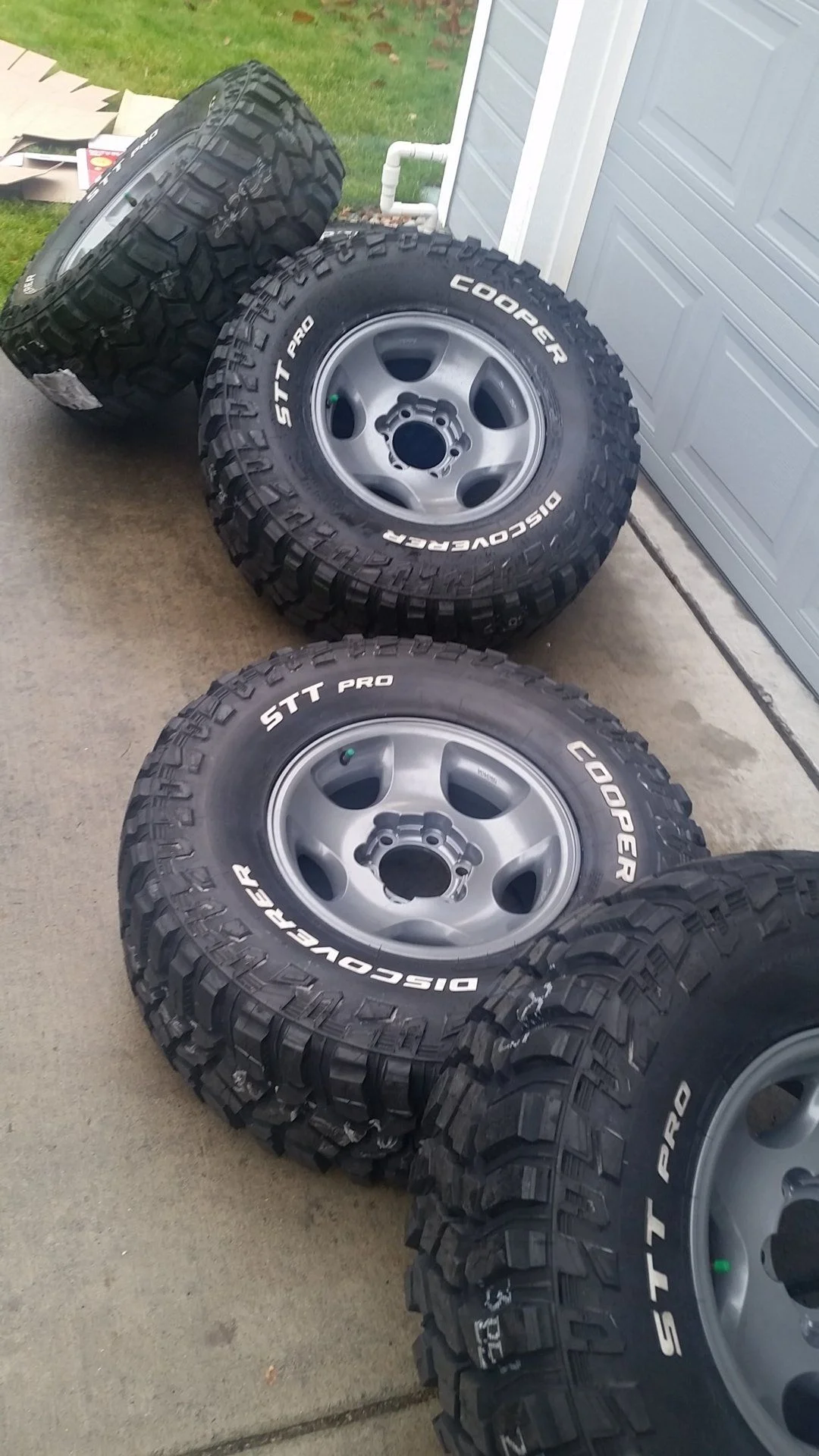

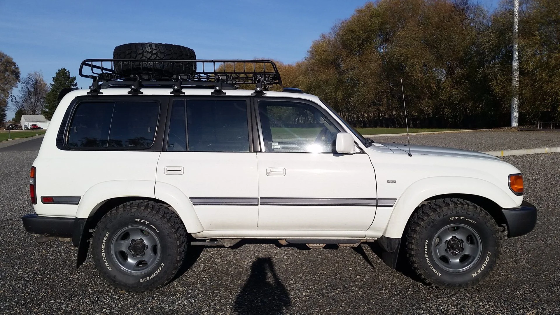

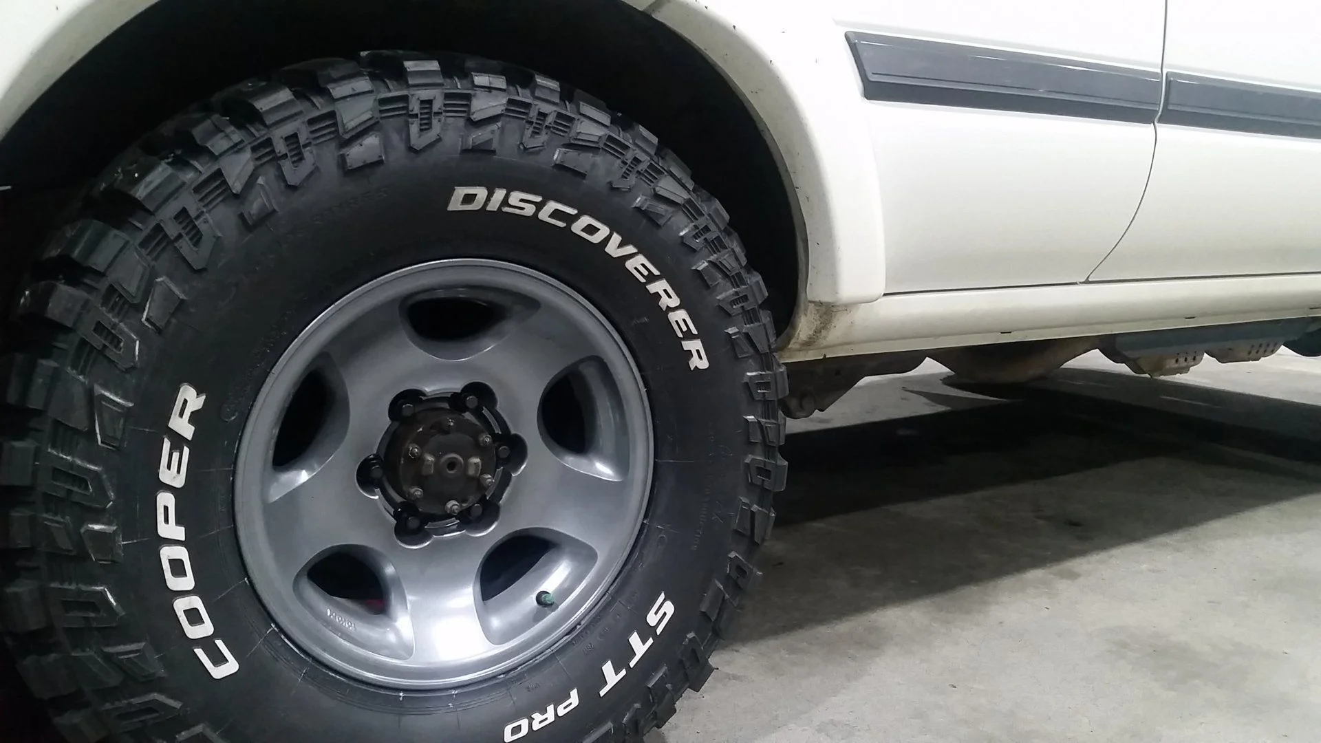

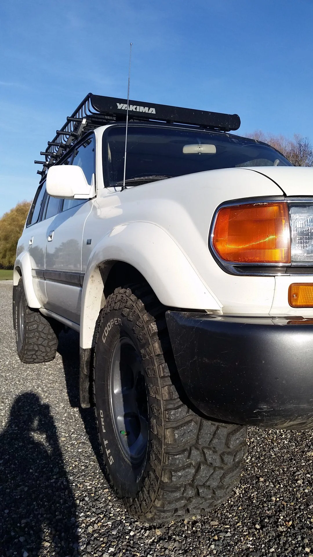

Here are a few pics of what I settled on. The color was chosen to match the trim on my Collectors Edition.

Is the suspension stock height? Do you have a profile picture of your truck you can share. I'm a newbie looking for a set of tires too and can't decide on size. The powder coating looks nice.
Yes, my truck is stock height. It has the original springs and Rancho 5000 shocks. I do plan to do a 2-3" lift, but no more than that. At stock height my 305/70r16s fill the wheel wells nicely and do not rub at all, even off-road. I would expect the 285/75r16 to be very similar, just a little more narrow. Here are a couple photos I just took. I hope they help.

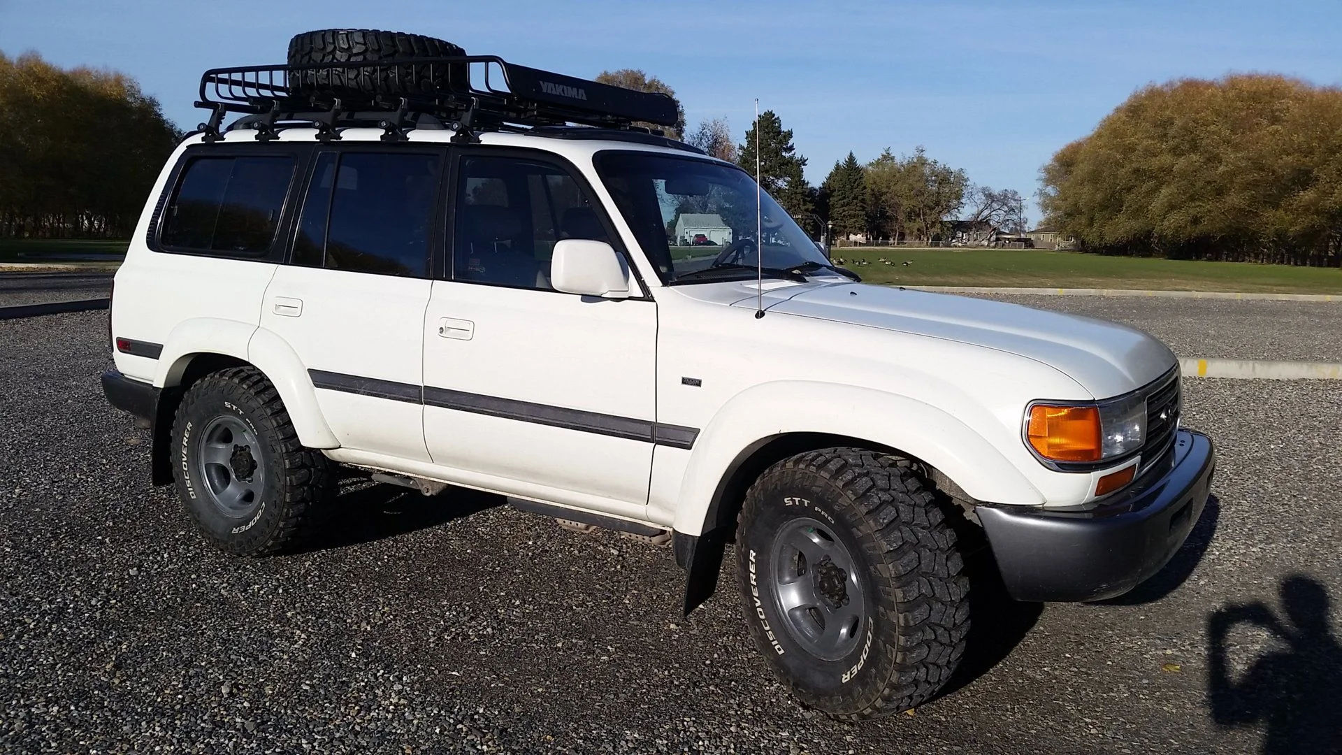

View attachment 1576804 View attachment 1576806 View attachment 1576807
Cheese and crackers that's a lot of crossbars on that roof rack. What are you planning on putting up there?
Ps wheels look good.
Haha... I've been meaning to start a thread on the rack.
People claim that the Yakima & Thule gear is too lightweight for serious use, but then in the next breath say you should never put more than a couple hundred pounds on top.
I tend to agree that it's a good idea to keep the weight on the roof to a minimum, but I wanted somewhere to put my spare in the meantime until I get a rear bumper with a swing out.
At this point there are a lot of Yakima A1 Towers in circulation, and relatively few cars still on the road that use them. Used towers can be found in good condition for next to nothing. I intended to use four bars, but one of the sellers I bought from had 3 bars and six towers. I figure if 4 is good then 5 is better. :flipoff2: I bought the basket and extension new during a labor day sale and Yakima CS sent me the extra basket brackets for a great price.
For all I'm into it, I may have been able to buy the small Baja rack, but that would be harder to sell if I decide to go to a rooftop tent one day. The great thing about the Yakima stuff is it's modularity. I can mount my bike trays, ski racks, and cargo box on to the megawarrior basket, and if I ever decide to sell it it'll be a lot easier to sell to someone with a Yukon, Suburban or other large rig.
To answer your initial question, I travel with the wife, 3 kids, and three kids worth of stuff. I've only had the rack for about 2 months, but I expect we'll put a lot of different things up there in the coming years.

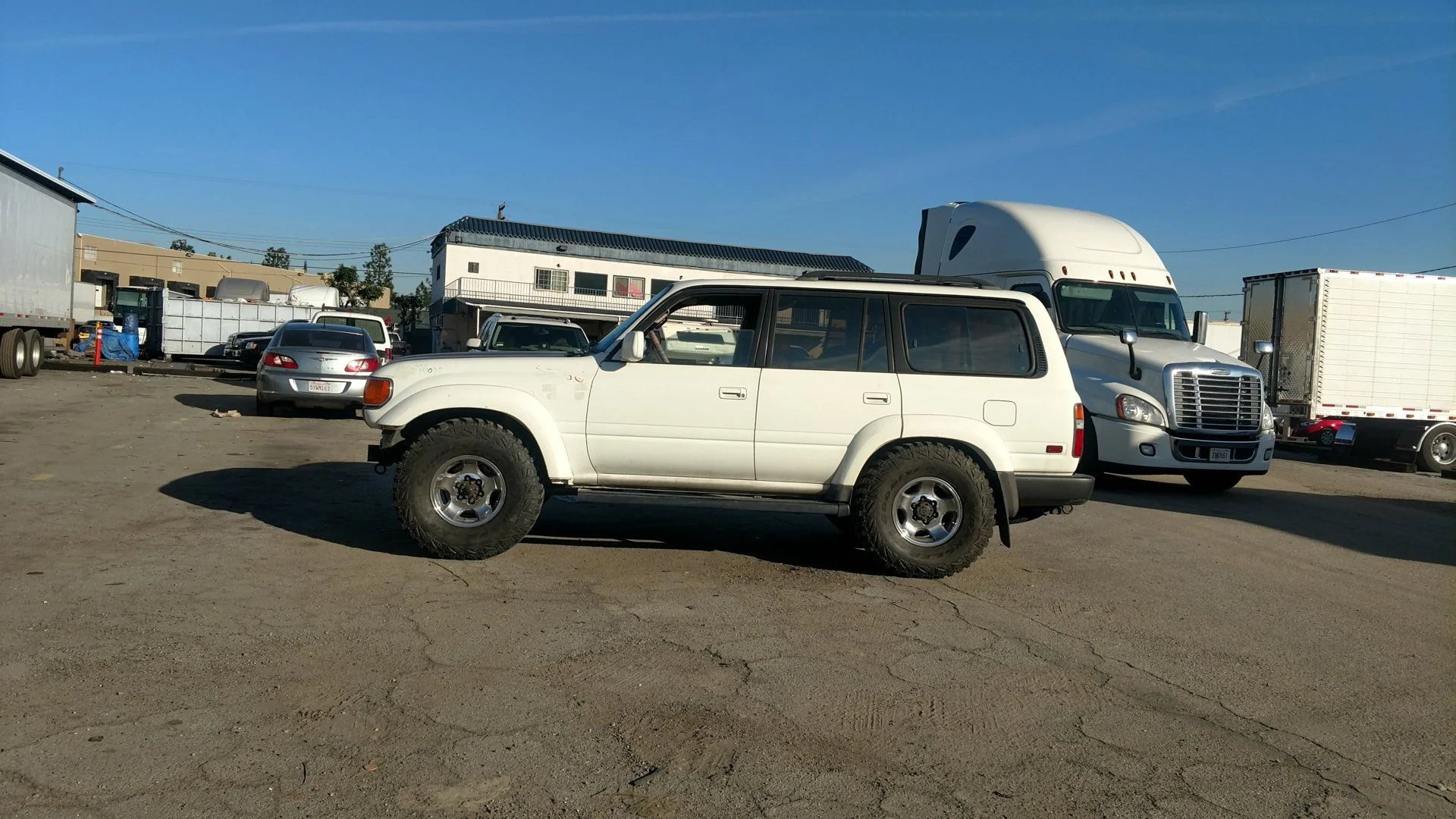

I have a 91 fj80, came with 15in rims. I put 33x10.5 on it and they look great and I can hang with the guys in the trails (center lock & rear ARB locker). But 17 is the new 15. 17in steelies with 35s are the way to go, but need regearing. You need rubber on the sidewall when you air down.

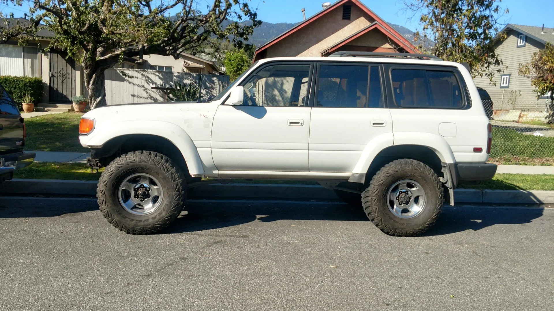

I guess some of us break all of the Mud rules? Mine and most that I wheel with have 37"s and stock axles/birfs, on mine the left knuckle was unmolested till ~200k miles, when the axle seal started leaking. Mine and several others have stock diffs, but have transfer crawler gears, works pretty well on a 1FZ rig.
