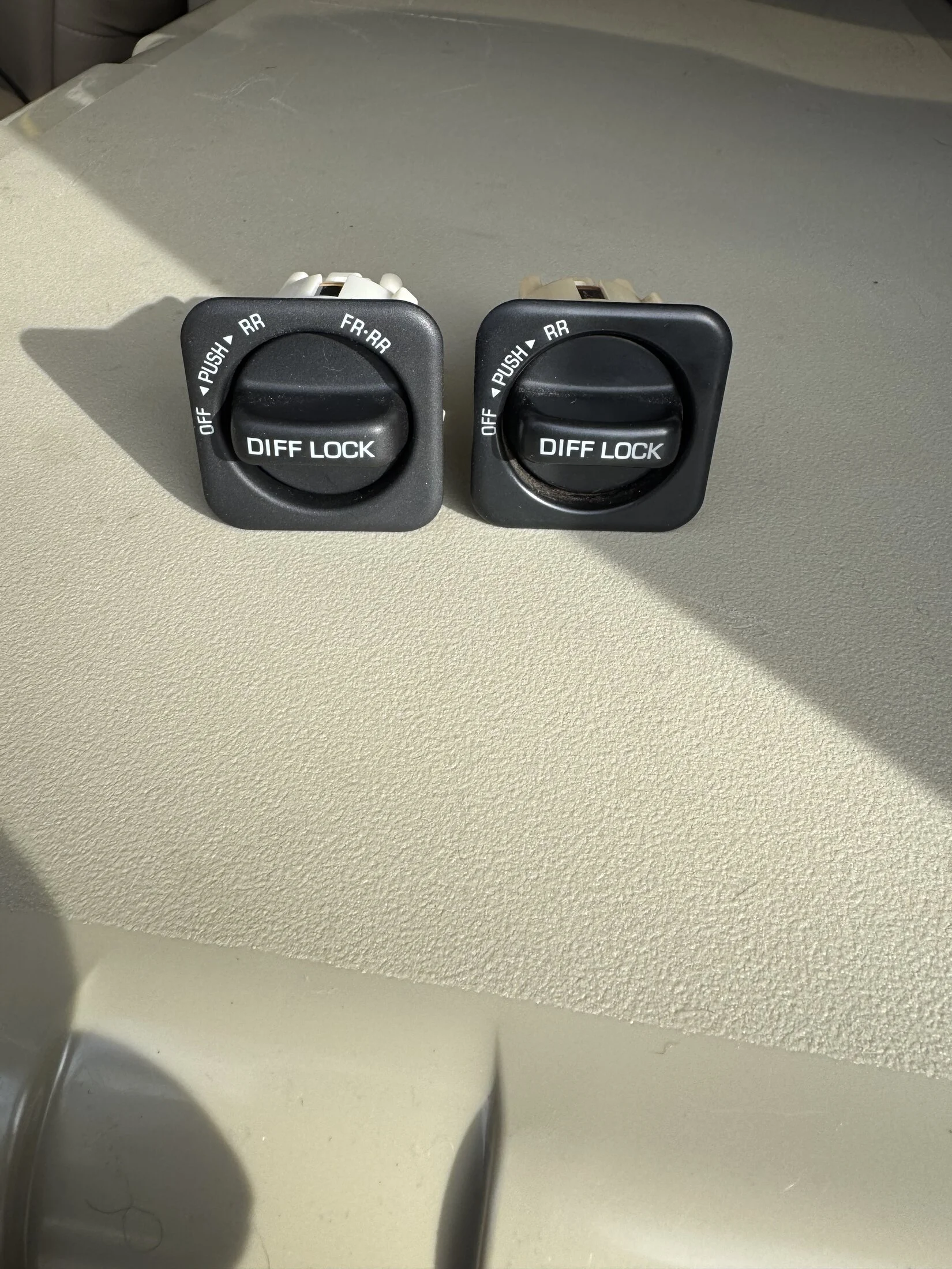

I installed a Harrop front locker and wanted to update the switch to use the 80 series switch for an OEM looking install.
Looking at the 80 series switch I see there is one extra pin (in the middle) compared to the 100 series locker switch.

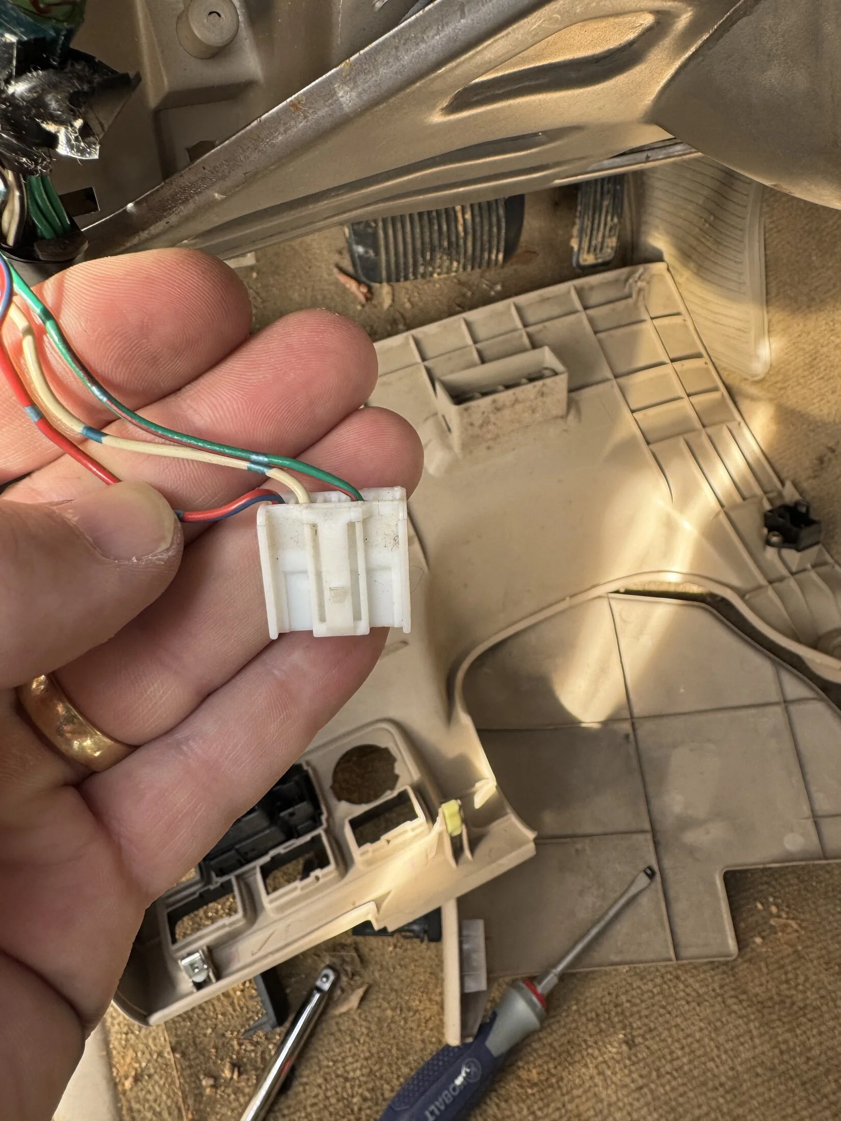

Similarly I see on the harness there is a white and blue wire aligned to the “extra” pin.
I think that I just need to splice the white/blue wire and run that to the relay for the front locker. Does this sound correct?
