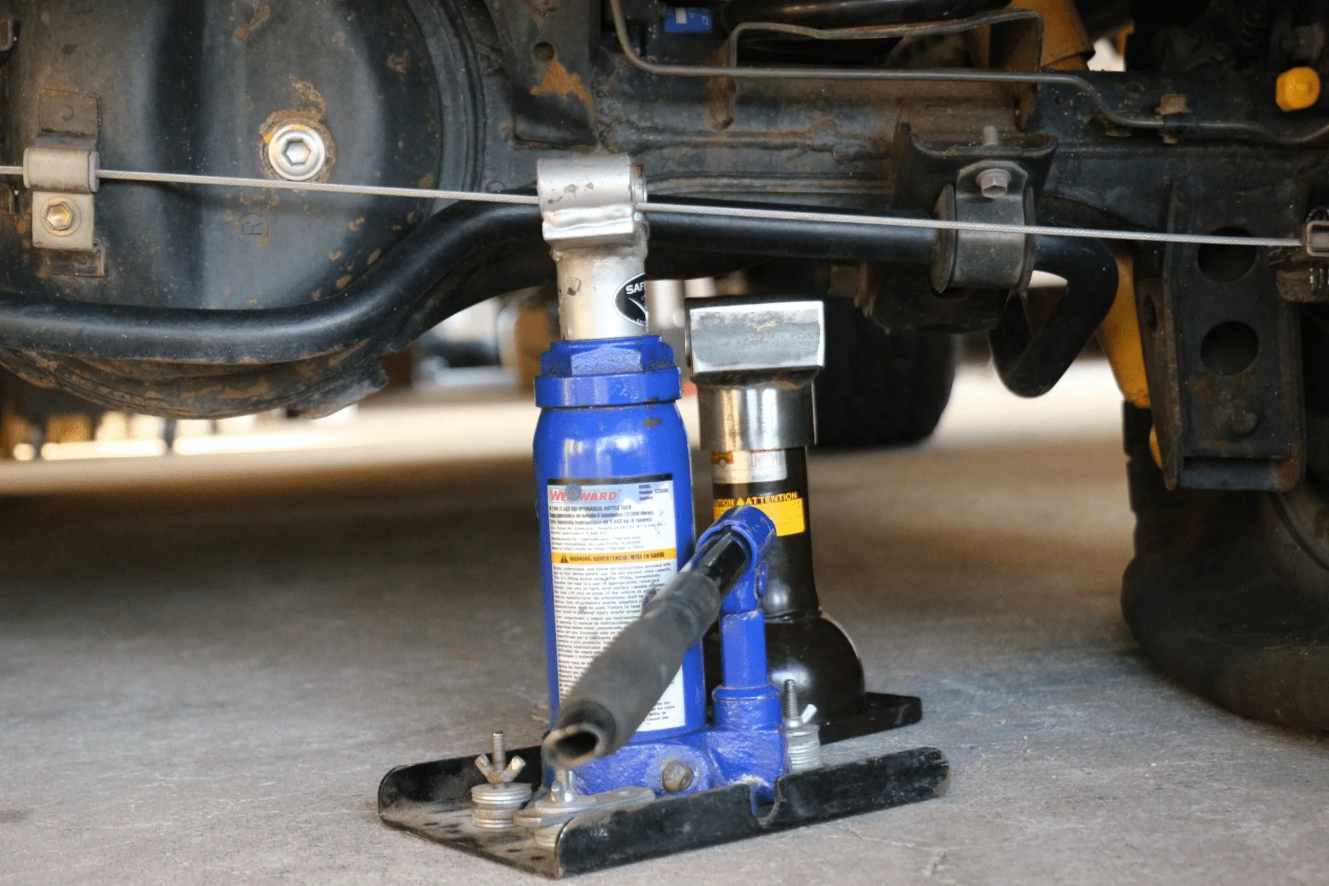

Once it's lifted (however you did it) never ever ever... work on it without something else holding it up (tire, log, stable stack of rocks) and test that support by lowering weight on to it, especially if you intend to get under the vehicle. I carry a home made collapsible jack stand (another product for your suggestion box @LandCruiserPhil ). Maybe you're lucky enough to have one of the collapsible jack stands that @sleeoffroad never made or (forgive me @NLXTACY because I'm not sure I completely understand the joke) you could buy the one that Joey's wife would buy from Safe Jack:
Disclaimer; I've never seen that product but a few hundred dollars might not seem like much when 3 tons of truck is sitting on your chest.
LCP Jack Adapter can change a flat. :p
Phil, now you've got me worried about ever getting a flat on the road with my DD, Ram 5500. Didn't come with a jack so I got a bottle jack / stand combo that I checked would fit and lift it, but that was without a flat tire. Now I see your true genius.
