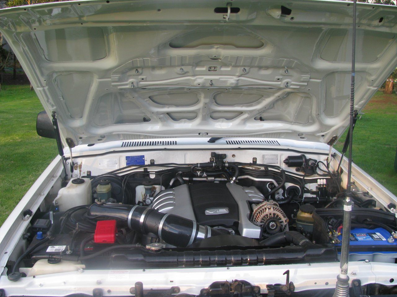

Oct 1, 2014
459
Silvan, Austraila
L98 6.o litre
